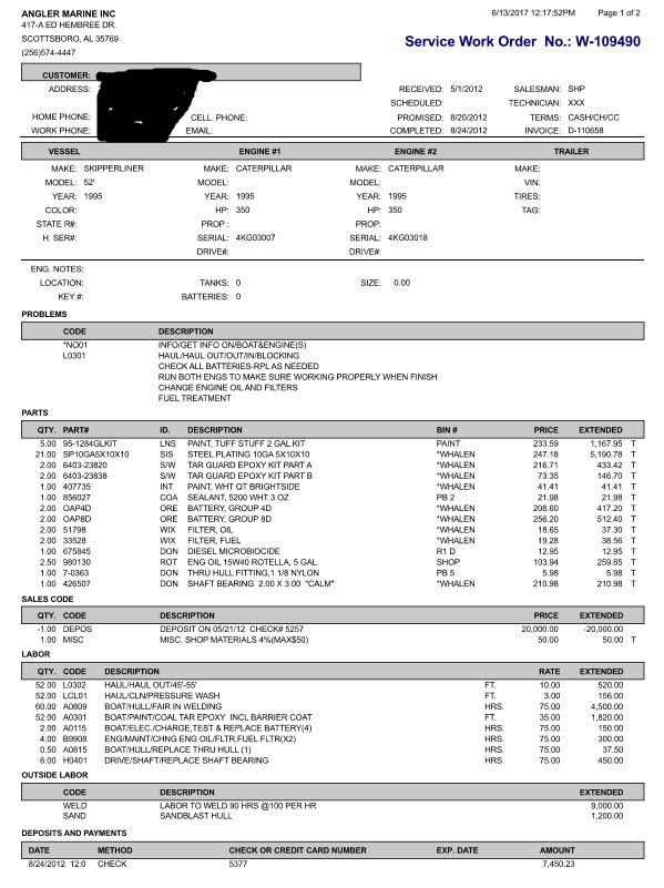

  10. JDJ
    Joined: Aug 2017
    Posts: 6
    Likes: 0, Points: 1
    Location: WILLIAMSPORT, TN
    JDJ Junior Member
    I did get the invoice for the work done in 2012 and maybe you can see something that I do not see.

  12. gonzo
    Joined: Aug 2002
    Posts: 15,198
    Likes: 927, Points: 123, Legacy Rep: 2031
    Location: Milwaukee, WI
    gonzo Senior Member
    It doesn't say if the double plated or re-plated. You could call the shop for more details before the survey.
  13. JDJ
    Joined: Aug 2017
    Posts: 6
    Likes: 0, Points: 1
    JDJ Junior Member
    Thanks. I could not determine that either but will call the shop to see if they can shed some light on what was done before wasting any more time on this boat. Hopefully they are still in business.
