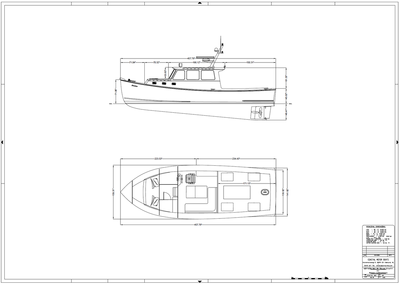

    Are there any advantage or disadvantage to keeping the rudder as close to the bottom of the hull as possible. Or is it better for there to be a gap on top of the rudder?
    Looking for the least drag resistance at higher speeds.
    Example in the picture.

    You need enough clearance for the rudder to be able to swing. Of course, unless it is a flat bottom boat, then it can almost touch.

    Ideally, you want as little if any at all gap, between the hull and rudder top. Of course as Gonzo mentions, hull shape can play a big role in this, but a bustle or pad can be employed to permit the rudder to sweep the bottom at the same distance.

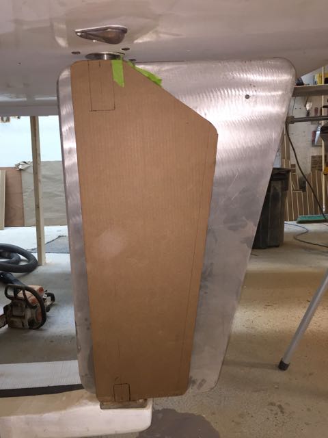

    -The rudder will NOT be like the one in the original picture. It will be smaller and have a slightly different design. (pic below)
    -Speed of this boat is projected to run close to 50 Mph, and we are looking for everything we can get from it.
    -The rudder will be made from 1/2" Plate and about the first 5" (leading edge back 5") will be tapered. The remaining part of the rudder is to be 1/2" with a square edge on the backside.
    If anyone has any suggestions, we are open to hearing them.
    Thanks

    Also a plate is a profile,
    a profile with many disadvantages,
    especially at higher speeds.
    the geometrie of your rudder (" will be made") is, apart from the balance, not really important.

    The angle fairing over the stock (& pintle) will reduce the rudder's effectiveness by about 50% at low rudder angles.

    Now some really pertinent facts show up. I guess the OP is planing on entering the lobsterboat races along with the other wild and wooly crazies. 1200hp can cure a lot of drag issues and control becomes the main determining factor of success. An effective rudder is near the top of the list of necessaries for these events. Those hulls were never meant to go that fast and handling is probably a bit hairy.
    What the flow looks like behind that keel at 50mph is an interesting thing to consider. A rudder with some foil shape will probably be better than a flat plate even with disturbed flow. PAR suggests a wedge which may be good since it would be more effective than a nice foil at larger angles of steering and probably better in disturbed flow. There are several forms of a wedge with the simplest being a bit of of fan out on the trailing edge which gives more positive control at small steering angles, or that is what I have read.

    An efficient rudder is one that will steer at all speeds. Faired blades work well at low speed but cavitate and lose control at higher speeds. That is why high speed boats have wedge shaped rudders. Drag is of secondary importance. Fairing the keel is of more importance as far as resistance is concerned.

    Agreed, the rudder's efficiency, behind that built down hull is marginal at best, regardless of plan form and to a lesser extent it's section. At 50 MPH, the wedge will start to rear it's head, but with these flow numbers, you'll still need a bit more speed to possibly justify the wedge. Simply put, a good foil section on the same plan form will likely be on the edge of cavitating, while the wedge will just be coming effective.
    Considering the presumed lobsterboat races (that was my guess too Tom), the wedge will likely prove ever so slightly superior, mostly because of it's "bite" at these higher speeds. Everyone I know that designs these puppies, has a specific set of angles they'll employ, based on several factors. For a "good" one, it'll be like pulling teeth getting much more than some generalities and certainly no firm shapes and angles, without some serious study on your project (read lots of questions from a designer).
    The likelyhood you'll "wing it" and get a good one is remote, but if you want to give it shot, a 4 degree sweep on the wedge is the usual starting point, on a square tipped delta plan.
