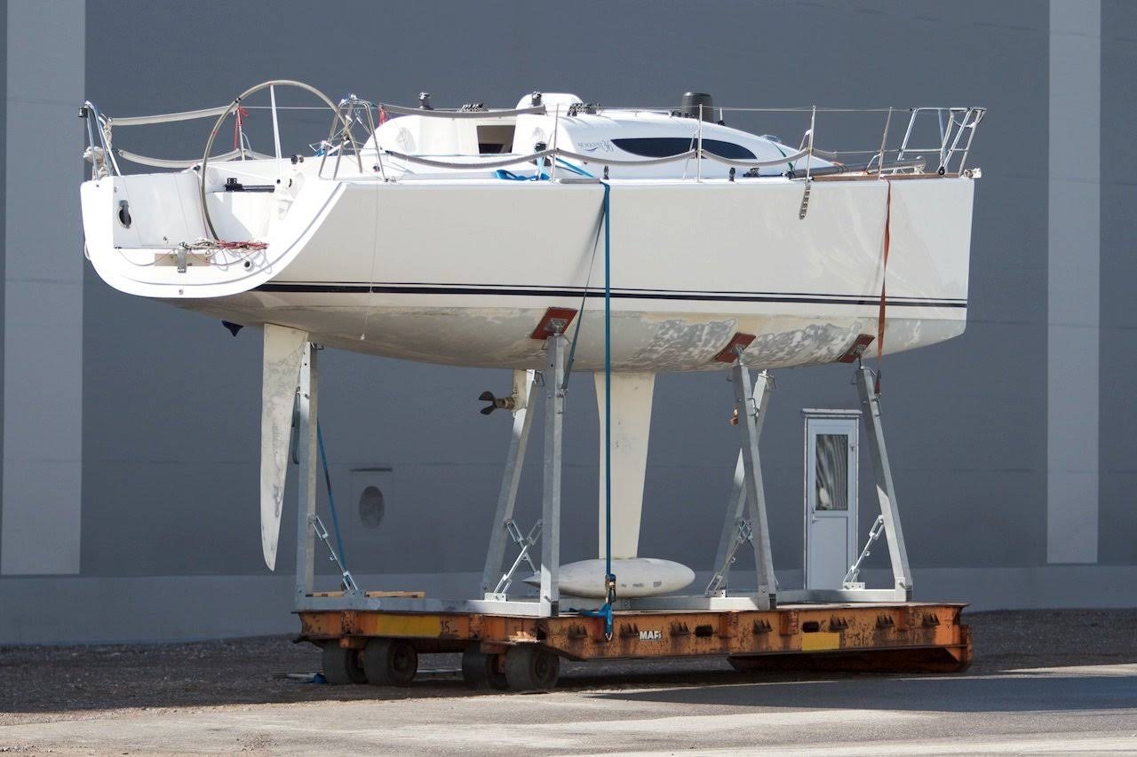

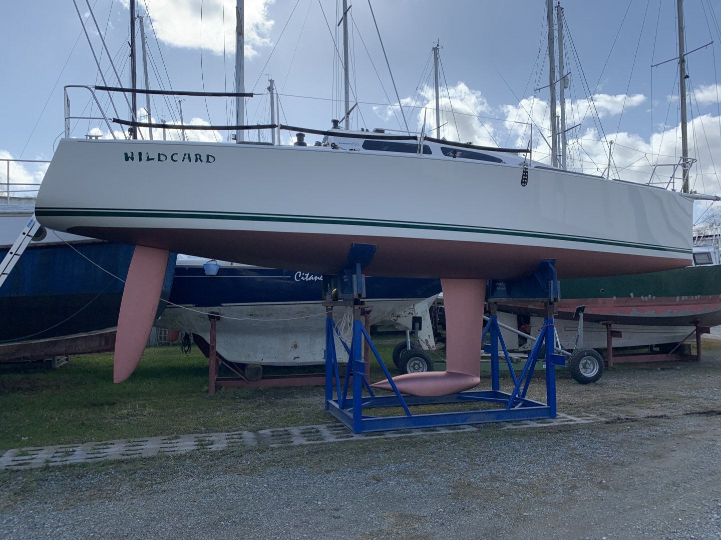

    The original rudder of the boat was very narrow. I have attached a pic of this rudder (it's from a another Seaquest, but mine had the same rudder originally). The preowner said that this blade was to narrow, not giving enough control. So he had a different rudder mounted, with a bigger blade. I have a pic of this current rudder attached, too. The pre-balance is 18% according to Jefa. This is a standard racing rudder from Jefa, it is their 35R-profile, this one: The pre-balance is 18% according to Jefa.
    https://jefa.com/ftp/rudder/rudder_blade/RUD35R.PDF
    With this rudder, she is relatively difficult to steer, I mean, it takes a lot of strength to move the tiller, there seems to be quite some pressure on the blade. It's not the sail trim or rudder pressure from the sails, because it is the same when under engine. When at rest in the berth, the rudder can be moved easily. But as soon as she moves and gets up to speed, the rudder is hard to turn. Steering "with two fingers on the tiller extension" is not possible when underway. The previous owner told me it has always been like that with the 35R-rudder.
    The rudder bearings are good, I have checked them this winter. They are JP3-bearings, a normal bearing at the top and the lower one is a roller bearing.
    I would like to hear your thoughts on this problem - is there any possibility of making the steering easier? I wanted to install a Raymarine Evo-tiller pilot, but I think it would not be able to handle the force neeeded to steer. And I would like to steer her with "two fingers on the tiller", as I was used to with tiller steered boats...

    So the rudder stock is angled, correct? Wheel or tiller (I assume the latter given you comments)? Any sign of wear against the hull or inside the rudder tube?

    Yes, tiller steering. And correct, the rudder stock is angled. I have a drawing of the original rudder blade and the rudder installation, there you can see the angle:
    https://teamswashbuckler.files.wordpress.com/2020/04/rudder-original.pdf
    The rudder stock was good, no signs of wear there or against the hull.

    There is a reason you rake the shaft and a reason to sweep the blade, but I think this has gotten too far off the mark having both. Realistically, as long as the rudder stock is not bending or binding, to reduce rudder torque you are going to have to get a new blade with the shaft axis closer to the center of pressure (not area, not sure what the center mark is on the drawing).

    I think that jehardiman is effectively suggesting that you need more side profile area forward of the rudder stock, to improve the balance.
    I am wondering if it would be possible to experiment with adding a 'nose cone' (for want of a better term) to the rudder - shape it out of foam, glue it on (with glue that can be 'undone' again if you want to make further changes) and fair it reasonably smooth, and then test it under way with the engine?
    You shouldn't have to test it drastically, eg by turning it hard over at maximum hull speed - just turning it maybe 10 degrees while motoring at two or three knots should tell you if it is an improvement or not?
    If it is not an improvement, then maybe add a bit more?

    The center of pressure (CP) is the point on the foil centerline where the force on the foil is resolved into a single vector, i.e. if you were to restrain the foil at the center of pressure there would be no moment. The problem is that the center of pressure moves with the angle of attack, generally moving "forward" as angle of attack increases. In testing foils are generally constrained at the 1/4 cord point, that is 25% of the cord back from the leading edge, and the moment about the point is measured to determine the center of pressure for the angle of attack. In the case of the RUD35R shape, the sweep of the foil causes the summation of the CP to be significantly aft of the shaft axis. Moving the shaft axis aft closer to the CP would reduce the torque needed to rotate the blade. A well designed relationship between CP and shaft axis should have the maximum moment to turn the rudder at 0 degrees, decreasing until at some high (30+) angle of attack, the CP goes forward of the shaft axis. However, with your install not only is the CP well aft, the shaft itself is raked. Generally raking the shaft increases tiller torque by reducing the effective length of the tiller.

    Thanks for the explanation. Do I understand you correct - more rudder blade area forward could help? The same as bajansailor proposed? That would effectively increase the pre-balance of the rudder (18% as of now), right?

    More area ahead of the shaft is the obvious physical manifestation of moving the shaft axis aft towards the CP, but that may not be the answer in this case. As well as determining shaft torque, the CP (this time the distance from the CP to the shaft bearing) also determines the location of the force that produces rudder shaft bending moment in spade rudders like yours. In this case, adding area to the existing rudder will increase the shaft bending moment, how much and if that is acceptable on the shaft and bearings would need a detailed analysis.
    <edit to add the CP dimension that matters to the shaft bending problem>
