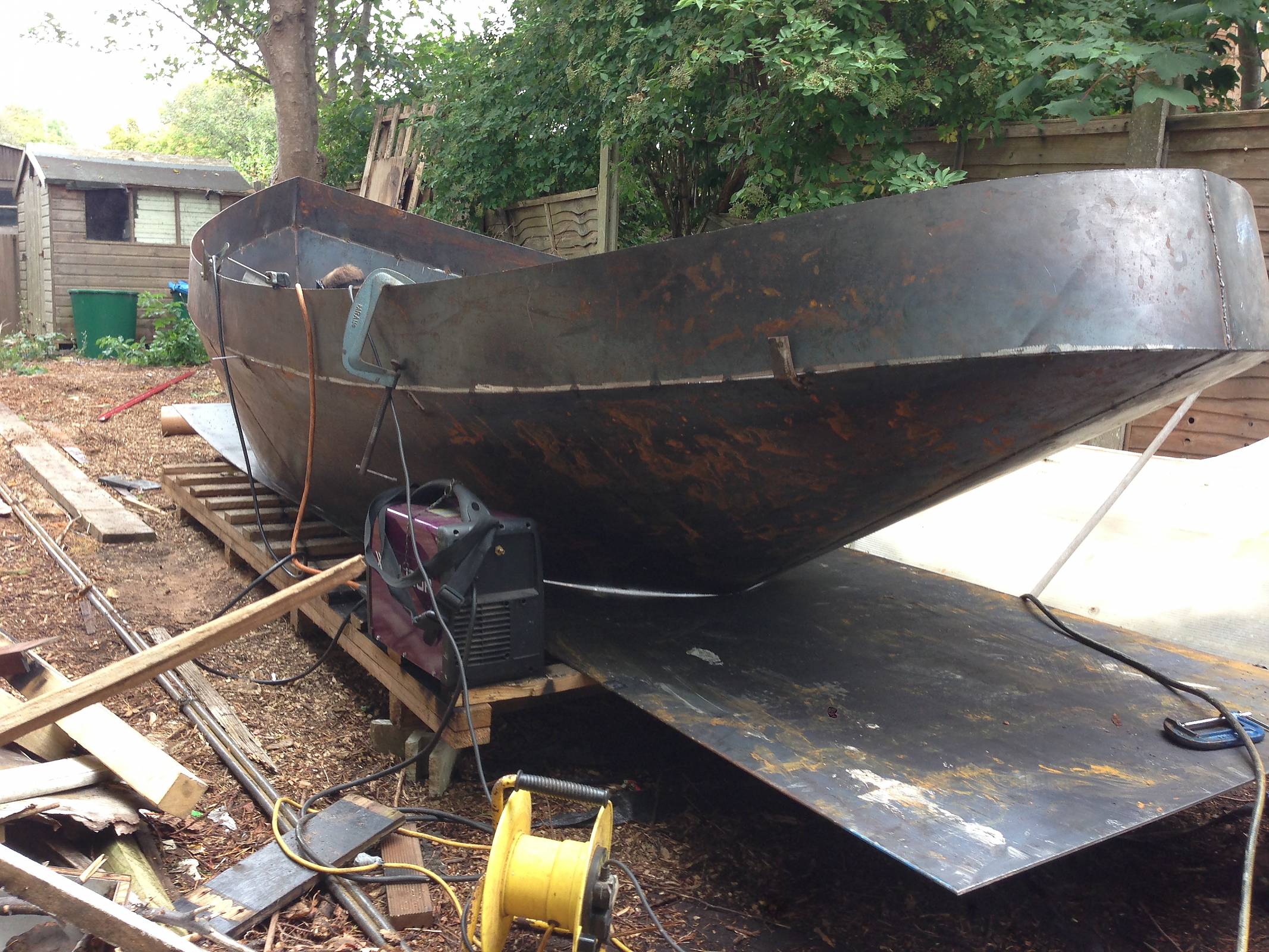

    I am in the process of building a small 5 meter steel workboat and require some help on sizing my rudder.
    How do I work out the surface area of the rudder needed for my boat and how do I work out the best placement of it with relation to the prop?

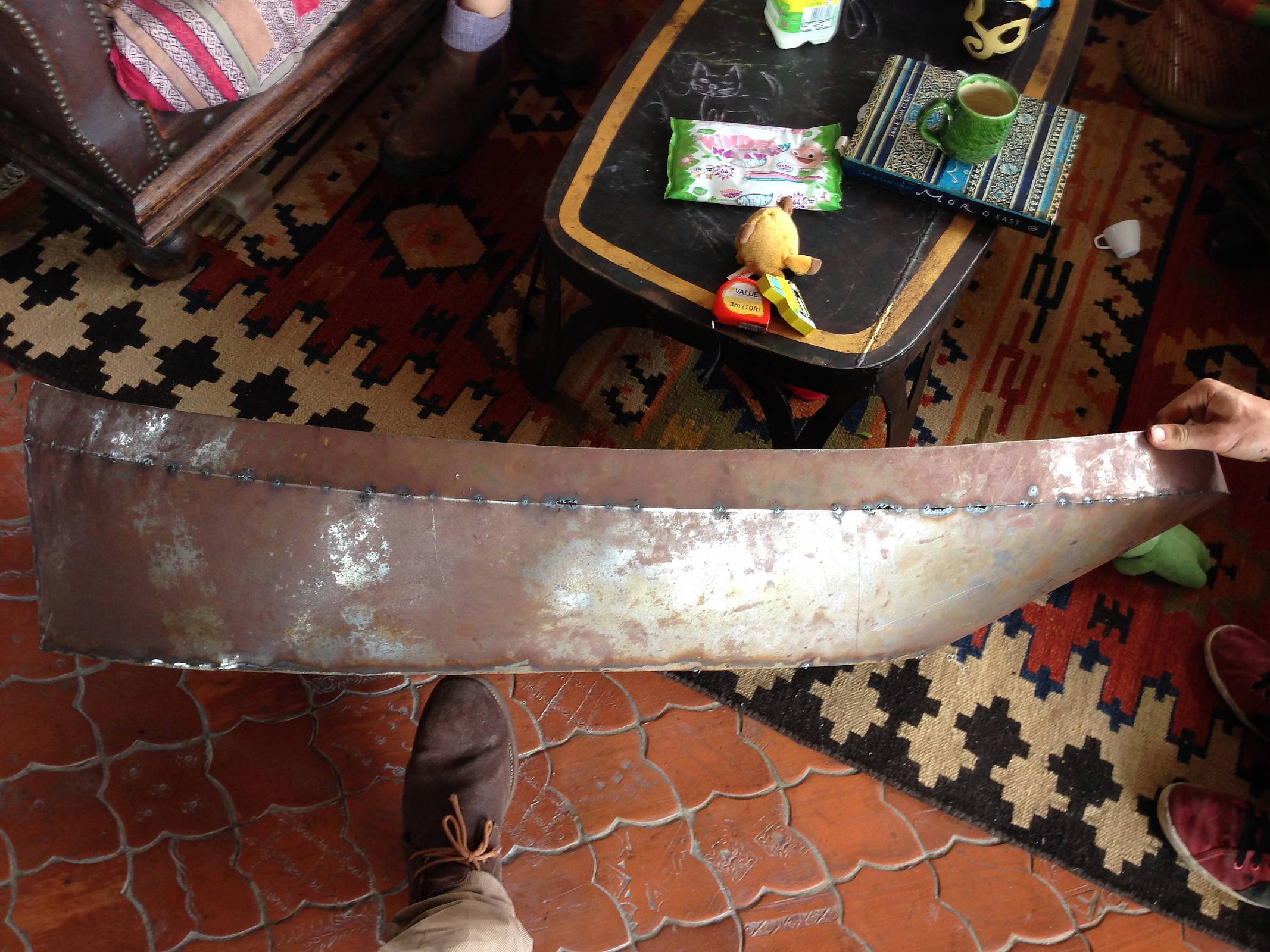

    I have attached a rough sketch of what I hope the rudder to look like I was thinking, as "PAR" suggests, to make it as big as practicable, however I was going to put in some balancing so tiller work is not arduous! The prop shaft angle is estimated as I need to get the boat and engine in the water to trim the boat.
    Some numbers
    Waterline Length 4350mm
    Waterline Beam 1575mm
    Draft 300mm (ish)
    Displacement around 750KG
    Looking at an 11" prop
    20 HP @ 2300RPM from Lister ST2
    Displacement speed for the boat is around 5.5 knots however I was hoping to get around 7-8 out of her as she is quite streamlined.
    I have also attached a few photos so you can get an idea of the boat, if anyone can see any glaring errors with my sketch please let me know
    Cheers Rob

    gee Rob, yes that is a pretty boat, congrats
    Sorry for the arguing in this thread, it does appear that people want to post for the sakes of it, in this respect I have to agree with Ad Hoc
    My fancy rudder was as much for others as you
    Flat plate will be ok with some balance
    if you have a dfx read capability I,ll do a dwg,
    That boat is so nice, I think you need it to not be transom hung but up through bottom with a heavy wall tube and simple brgs and simple O ring seal at top with engineering plastic thrust plate
    The is a steel called valuric hollow bar, which is ideal for stern and rudder tubes(maybe valeric)
    by the way, you cannot ever get that speed
    ever:)) unless you plow the water with huge motor, or make her plane remember speed of a disp craft, sq root waterline x 1.3 approx

    Agreed, she's not "streamlined" well enough, though I'll suspect some pretty WL's, she just has way too much volume to move, to get the 7-8 knots you desire.
    It looks like you're going to put some type of fairing above the prop. I'd recommend you skip this, as the tip clearance will be too tight.
    Place the shaft on a strut if you mist and make the rudder top as close as practical to the hull bottom, but other wise, don't fill the aperture any more then you need to. Lastly stay shy on the amount of balance, say 10% or less. Your rough drawing shows over 20% and with the prop that close, you might find steering troublesome. You can always add more if you think it's necessary, though solid steering gear can ease helm pressure, which shouldn't be excessive with the speeds and hull form you've chosen. I'd like to see some lines on this hull, can you post them?
