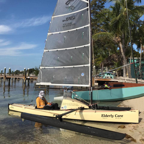

    Based on your existing fleet, I would go with a narrow, light, sail, covered canoe/tri. Meade Gougeon built the ultimate example and sailed it solo several years in the Everglades Challenge -the last time he was 79. B&BY built a more pedestrian stich and glue version with input from Meade. They never followed up with selling a design or kit, but he did film most of his Florida Challenge. Take a look at the videos and see how easily he covers distance. They don't look brilliant, but pound for pound they provide the fastest average speed with the greatest ease, safety, and versatility.
    -I am disregarding your 'row' requirement for the moment with the intention of comparing all the human propulsion methods -double paddle, single paddle, peddle prop, peddle flipper...
    -This doesn't have a good side by side sleep aboard option -it does have a good head to head sleep aboard. I am no expert on bears but a bit of water is not a defense I could sleep on.
    -I am interpreting "fast" as averaging 7knots easily sailing and 4knots easy (heart rate ~120) under one human power carrying two humans total weight through 90% of conditions.
    Canoes - Expedition Sailing Canoe - B&B Yacht Designs (bandbyachtdesigns.com)
    wayne nicol and Tiny Turnip like this.

    ok , so based on this design as a kicking off point.
    1.would it be feasible to extend the main hull enough, keeping the amas, same sixe and position so that two rowers could operated aft of the amas
    2.i could see the fore cuddy as the main cuddy, storage
    3.the dog house would be smaller in volume with the majority of the legroom extending under the self bailing floor of the cockpit- that may need a wee bit more beam aft- maybe some kind of a wineglass type transom, just affording a wee bit more than squeeze room.
    4.maybe if the companion way slider is also a small pop-top just to give some headroom for food prep etc.
    knowing full well that these accommodations are not going to be grand or luxurious, but spartan , barely comfortable and simply useable.
    many thanks

    The only way I can think of to do something like this would be to keep the amas as shown and give the forward rower some extremely short oars, like, four feet or so. I don't think it'd be a good idea to just have really short amas at the very end of the boat.
    If I were doing this, I'd make the amas longer and center them lengthwise and use kayak paddles. The paddles can be stored on deck or clipped/bungeed to the gunnel so they're out of the way, and weigh less than anything else you could propel this boat with, even counting at least one spare. Plus, you get to see where you're going instead of having to look over your shoulder all the time.
    wayne nicol likes this.
