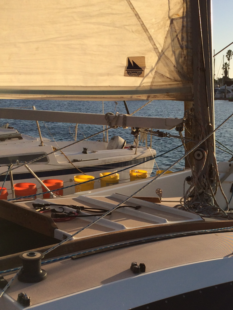

    I’m trying to sort out the rigging of my rotating mast on my Trimaran. Unlike my last Trimaran, this one didn’t come with an owners manual. I can only go by photos I took when it was rigged by the last owner, and various photos of it dating back to its launch.
    Looking at old photos from previous owners (grainy and hard to make out) and newer from the last, I suspect there may be more to the system than perhaps the last few owners realized.
    See photos above for reference.
    The last few owners had the “spanner” attached to the boom only, but looking at older photos it looks as though the spanner was designed to handle rotation control of the mast, with a double 2:1 purchase running from the end of the spanner (behind mast) out and forward to a pair of pad eyes either side in front of the mast, with control lines then running aft to the cockpit which makes sense to me as a way to lock or induce rotation.
    Looking at photos of other setups, I have found examples where the spanner is only connected to the boom (usually lower with more
    pulling angle), others where the spanner is mounted to the mast closer to the deck and only rigged to the deck to control mast rotation, and then others that are connected both to the boom and to the deck to control the both boom and the mast.
    Based on the hardware mounted to the boom and to my deck, I believe the spanner was designed to attach to both.
    What’s strange when comparing photos of other setups, is that the spanner is mounted kind of high up to allow for a good pulling angle on the boom, and pretty high up off the deck compared to examples where the spanner is used to control the mast only.
    Also, since the spanner is bolted to the mast at a single pivot point either side, I would think when connected to the boom and the deck that the spanner would want to pivot and change angle. Perhaps that is what it is supposed to do? However if it pivoted downward too much, I believe it might interfere with the winches, and there is evidence of that in the close up photo of the mast off the boat. If you look closely, you can see evidence that the spanner has contacted the welded on winch mounting pad on the mast, leading me to be,I’ve that at some point it was rigged down to the deck.
    In the last two photos above, the blue lines and circles show where I believe the rotation control lines would have been attached. The pad eyes are well anchored and forward of the mast and far enough apart to allow for a perpendicular mast angle.
    I do know the previous owner broke the old spanner and had to have a new one made. He was only connecting it to the boom.
    Comparing photos, I can see that the new one was built to match the old and mounts in the same spot.
    Is the only purpose for the boom connection to act as a “fence” to keep the boom from swinging back and forth, and not as a way to control the boom with regard to vertical movement? If that’s the case, then I guess the angle of the purchase isn’t that important.
    This is my first boat bigger than a beach cat with a rotating mast, and I can see a reason for the spanner providing both functions, but I’m just not sure how it should be setup.
    Can anyone speak to how setups like this are supposed to work and be rigged? This boat was built and rigged in the early 90’s.

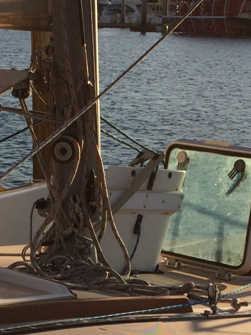

    Also while we are on the subject of rigging systems, check out this interesting contraption/system designed and fabricated by a previous owner somewhere along the line. I understand what it was designed to do, but am not sure why someone felt it was needed.
    Please refer to the two photos above for reference.
    Basically it is a hinged lever that is mounted to the deck behind the center board case with a hinge that pivots and pulls the board up the case to retract it to hull surface level by way of a control line led aft to the cockpit. This particular board deploys deep into the case, and this lever and line system works like a crane boom with a hoist at the end in that when the line is pulled, the board is lifted by the line using the sheaves mounted at the end of the lever as a pulling point, then when the board comes up to the surface of the deck, and all the free line has been pulled, the board and the lever become one and the final few feet of board are pulled up above deck level as the lever itself pivots as it is pulled up and back.
    It’s a really interesting design, and someone clearly put a lot of thought into it, however unfortunately it was not well fabricated and would need to be remade out of better/stronger materials which I may do if I can figure out the reason/advantage of having it in the first place.
    Originally the uphaul of the daggerboard would have been a traditional system consisting of a sheave mounted up and off the front of the mast aways.
    My one thought was perhaps this system was designed as a way to keep the board low and eliminate the original control line position in an effort to keep the area clear for tacking headsails, especially larger ones, since the control line can be kept much lower using the lever system.

    My small contribution is to add a short Dyneema from the rotator end up to the gooseneck to hinder it from moving down(thin red line).
    Nothing wrong with the mast-boom system, as long as you have the mainsheet at an angle so that it pushes the boom forward when sheeting.
    In lighter wind a system that forces the mast to rotate with a pair of lines sideways/forward will surely work.
    If the rotator could be moved back from the diamond fitting to the widest part of the mast and the boom fittings moved more to rear on the boom, I think the rotator system might work better.
    As I am only used to smaller rigs below 25 sqm, I am not sure it my ideas work on larger?

    Solgato - The extra line that Lars sugests should hold your mast spanner up and if that gives you the right mast rotation I would say that's all you need. However, I find that the rotating mast on our Farrier F32 trimaran does not rotate as far as I think it should do without some additional forcing of the rotation. To that end our F32, in common with many other Farrier trimarans, has a mast spanner that folds up to allow the mast to be lowered but otherwise sits just above the deck behind the mast and two tackles with tails led back to the cockpit act on this to force the mast to rotate. I could get a picture of the arrangement next time I visit the boat. I would say that I am thinking about altering the tackles that control the mast rotation on our boat to give even more purchase. I would also say that if you have a system like this it is easy to forget to change the mast rotation as you make a tack. If you do forget you will be sailing with the mast rotated the wrong way and that noticably slows the boat down - perhaps an indication that rotating masts really are a benefit. A rotating mast also makes it easier to hoist the mainsail without being closely head to wind. Whats not to like.

    Thank you a John and Lars for your input and suggestions.
    Lars -(please refer to photos above) To answer your questions, the daggerboard is about 7’ long and drafts about 4.5’ when locked in the down position with about 2.5’ remaining in the case which puts the top of the board about 2.5’ down into the case from deck level. The case is very strong on this boat as it is tied into the forward main bulkhead which also ties into the sockets for the plug in beam arms. The rotator/spanner bracket is already mounted at the widest section of the mast profile but the photo may not have conveyed this.
    I have not yet sailed the boat.
    One of the only things I didn’t like about the daggerboard setup was that the downhaul was routed inside the cabin along side the daggerboard case. This meant that the control line had to run through the cabin across the seating area and out the companionway, then coiled up and stowed when not in use.
    Originally the line terminated outside one side of the case, passed through the wall, then ran up one side of the board through the boards built in block, then down the other side, through the other case wall side, up a glassed in drain/catch, then through a turn block and cam cleat mounted on the bulkhead and back to the cockpit.
    I changed the line routing as it exits the case so that it is led up a PVC tube along side the case to the deck surface where I mounted a turn block on the surface just outside the center of the slot where the downhaul control line turns out to the T-track where it can be routed back to the cockpit. The bottom of the PVC tube fits inside the old drain/catch, so any water entering from the deck surface or wicking down the line drains down the tube and into the case.
    Per your suggestion, I will plan to add a connection above and between the rotator/spanner and the mast to prevent it from rotating downward and it bringing the boom with it when mast rotation is locked or induced.
    John- Thanks for your input and offer. I am familiar with the Farrier setup, so no need to bother with photos. I don’t think I’ll have any problem getting full rotation based on how far out front and spaced apart the pad eyes are located and where I believe based on old grainy photos, the original rotation control lines would have been led. And I hear you on potential for forgetting to unlock the mast. I know some have damaged their sails. Fortunately my mast is a double diamond setup with short swept spreaders. I mention this because I think there may be a greater potential for sail damage with long single spreader setups.
    And just to clarify the different setups I’ve seen, here is a crude drawing of each.
    The first showing just a boom connection, the second showing a separate spanner for the boom and one mounted down low for mast rotation (like John mentioned), and the last is how I suspect the boat was originally setup and rigged, with the spanner connected to both the boom and the deck to perform both tasks.

    Great, the arrangement you have done with the daggerboard, must be the way to go and also very neat. About the rotator you forgot one line;).
