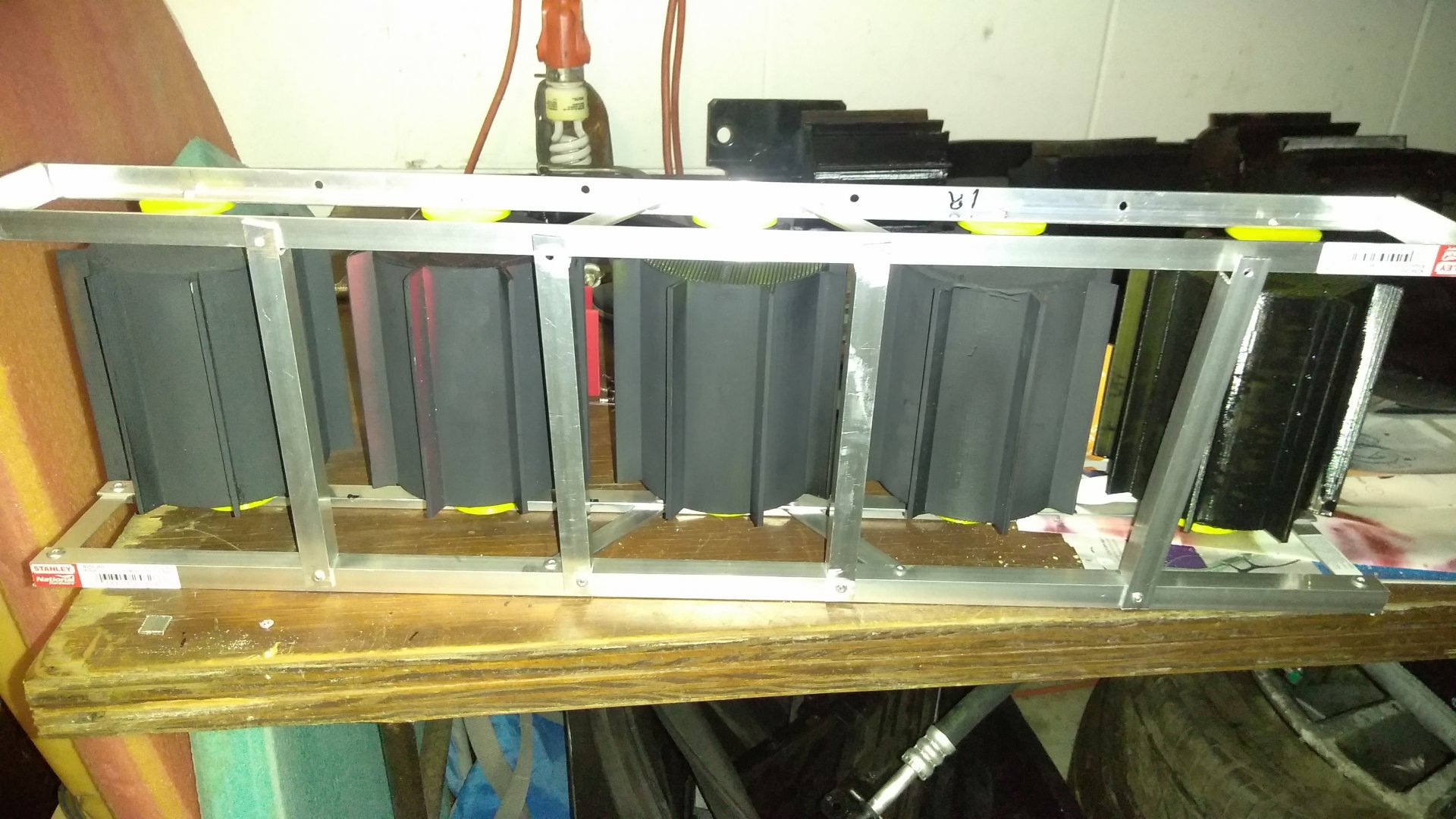

  9. Matthew Lee Towne
    Joined: May 2017
    Posts: 142
    Likes: 1, Points: 18
    Location: Oviedo
    Matthew Lee Towne Senior Member
    Proof of progress. This is a first mock up of frame and trantoons. I'm having some wobble issues. No biggy but slowing me down.
  10. Matthew Lee Towne
    Joined: May 2017
    Posts: 142
    Location: Oviedo
    Ok, you all see that digging a hole is entirely weight dependent right? If the Roller is light enough it will just skip across the water no problem.
    The heavier it gets the harder it will be to get out of the hole. Just like any other boat. I'm sure that heavier loads can be accommodated by simply transferring power to the most effective trantoons. Remember each trantoon is independently powered. So some trantoons will have different rpms to maximize buoayancy while others will focus on traction. While this equation is currently unknown it should be doable.
