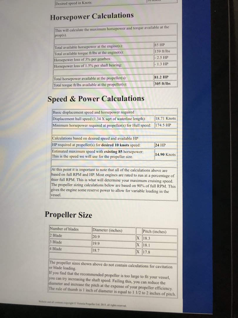

    I’m curious as to how you would do the math for a propeller worksheet on a hull like this.
    Do you add the length/beam/draft of all three hulls?
    I tried it that way, got 18.7 x 17.8 for 4 blades, likely wrong, see below.
    Also does a standard propeller calculator even apply to a long Tail?
    I’ve seem some tailers that appeared to run more as a surface piercing prop than fully submerged.
    I would think complete submersion would be absolutely necessary in this case, for maximum efficiency from low power.

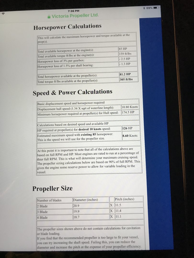

    Ran the numbers through the prop calculator as one hull 9’ wide, came up with some different numbers.
    Now I’m getting prop size of 18.7 x 11.
    The bad is that it will take 126 hp to make 8.6 knots, and 175 hp to top out at hull speed at 18.8.
    So until someone can clarify correct method of how to run the numbers for a multihull vessel, I’ve gotta say it’s both overpropped and underpowered. FB541F9B-BC56-4845-B9AF-F748D4D1459F.jpeg
