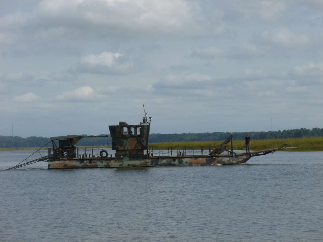

    P1070988[1].jpeg The Sebastian Marie is afloat. Sea trials under way. Christening will be next weekend, then a short voyage up river to home port.

    SamSam Senior Member
    What boat? Just kidding, lame joke.
    It looks very good! Floats level. I like the howitzer. It must be too big and heavy for a travelift type lift, except in pieces. Was it easy to assemble? How'd it work?
  15. rfleet1066
    Joined: Feb 2012
    Posts: 150
    Likes: 11, Points: 18, Legacy Rep: 46
    Location: New Kent, VA USA
    rfleet1066 rfleet1066
    It required disassembly into three large sections, (hulls) , transported on purpose built big *** rollerskates with the Sherriff's Deputies forward and aft going down the State road. It was reassembled 16 miles away at river's edge on skids made from phone poles with carpet attached. The skids were attached to the hulls with nylon straps and ratchets. The carpet was saturated with biodegradable soap. We rolled her into the water until the skids stuck in the mud, then cut loose the straps. Then a gentle push with a track machine and she glided into the water. She was docked that night and the launch site had been cleaned and graded.
