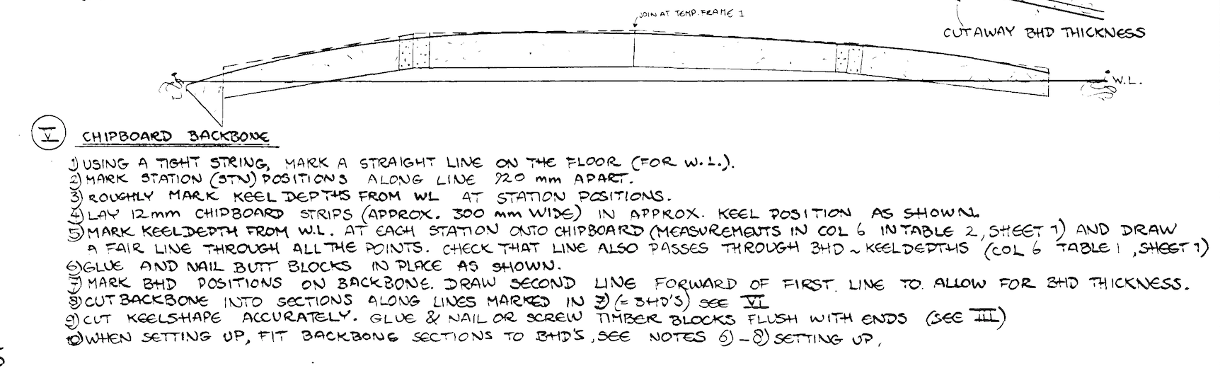

    I'm currently building the 12mm chipboard backbone that goes underneath the keel panel. However I'm having difficulty finding the distance between the stations and bulkheads. In the drawings it says the stations are 920mm apart. I know that bulkhead 1 is very close to station 0 but there's no distance given in the drawings. The drawings only show the distance between the bulkheads themselves and I can't find any distances between the stations and bulkheads. I emailed Richard about a week ago but I haven't heard back most likely he is on a passage somewhere :) do you guys (particularly woods builders) happen to know the distance between the stations and the bulkheads or how to figure it out? I feel like it should be obvious somewhere and I am probably just having a brain fart but I have been wracking my brain for a week now trying to figure it out!

    As for the BH v stations, the way you'd do it is to calculate all the stations at lwl and all the bh at lwl. It should be doable from wothin the plans if you look at two separate drawings. Add up all the station distances and BH distances and see of they are the same.

    The other thing I was wondering was that to join the chipboard strips, the design says to put butt straps but doesn't specify the dimensions or what to do with the gap between the wood. Because the chipboard strips don't fit perfectly next to each other, there is a triangular gap between the two ends that I'm suppose to butt strap. Should I cut out a triangular sliver of chipboard to fill in this gap, or just leave the gap? Also since the plans doesn't specify the exact size of the butt strap, would 150mm be a good size width for the butt strap?

    those margins get covered by blocks the way I read it. I'd make them about 250mm.
    Is this component a permanent part of the boat or jist a mould? If jist a mould, no need for filling the gap.

    Yes I agree, it looks wrong to me too, but I'm following the instructions and drawings to the letter so I can't figure out what exactly is wrong. Even in the drawings, it shows the chipboard backbone butting up to each other at an angle, so there HAS to be a slight triangular gap, right?? It would be simple to just cut out a triangular shaped wedge out of chipboard to fill in the gap- is that what you guys would recommend as well?
    I attached the drawings and instructions to make the chipboard backbone.

    Reread my edited post Ron. I think the gap does not matter because you are only making a jig, no?

    Yes I think you are right, it is only there to give shape to the keel panel I think. I think I'm suppose to remove it after turning the hull over.
