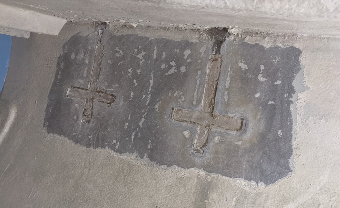

    Now I'm onto the chainplates. The originals (I believe they are original) were stainless steel upside-down 'T's glassed in place on the hull with no mounting hardware. I didn't hesitate to grind them out and start the job of replacing them because 60 year old stainless steel with no oxygen in a salty environment is not ideal. Here's a photo of area after removal: upload_2022-11-19_12-8-29.png

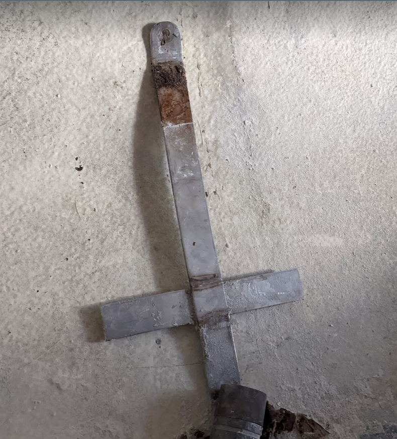

    This is one of the old chainplates:
    So now that I have them out, I'm considering alternate re-installations. Many of the later model O'Day Rhodes 19s have a shorter upside-down 'T' chainplate that is through bolted on either side of the 'T' and the Stuart Rhodes 19s are straight chainplates with 2 through bolts.
    Somebody gave me advice to rebuild them as they are and re-glass over them and that through bolting them through the hull is not a good idea because of the 'high dynamic loads' (did not elaborate). Granted, the originals lasted a long time and would likely outlive me, but it seems to me that if I properly reinforced the hull in the area around the new chainplates and through bolting them (without glassing them in place) would be a better alternative. My thought would be to reinforce the area with 4 alternating layers of unidirectional and biaxial glass followed by through bolting new chainplates (straight) to hull.
    Sorry for the long winded postm but does this sound like a decent idea, or should I stick with the advice I got (and rebuild the same as original)?

    -What size is the vertical bar (l x w x thickness)?
    -Is there a plate and hardware and butyl that seal the holes in the deck?
    I would opt for plasma cut (no welded d0-dads) and polished stainless, same cross sectional area as the current 'tangs', bolted though (3 places?) and back up through the original hole and reseal. Next choice would be full external and seal deck holes.
    Guessing you'd only need 1 layer uni going vertical and the rest could be whatever, prep will be the key.

    The bar is 13 x 1-1/8 x 1/8", the cross piece is same dimensions but 7" wide. No deck plate and the sealant was old electrical tape and failed silicon.

    My choice would be to clean-up the interior along with adding some more glass for reinforcement and cleaning up the deck holes/slots.
    Then bolt the new ones inside the hull.
    Caveat, I would want the new ones out of bronze flat bar, it shouldn't be hard to get in your area.
    You'd be able to work/drill and bend it easily.
    The Rhodes is a classic, exterior bolted-on chainplates, (especially in stainless,) would detract from its clean lines.

    This is pretty much what I was thinking, I wouldn't relocate the chainplates outboard, only the bolt heads. Chainplates would remain inside the hull. I hadn't thought about bronze, but I like the idea. I haven't seen bronze flat bar in < .25" thickness though and the current chainplate slots are 1/8". I'd have to enlarge those, and that might cause another set of issues with forces on the deck.

    One thing about a bit thicker stock is that it will be more resistant to bending.
    If the slot has some clearance, and the part protruding above the deck has been bent to line-up with the wires there should be little pressure on the deck.
