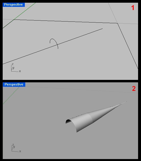

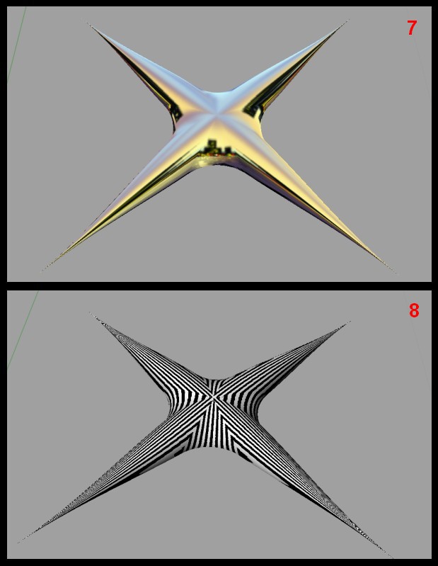

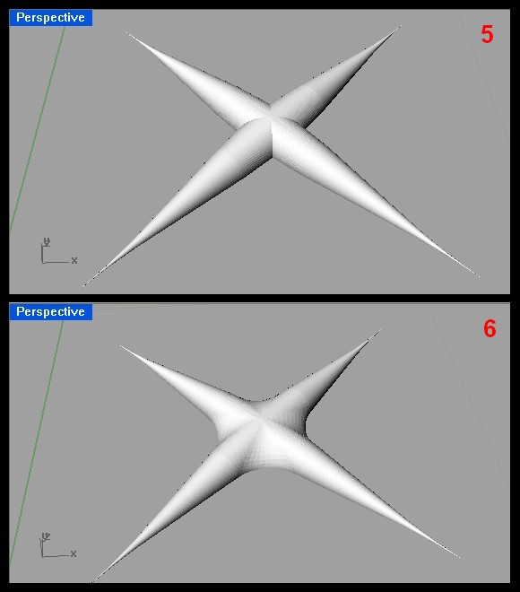

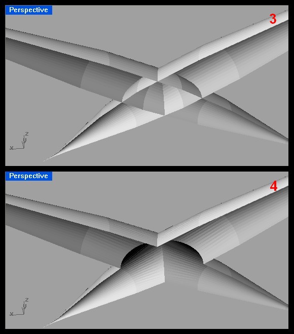

  6. daiquiri
    Joined: May 2004
    Posts: 5,373
    This is how I did the homework:
    • Picture 1 - create the section curve (in my case a half-circle) and a rail perpendicular to it (in my case a line).
    • Picture 2 - create a surface by sweeping the section curve along the rail (I've used the "Sweep 1 Rail" command).
    • Picture 3 - create a polar array of 4 surfaces (Polar Array command); note how they are intersecting on the underside - you have to trim these intersections.
    • Picture 4 - eliminate the protruding parts with the Trim command.
    • Picture 5 - the 4 surfaces are now ready for filleting
    • Picture 6 - use the "Variable Fillet Surfaces" command to smoothly join them along the intersecting edges; you can play with the bottom and top-end radiuses to obtain the result you prefer. I have used R=0.1 at the bottom and R=0.05 at the top.
    • Picture 7 & 8 - as you can see, the surfaces are smoothly blended with each other.
    Hope this will help. Cheers! ;)

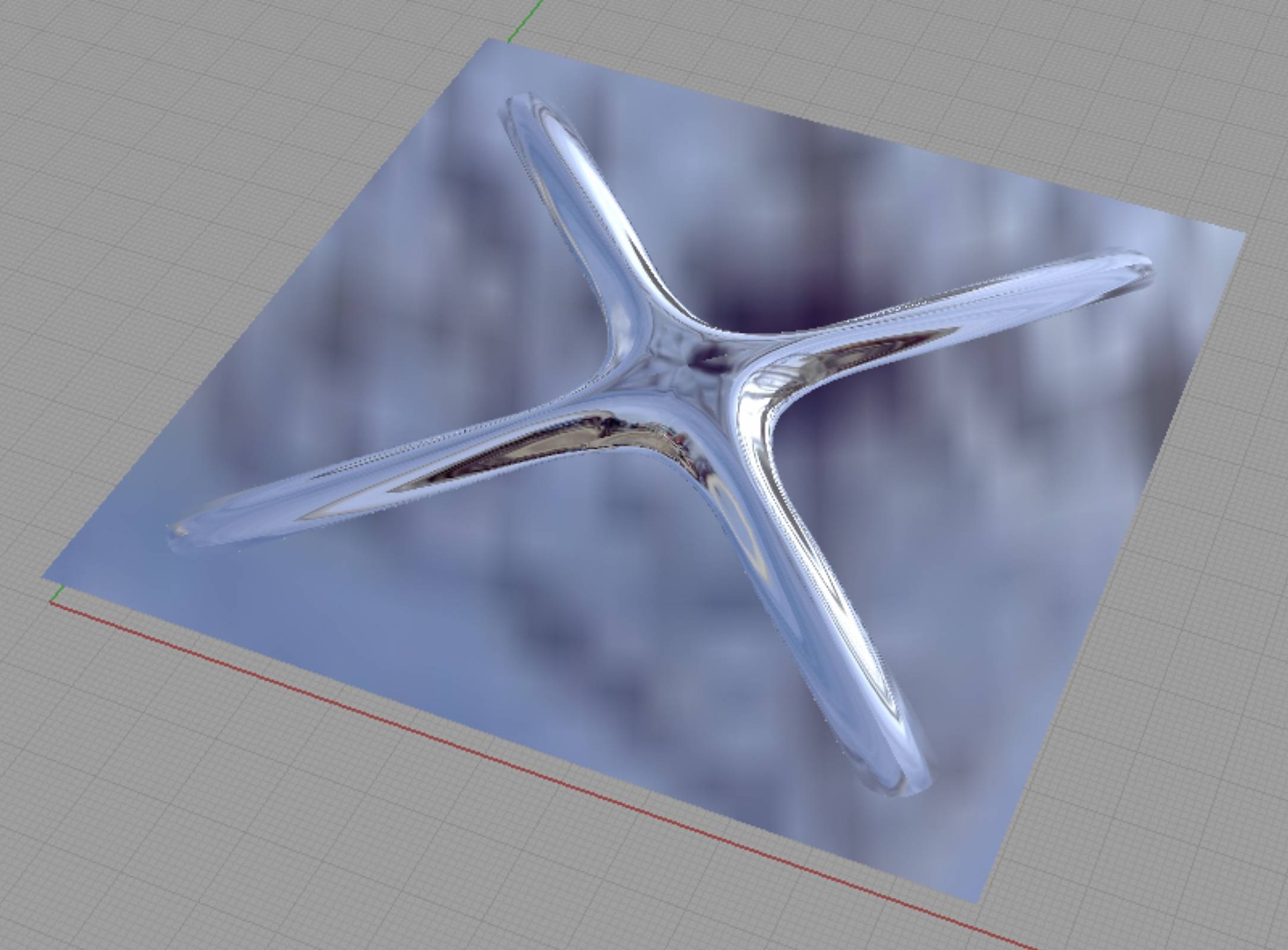

  7. Guinther
    Joined: Jun 2011
    Posts: 6
    Location: Brazil
    Guinther Junior Member
    Thanks daiquiri!
    I have tried this approach as well. Although the result is close to what I need it is still not quite it. The blending is very good, but it becomes more complex when you add one more radius where it blends with the sheet, to give the draping effect. The top also needs to be smoother, meaning that the blending between the 'legs' needs to go until the top.
    I made some improvements on how it should look. It still needs some changes, but I am going to build a small scale mold this week, based on this last file, to see how the CNC will read all the small imperfections.
    Thanks for the reply.
    Regards,
    Guinther
