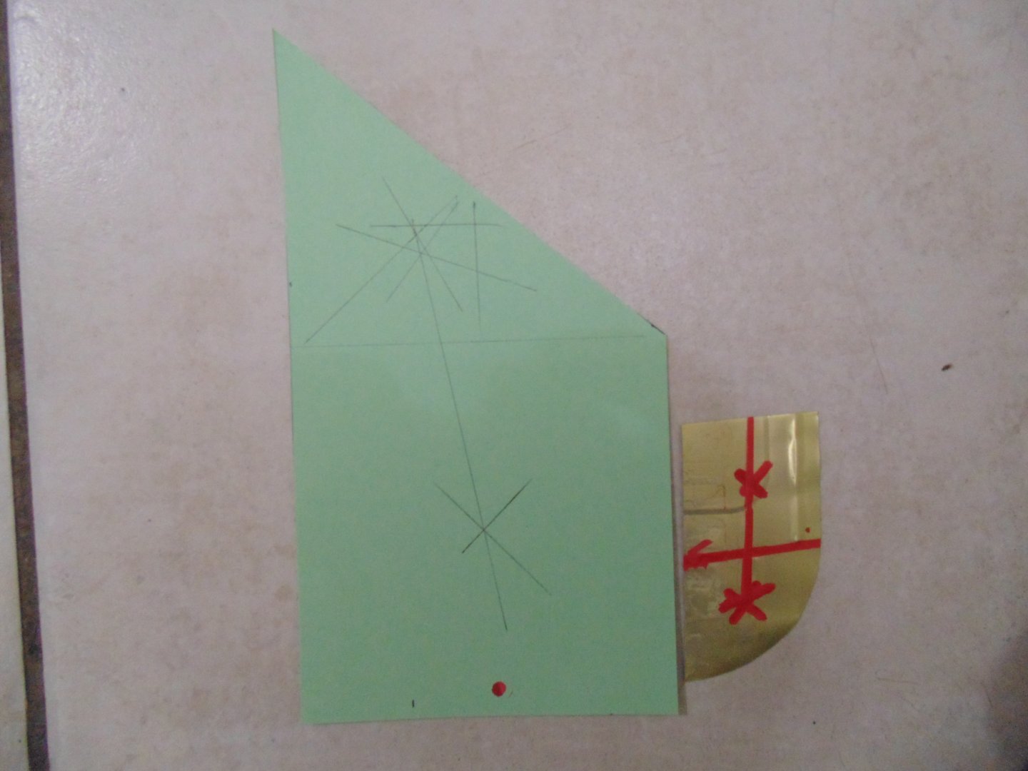

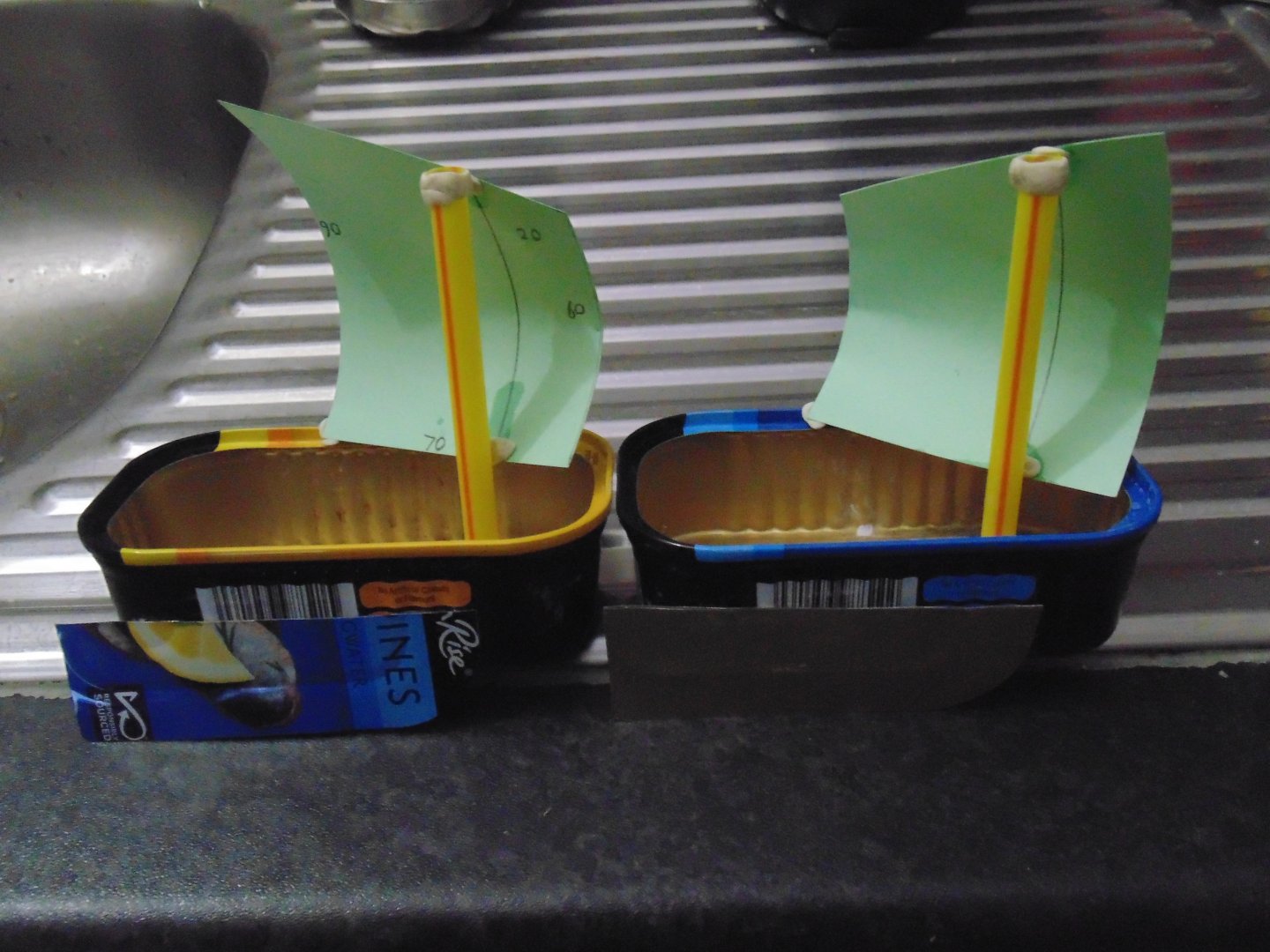

    "it is to act almost as a centreboard"
    Yes
    This is seen in traditional boats: the rudder wants to be a daggerboard
    "Dorna"
