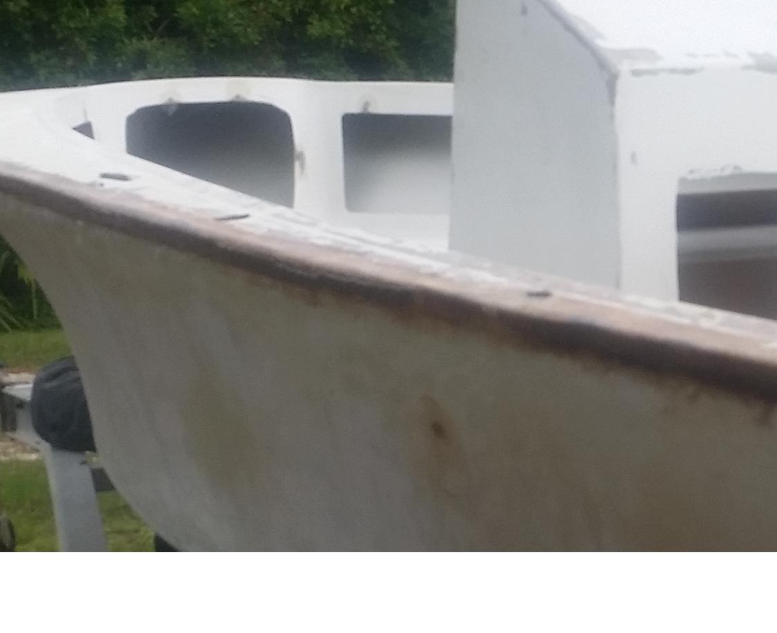

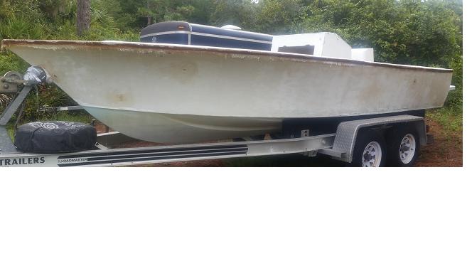

    I have been brought in to help my friend restore his Sea Craft. Most of the work has been done, some by me and some by another friend. The other friend replaced the floor, boxed in the transom, and built a custom center console. He used Coosa board for all with 1708 and polyester resin. He even did some faring with another polyester faring compound.
    I came a week ago and have taken on the task of glassing on the cap. I used all epoxy resin with 1200 biax.
    HOW DO I TIE ALL THIS TOGETHER? The boat is very rough and we have work done in polyester and epoxy. A lot of filler primer and blocking will be necessary. He does have a gallon of polyester primer that we can use over the areas repaired with poly, but where do we go after that? I could use a product like Awlgrip Hullguard, but IMO it does not sand easy. I need something that sands easily since there will be a lot of blocking out to get it straight. I like PPG K38, but I believe this is a LPU 2K primer and not sure how it will adhere?
    I am thinking about sealing everything with an epoxy primer (maybe awlgrip 545 or a PPG primer), and then some thick coats of 2K filler primer like K38. Finally I will seal all that in with a sealer coat of epoxy primer before painting?
    What are your thoughts?

    Use an epoxy primer, if you don't want issues. I've seen and used other primers over the years, but have never had an issue with epoxy, though have with some others. For the initial coats, K38 (urethane) will work, but I still like the epoxies. Have a look at the PPG primers. High build for the blocking, then you can switch it a thinner finishing primer for the smoothing prep under top coat.

    The boats pretty rough and needs a lot of blocking
    We have decided to go with an epoxy primer, then a fill primer (G2 polyester primer). The boat has had a lot of new construction added, to include new stringers/bulkheads, floor, custom center console, the transom boxed in, etc. We also epoxied the cap on and then ran a couple of layer of 1200 biax over the deck to accommodate heavy foot traffic.
    The guy at SPI was very informative and helpful. He said that epoxy primer is really not meant to be a high build, easy sanding primer. What he basically explained is that to get high build, fillers are added creating the build and a porous surface. The porous surface is what makes the blocking go faster. He explained that the porous surface however does not do a good job as a moisture barrier. Since it's a boat, moister barrier is especially important, so it makes since to go high build then cover the high build with an epoxy primer. The boat will never be in the water for more then a few hours at a time, so it will not be bottom painted.
    I told him that we already had a gallon of Polyester primer, and he said it builds three times thicker then any primer he sells. That being the case, we are going to first cover everything with the epoxy (adhesion), followed by heavy coats (5 mils each) of the Polyester primer. Next will block out the polyester primer and re-apply where needed. Finally once everything is nice and straight we will do a last coat of epoxy and lightly sand the epoxy with 320 or 400 before painting.
    Plz let me know if you think this is a good idea?

    The paint guy was blowing smoke in non-speaking orifices, possibly to sound like he knew more than he actually does.
    All primers, including epoxies have fillers, usually several. Some (the high builds) have more fillers and often different types. Epoxies can be easy to sand, though you should get the blocking done in the first 3 days after coating, or some can tend to get much harder to sand. You've already got a sealed surface with the biax and epoxy. A moisture barrier is important, but not so much on a deck or topsides as it is on the bottom (immersed). Good quality top coat will effectively seal the surface, particularly if over a good quality epoxy primer, that is also over an epoxy coated and sheathed substrate.
    Personally I don't fool with polyester primers any more. I use a regular epoxy primer if the work is ready to finish, but if it needs heavy blocking, I use a blocking primer (also epoxy). This is the situation with you, though you already have polyester on hand. For no compatibility issues, I'd just stick with what you have and block out with it, then put more polyester over it, to seal and prep for finish smoothing. I've never seen issues with two quality epoxy/polyester primers over each other, but the chemistry says there's a potential for it, which is why I suggest all epoxy or all polyester.

    We bought two gallons of Epoxy primer and sealed the boat. It had a decent build, but much harder to block then 2K. After blocking the epoxy, I'd say only a quart of the two gallon kit remained on the boat and many areas were sanded through, so the epoxy I laid down, didn't provide a moisture barrier anyway. In retrospect, I probably would have applied the 2k primer directly over the epoxy primer, blocked that several times and then another layer of epoxy before the Awlgrip.
    The only reason I blocked the epoxy, is because the manufacture said it had a decent build and that we might be able to cover the imperfections just with the epoxy. IMO, I think it is possible staying with just epoxy primer, but you better have a nice palm sander , lots of disc, time and epoxy primer. The 2K sands so much better. The epoxy primer we used was not marketed as a "High Build". If we had purchased a "high build" epoxy primer then perhaps that would have been the way to go? I know a lot of boat restoration guys apply the "hi build" epoxy primer with a roller so they get 100% transfer rate. Perhaps that may have been the way to go?

    Epoxy primer doesn't provide a moisture barrier. Yep, a real high build epoxy would do better or conversely you can add silica and make your own, though some experimenting will be necessary understandably. The 2K sands better, because it doesn't have as high a solids content. I spray high build on bigger jobs and roll on smaller.

    I painted the boat last week. The hull from chime to rub rail were painted ICE BLUE and everything else was painted with Awlgrip Cloud white. The ICE BLUE was brand new paint, but we got a gallon of the cloud white from a friend. The white has completely faded and flattened out. The ice blue still looks glossy. The white now looks like is out of a spray can of flat enamel. Any clues as to why this would happen. We used the same converter and reducer on both the blue and the white.
