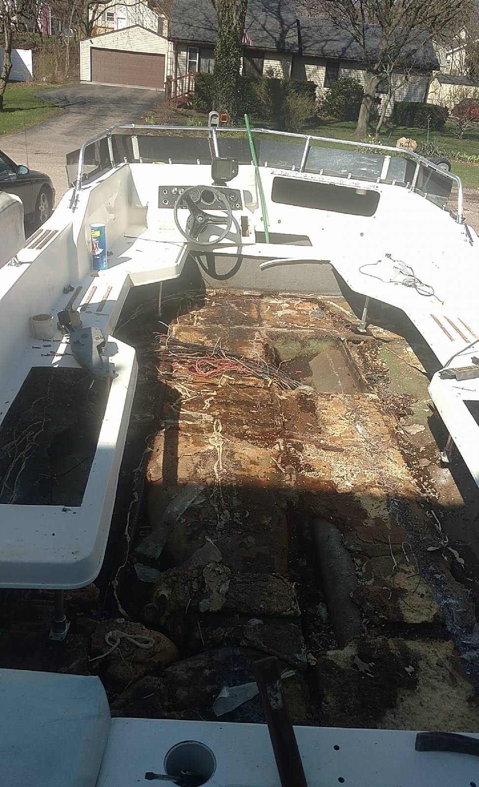

    I was looking for a nice flat bottom john boat and long story short I ended up with a 1978 Viking 190 S.I. deck boat made by Chris Craft through trading and basically it was free. It's powered by a 1978 Johnson 175 that probably came on it new. I knew the floor was soft but I've only ever had flat bottom aluminum very basic boats so I didn't know what I was getting into but I found out once I pulled the plywood. I've dug out the old soaked foam, finally manipulated the right tools that made the rotten stringers fairly easy to remove and I'm about to start reassembly once I figure out how to properly address the mushy compartment up front under the front seats. My biggest concern because I don't want to do it again, I have epoxy resin, fiberglass cloth, A-B pour foam, lumber and marine plywood, do I only need one layer of the cloth when I coat the stringers? How many layers of resin do I need to apply? That's my biggest current issue at the moment because I'm going to tackle it in the next day or 2. Also, do these boats have a solid transoms or do I need to figure out how to get in there and check for more rot?

    Most boats of that vintage, simply aren't worth the can of trouble you're about to open on yourself. Yeah, the transom is probably shot, along with the stringers, soles and pretty much everything else that's been sealed up down there, for the last 4 decades. The engine is also probably toast too, but I've seen plenty of them repaired and still in service, if you want to go that route.
    For an overview of the materials, techniques and methods, dowload the free users guides and epoxy book from westsystem.com and systemthree.com. Next look for previous threads here about the various projects you'll want to tackle. There's thousands of them, so expect to read for a few hours. Check out the videos over at bateau.com too.

    I got a heck of a deal on new marine plywood, 5 sheets for $100 and it's new, I'm really close to the owners of a local marina that does boat work and they sold me all the foam for $180 and after last night I have about $400 in it because I picked up some extra resin, cloth and stainless wood screws. I figured I've been lucky so far and I'll find something I'll need to fix. Here's a picture of what I'm working with, I'll post a picture of it cleaned out, I have a little more to get out in tight places but it's basically cleaned out.

    Start with transom. You have to remove ALL wood that got wet or rotten.. You are building a boat from a Fiberglass outside shell. Consider spliting top and bottom pieces, sometimes it easier to work in a open boat.you reattach back.
    Make sandwiches of plywood and Fiberglass to get thickness you need. Use Fiberglass and wood to make pieces, use Epoxy for final glueing. I love epoxy, but Fiberglass is easier and a lot cheaper for what you are doing. You need several layers. Don't be tempted to just pour Epoxy to solve your structural problem. It doesn't work that way.
    Make sure you work on a clean and dry environment otherwise your work will compromised. Get a carport, not just a tarp to work on your boat.

    Remember this Epoxy glues wood, Fiberglass and epoxy. Fiberglass glues wood, Fiberglass but not epoxy. I make my parts in wood, cover them in Fiberglass mat with resin, and then glue them together with epoxy. I get the strength of the wood, stiffness of glass sandwich, and low cost, and the bonding of Epoxy. But personally on your project I would have skipped epoxy, and just go with a higher grade resin like a vinylester.

    IMO you opened a can of worms, having said that, its open and your determined to complete it so go ahead. Make sure when you remove foam you clean it as most as you can and when you grind/ sand the fiberglass you keep it clean to place new mats. Im assuming your matching the same stringer layout so its just a jig puzzle before you start laying them on fiberglass and laminating them. As for the foam, what deck will you eventually lay on it?
    What ever deck you use, preferably fiberglass make sure you have a chemical bond with the deck and the foam if not its soft floor once again in no time. Sealing it and making it water tight is important.

    The keys is cleaning the whole thing up so everything bonds up good. Clean out wood, foam and everything has to get sanded. I hate carpeting on any deck of a boat. I have replaced way too many decks because of carpeting.
