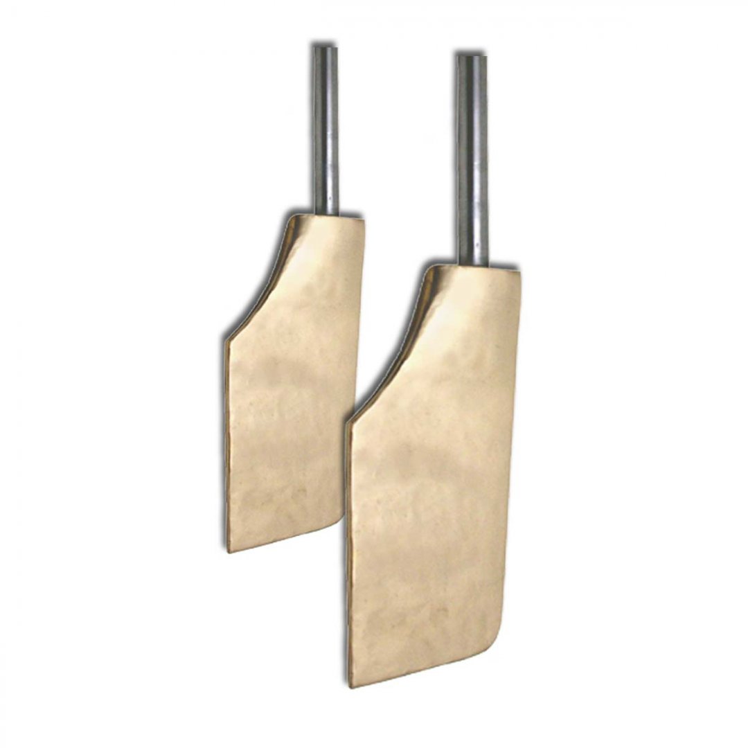

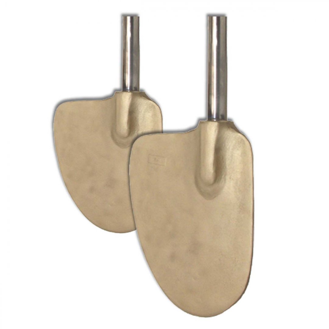

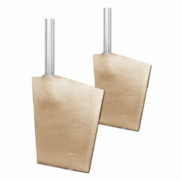

    Thanks for the replies. I'll be contacting some running gear vendors over the next few days. Based on Gonzos comment and stock rudders I can find online, it looks like I can go 2 or 3 inches deeper and a bit wider as well. I'm curious as to the different shapes of some of these rudders. From left to right these are called Standard, Spade and Special Rudders. If anyone can shed any light on the advantages of these different designs I'm all ears. It looks like my existing rudder is a Special Rudder. I'm assuming it's for planing boats. There are a number of stock rudders in each of these three categories that look like they would work. I'll have to do some more homework.
    KapnD, you're right about the running gear hanging out there. The only saving grace is that she draws well under three feet of water with the current set up and even with a little deeper rudder will be under three feet. I've been running her on the Erie canal system (pretty shoal in many spots) out to the Great Lakes without incident until last year. The mishap was completely avoidable and entirely my fault. :rolleyes:
    BTW, I was fortunate to spend three weeks over last summer in your beautiful state. Especially liked Kauai and the Napali Coast. You're lucky that you live out there.

    On my screen they appear one over the other.
    Standard-- with its round bottom allows submerged objects to be deflected instead of a hard snag.
    Spade-- gives greater surface area but is more easily snagged or damaged
    Specials-- are spades with a portion of the trailing edge removed. This would increase the "balancing function of the portion ahead of the pivot. It could also provide clearance for something hanging below the hull aft of the rudder such as a boarding ladder or wake shaper.

    Thanks again to all who weighed in with this. I did some research and made some phone calls. Getting information was difficult. Calculating the surface area of a spade rudder is easy but the curved standard style rudders, not so much. I even called Hydrasearch/Buck Algonquin thinking "they must have area specs for the rudders they sell." but struck out there too. Vendors wouldn't stick their necks out at all. Even general questions were met with "You need to contract with an engineering firm."
    Thankfully there is some information out there (thanks Dave Gerr). In the end I decided on a standard rudder from Buck Algonquin that I estimate to be about 25% larger in surface area than the rudder it is replacing. The stock is long enough that I can drop the blade down an inch or two and get it even with the lowest point on the propeller arc.
    As Bluenarr pointed out the standard style rudder is less likely to snag and with my running gear completely unprotected, the standard style will be more forgiving.
