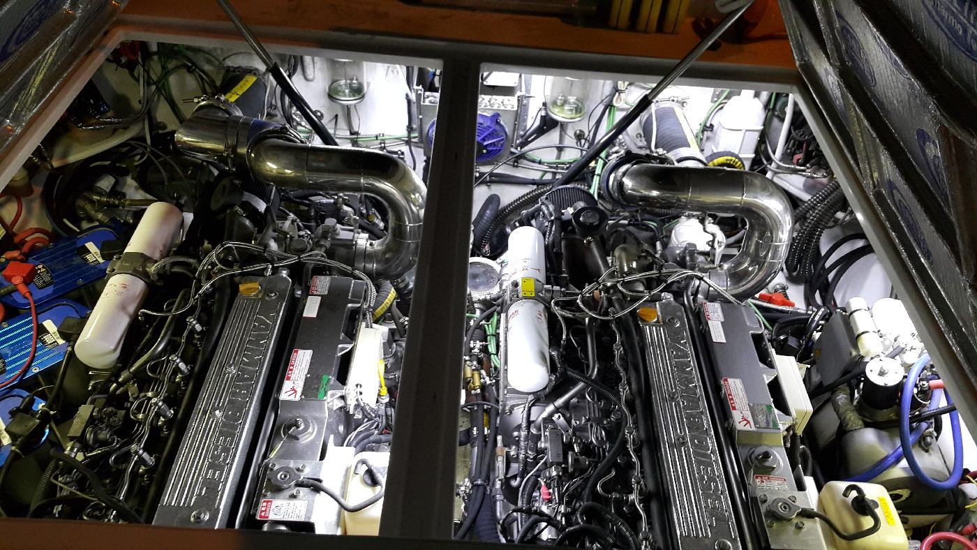

    1\Bobtail(botail is havn't gearbox) and kmh61a(is engine+Kmh61a gearbox) ,

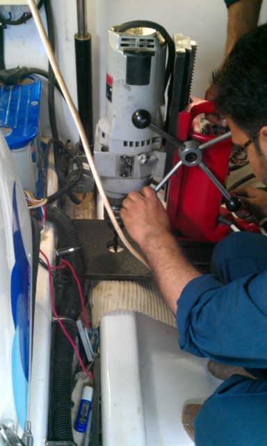

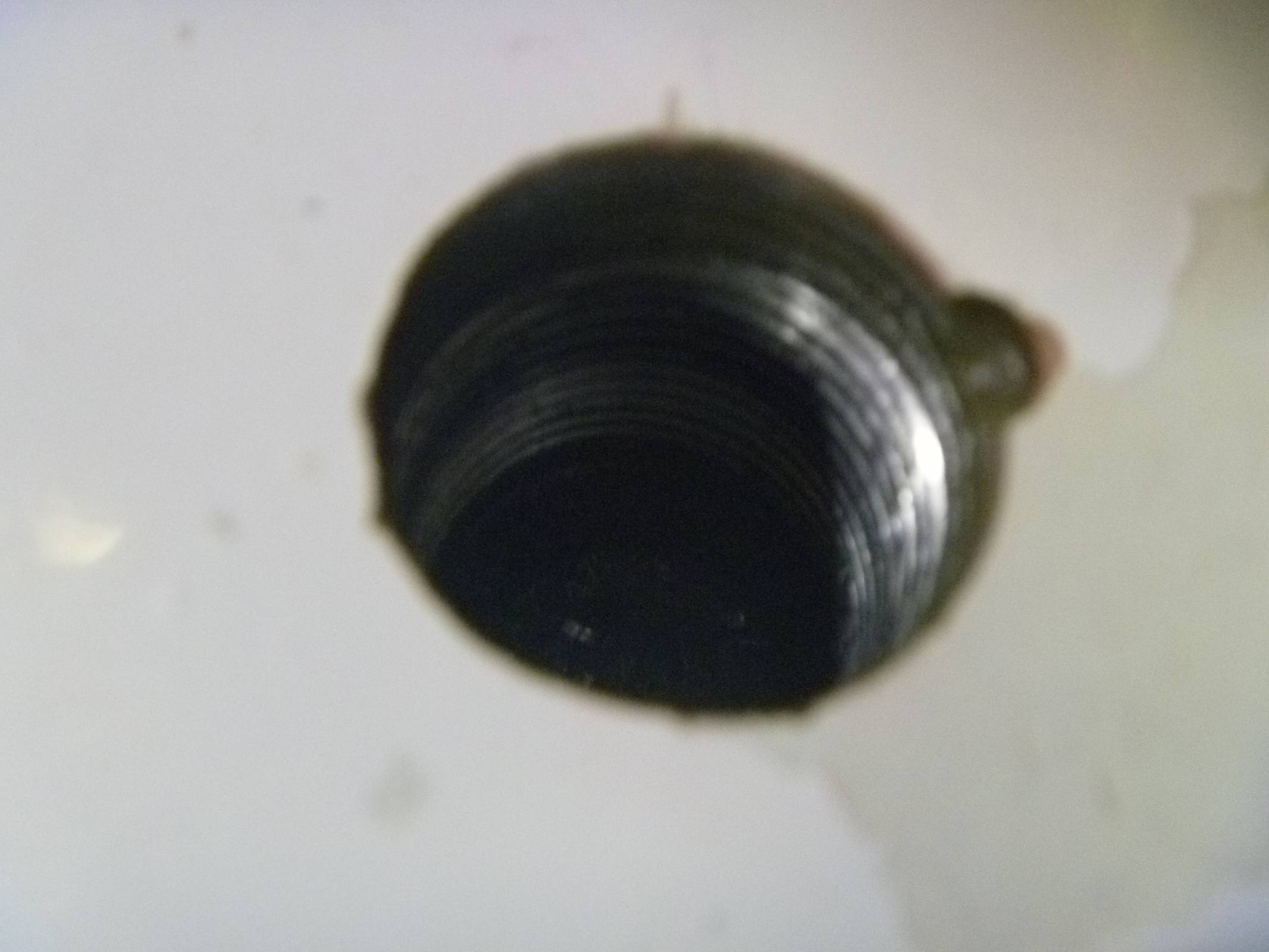

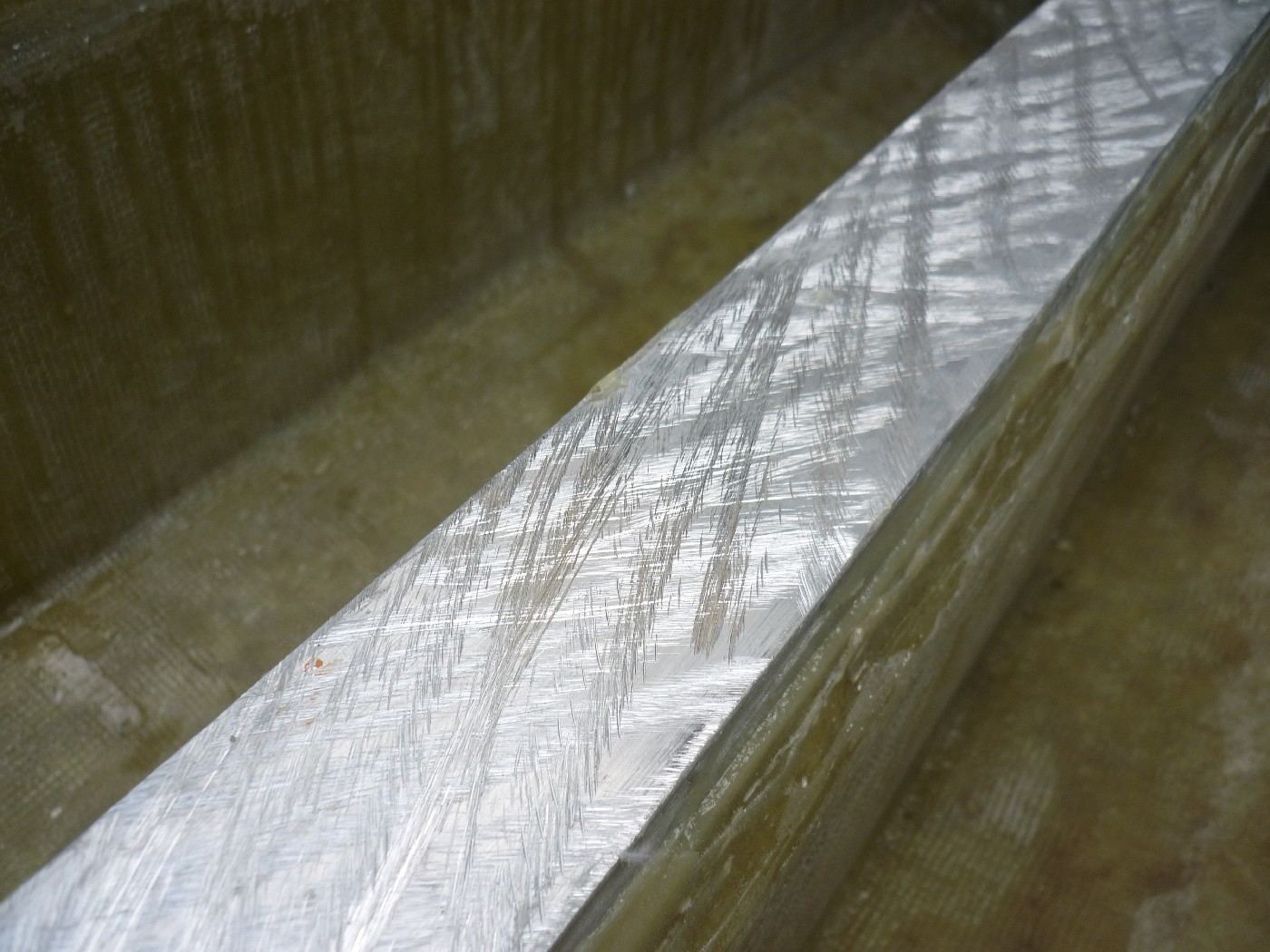

    I am using CV joints. GKN (Aquadrive CV 31); Initially my angles were to high but I corrected that. (not before I over-temped the joints and had to take them apart and repack with Castrol Optitemp Formula 1 racing CV joint grease rated up to and over 400F. I have a non contact pryometer on them now to monitor temps...

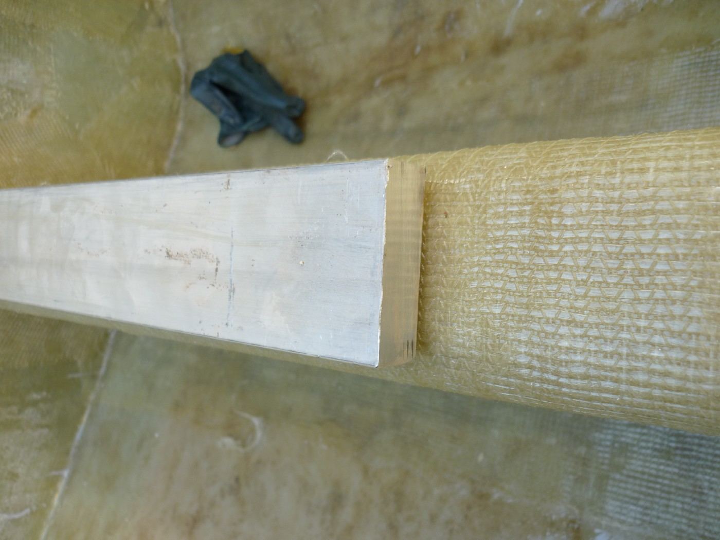

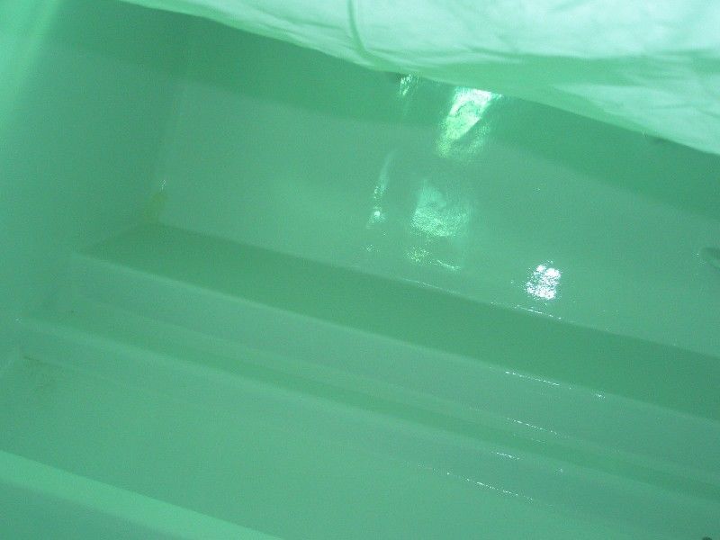

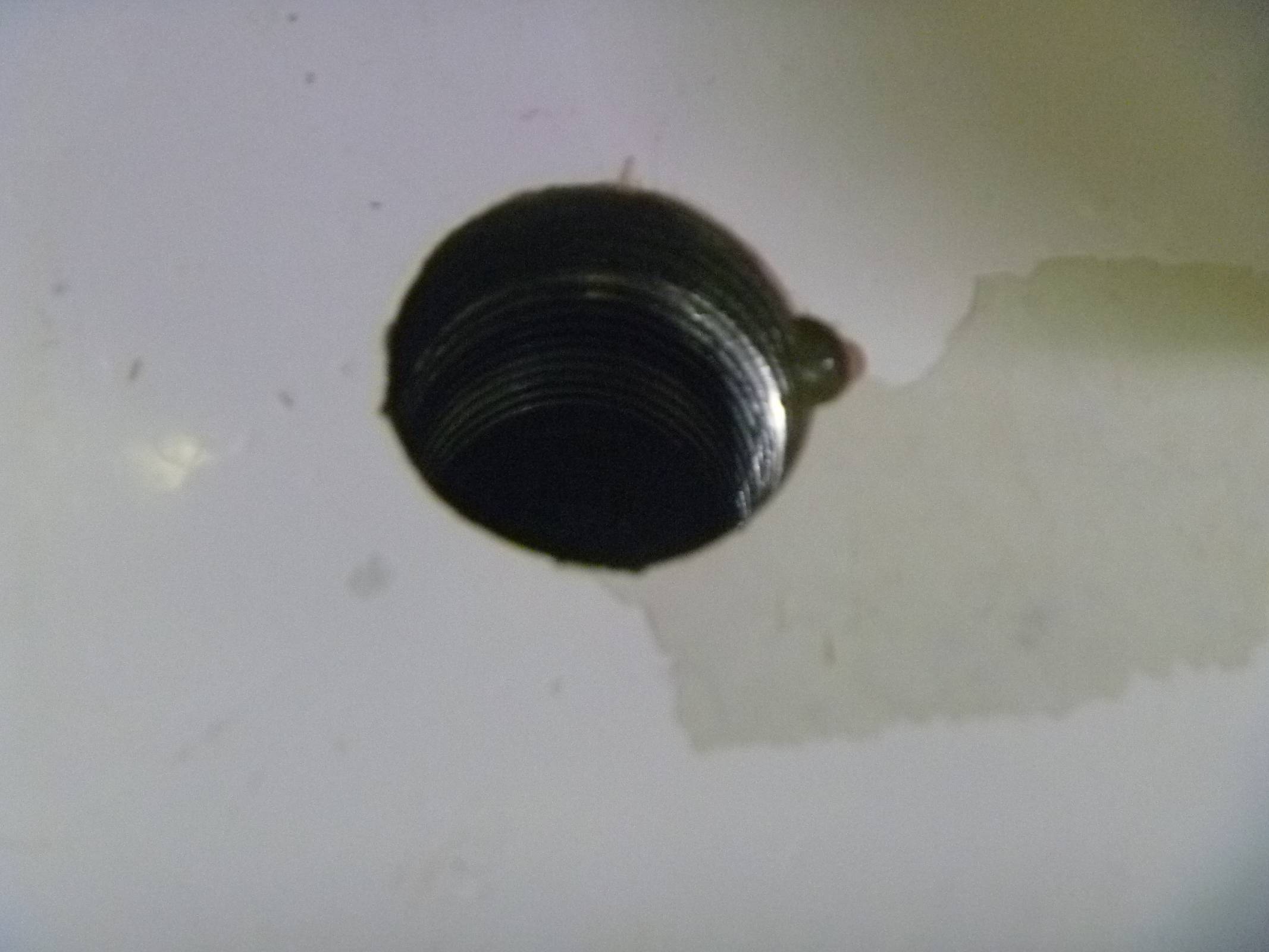

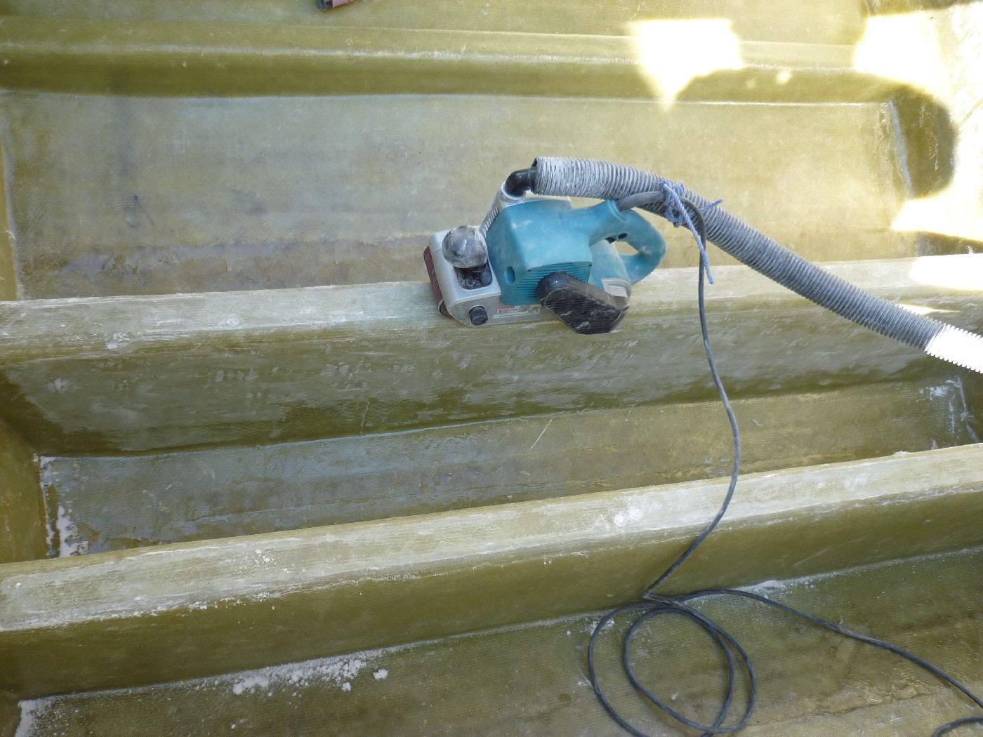

    The stringers were made with 10 layers biax, then a full length 30mm x 75 mm x 2 meter tapping bar embedded and covered with 6 layers biax. 20mm stainless locking keenserts were installed into the aluminum to which the Strong captive engine mounts were installed.
