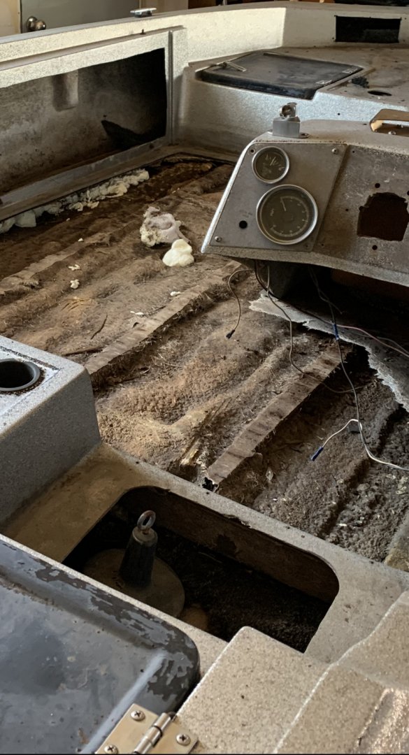

    Your primary concern is structural integrity, check everything with wood in it, floor, stringers and transom. Do nothing until you have fully evaluated their condition and have a plan in place to fix them.

  11. bajansailor
    Joined: Oct 2007
    Posts: 3,977
    Likes: 1,854, Points: 113, Legacy Rep: 37
    Location: Barbados
    bajansailor Marine Surveyor
    In a one word answer - NO!
    You will have a LOT of preparation work to do first.
    Others on here can better advise on this than me - although you do already have the answer pretty much in the posts scribed above by Ondarvr and Blueknarr.
    But don't worry about all that now - concentrate on getting the boat seaworthy.
    Please do post some photos of those longitudinal stringers attached to the hull bottom - it is possible that they might need attention after 42 years.
    Similarly the transom - inspect / sound it carefully. A rotten area will sound different / possibly flex, compared to a 'good' area.
    Check all the outfit items - you have the fuel tank out, but there are lots of other bits to look at - eg deck cleats, hull / deck joint on the inside, bilge pump, electrical wiring, steering system (cable or hydraulic?), upholstery on the seating....... - these are all more important initially than buffing or painting the hull.

  13. Kmmcreynolds
    Joined: Sep 2020
    Posts: 14
    Likes: 0, Points: 1
    Location: Aurora, CO
    Kmmcreynolds Junior Member
    Perfect! I attached a few pics. So I am NOT painting it, I will start with bare minimum on the hull.
    The back of the boat is up against the wall, so I am not able to currently get a picture of that...
    but I am honest, I have much work to do.
    I have checked all over, I have yet to find “soft spots” anywhere on the boat. Whether standing on the back, poking around underneath by the gas tank, everything seems solid. But I am still checking. FYI I will not spend time getting the live wells working, all sections of the boat seems very, very sturdy.
    With that said, I will need to replace steering, throttle (waiting to the confirm the motor I will use, I have a few choices before I move forward with buy/install that). All of the upholstery will need to be replaced, new seats, the wiring (will do absolute basic), you name it, I will need to replace it.
    As of now, I am not going in any real order (maybe I should), I’m just tinkering around and picking what to do.
