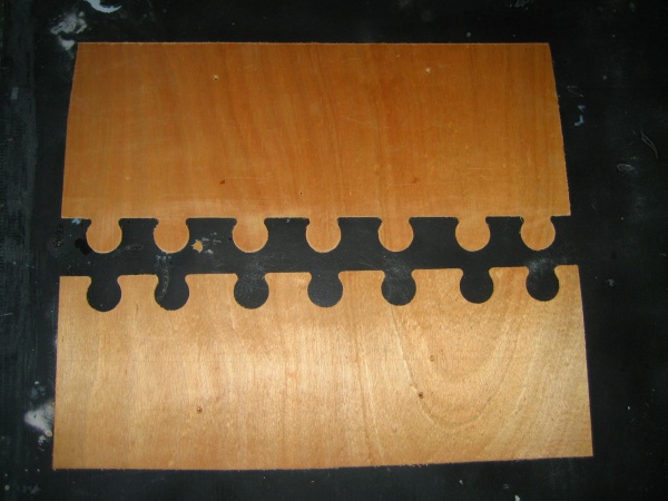

    Been a while since I've posted on here. I've been a liveaboard on a 41ft sailboat since October of 2018. Since we are in winter, I am slowly working through interior projects onboard.
    One of my next projects that I will be working on is going to be repairing a bulkhead that is rotted from the top down due to a companionway combing drain leak along with a port light leak. Due to the leak, the top 1/4 or so of the bulkhead has rotted out.
    I've included a photo of the area where the rot exists. Below that(from what I can tell) has none.
    I was hoping someone could clarify/confirm that I could just cut a new piece of marine ply to the proper shape and tab it in like you normally would and just do a laminate across both sides of the joints?
    Would this be sufficient enough in terms of strength for any sort of hull flex/movement that may occur?

    It sounds fine in theory without having a look. If you want to be ultra sure, you could do some puzzle joints, where the joins with the good plywood have little dovetail "keys" that lock in the new ply, before glassing.
    I have attached a really complex photo of such a joint, but you would not need anything as tricky. A few "dovetail" tabs would be good.

    Assuming the ply is 3/4", another option would be an 8:1 or better scarf and thixo or 6" at 3/4". No small task for that spot, but an oscillating tool and a good 1/4 sheet sander would probably work.
    Or sharp chisels and a good chiseler. The joint does not need to be tight as it needs glue. Then wet it with ready resin to avoid a dry joint and add the thickened.
    All the scarf or puzzle joints do is increase bonding surfaces here.

    Epoxy is really good at filling gaps. The scarf can be done with a small grinder. Otherwise, the easy way is a Payson scarf.

    I was thinking of doing a scarf above the door and inside the hanging locker, but then started to think about the giant PITA it's going to be actually creating the scarf. Maybe it wont be once I actually pull the trim and look deeper at the design.
    That being said, I totally didn't think about doing a dovetail. That would be quite easy to do, and I could easily integrate a Payson scarf(just learned about this, so thank you gonzo). If i were to do the payson scarf, a couple clamps would be all I need to put the pressure on it the exterior board, and wouldn't be in the way(considering I live aboard).
    The biggest task as always is going to be tearing it all apart as we are full time liveaboards and having to work a normal job will cause it to be a bit of a PITA while dealing with it.

    not to be a nit, but it is a structural bulkhead; just not related to the rig
