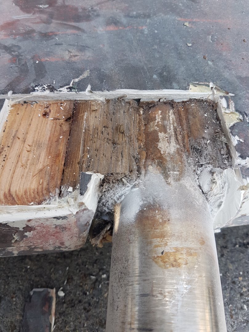

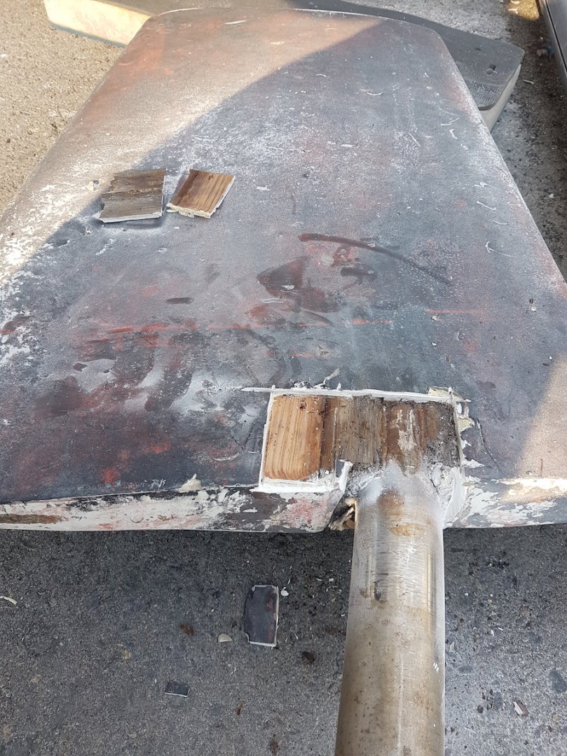

    Hi all,
    I am about to start a very steep learning process, my 11 year old son loves fishing (carp mainly but now sea) and it seems his natural progression has moved on to a purchase of an old 14-15ft cathedral hull fibreglass boat.
    I have done some research and there is a good local chandlery where I can go to have a chat about each project and buy bits I need however I want to do this properly from the start, does anyone here have any advice about anything that may help me plan things.
    I have stripped all of the metal work off the boat and removed the old board that housed the helm and separated the small cabin from the open deck, all deck panels removed. There are a couple of small cut-outs in the deck and which has let rain water in and soaked the foam (all covered up now with a tarpaulin and boat tilted to help drain any water), my first mini project is the deck; should the foam under the deck be replaced with new expanding foam or can I leave to dry out, the deck is sturdy and wouldn't say it needs to be replaced unless the foam doesn't dry out. Should the foam be replaced with a different material.
    Sorry its a long one but completely new and looking to gain as much info as possible as planning to start this after winter. I think with a lot of work and attention to detail this could be a nice little oat wen done, I just want to get it right.

    Buying a boat for taking a kid fishing is great thing.
    I have loved fishing since a young boy and why I like boats.
    For a wet boat, you want to make sure the boat has no core. Core, as in wood core. I doubt your does as most of those style we've seen on this website are solid glass. The 70s were a time of experimentation. If the boat has a wet core; it is almost impossible to repair.
    Once you know no core exists; you will probably want to remove the wet foam and refoam new. Take a small smple and see if it is wet through n thru. Wet thru means it is a more open celled older foam. Open celled foams will never dry out. Well, maybe 20 years in a heated climate controlled building. The new foams are closed cell and won't absorb water much.
    Just no idea to what foam you refer. You would be quicker to get the boat in the water physically removing any water or saturated foam.
    That boat is not made for rough seas at her beam; so avoid them.

    There has always been a bit of confusion on flotation foam, there has never been an open cell product used for flotation, it only becomes more like an open cell product as it ages and the cell walls break down.
    Once the foam has become water logged it needs to be removed, there is no saving it.
    When the foam is wet then any wood in the boat is probably rotten also, this requires a total gut and rebuild.
    It can all be done, but it’s typically a labor intensive, time consuming and costly project.

    You can check the transom for rot at the garboard drain.
    If the sole(floor) is still in place; then you don't know if the hull stringers are rotten.

  9. ondarvr
    Joined: Dec 2005
    Posts: 3,194
    Likes: 784, Points: 113, Legacy Rep: 506
    Location: Spokane WA
    ondarvr Senior Member
    In the last pic it looks like there a metal strip on top of the transom, remove it and inspect the wood. There also appears to be some type of material screwed to the outside of the transom, this can be a bad sign.
    Typically something is screwed to the transom because it’s in bad shape, then the new screw holes leak and make things worse.

    No metal strip on top of transom its where the top of the boat meets the hull.
    There was a mounting plate fitted which I believe was to protect the hull from damage when th engine was in place. The mounting plate was homemade and didn't really fit well so I took it off as I want to strip the boat back and repair so its a blank canvas, will have to take up the deck and have a good look just to make sure its all ok prior to putting money and time into it.
    Thanks.
  12. fallguy
    Joined: Dec 2016
    Posts: 8,833
    Likes: 2,048, Points: 123, Legacy Rep: 10
    Location: usa
    fallguy Boat Builder
    If they had the plate screwed on, check for rot in the screw holes. Use an awl or sharp tool and see if you can push down into the transom.. those holes will need repair anyway, so you can't really hurt the boat there
    I would still probably check down at the bottom further. You can do it from the inside. The screw holes might be rotten, but it might be limited to the top there.

    If there are no bolt or screw holes in the transom, which would be a wonderment extraordinaire, it wouldn't hurt to drill some just through the fiberglass so you can poke around with an awl to see if the wood is soft. They're easy enough to patch.
