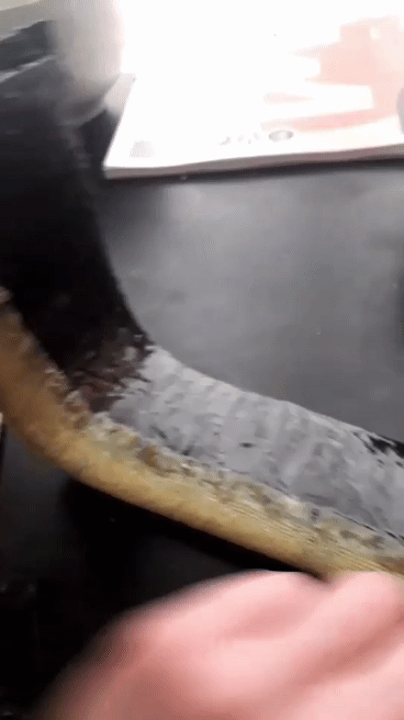

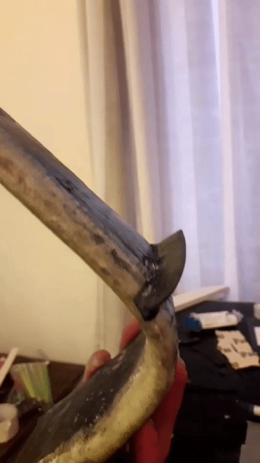

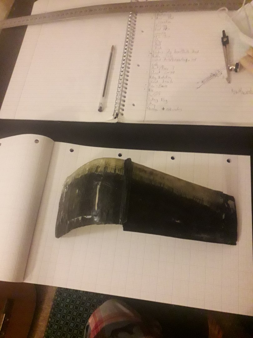

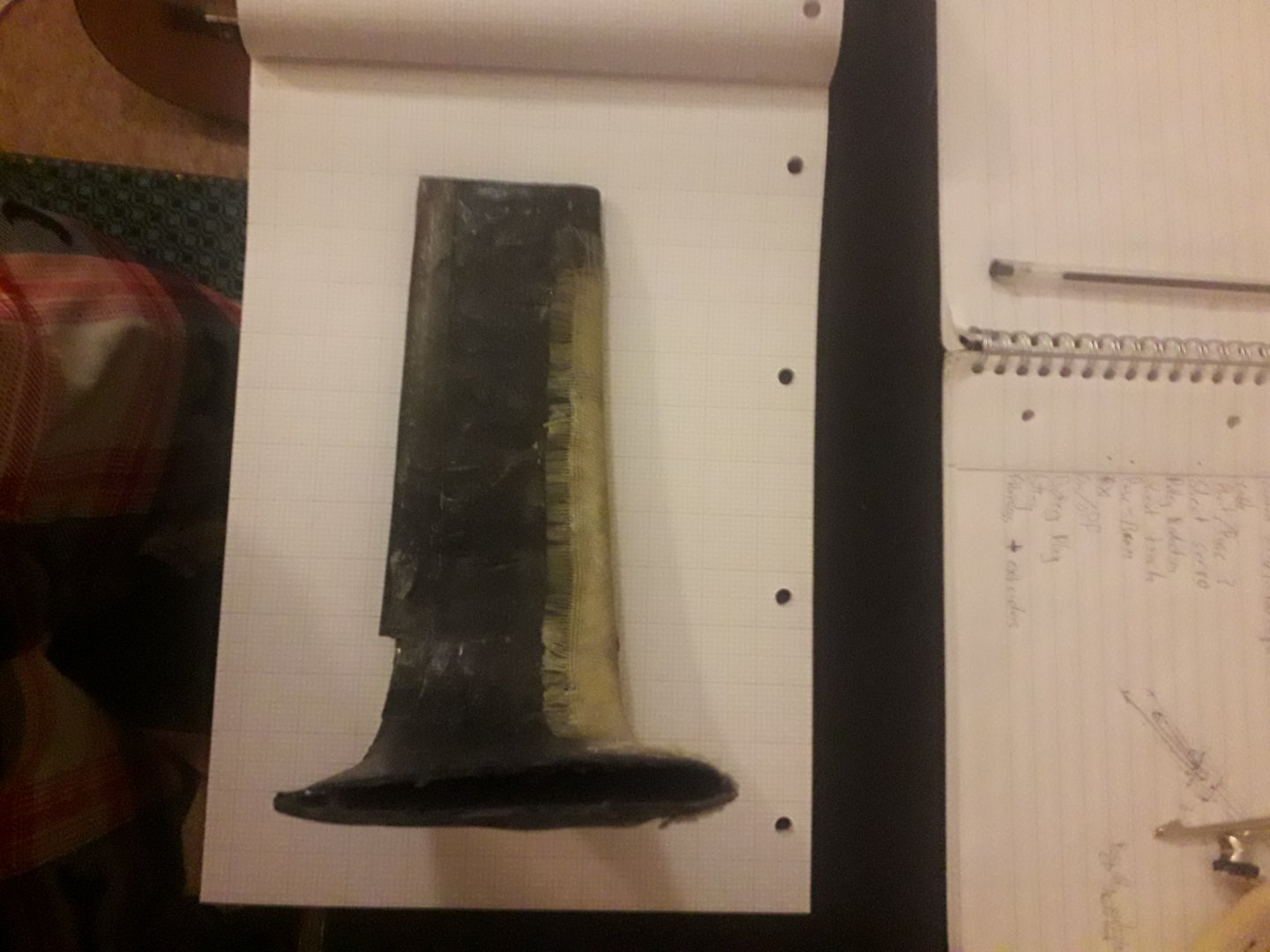

    Sanding the foil and added a fence to stop ventilation
    AlexanderSahlin and Will Gilmore like this.

    Looking forward to see your model sailing! As I commented earlier in this tread, your foil is probably a little oversize, and also seems to have quite much camber in the section. This is a good foil to start testing with. When you want to go faster you can reduce foil-area and probably also camber. When I make anti-ventilation fences, I use to make them extend around the leading-edge, 2 nose-radii or so. But I suggest that you start with the foil as you have built it.

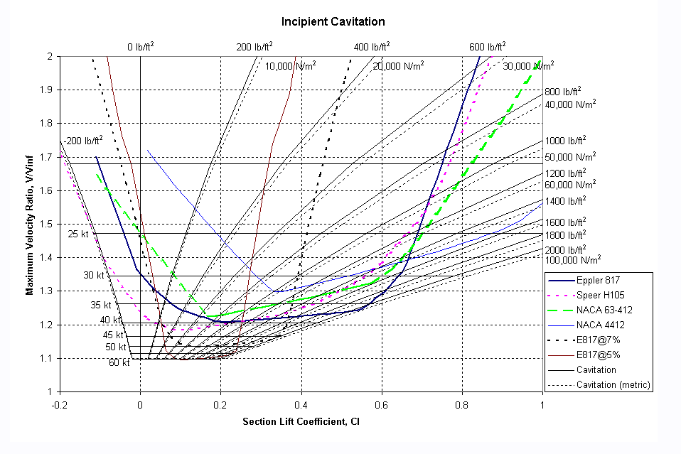

    Nice project! In addition to what Alexander says you have to consider cavitation numbers, except for ventilation. In Tom Speers curves below, you might get a grip on what you need to go for(50kmh=27kn). About lifting forces you need to use CL3, that might be half or less of the CL2 numbers you have used. Let´s say you follow Alexanders advice to go for CL2=0.4 and hypothetical calcuations give CL3=0.2, you are down to one third of the force your previous calculations show. As you have a slanted foil the forces can be calculated for both horizontal and vertical lift. Curious, what profile are you using? These are my thoughts, but Alexander is the expert here.

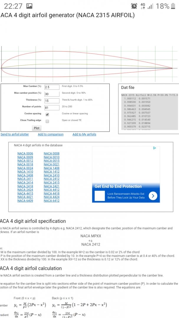

    Could you further explain cavitation numbers and the graph below. What do you mean by CL2 and CL3.
    I do have a slanted foil but I'm not breaking the forces up into horizontal and vertical components as the lower section of the foil is parallel with the kant of the wing sail and the forces from each are resolved through the center of effort for each of them. Ie wing force = foil force . The upper part of the L foil will just lift the rear float clear of the water as it accelerates. the faster it goes the higher the ride height and the less area of the upper foil is in the water. Am I understanding your point correctly.

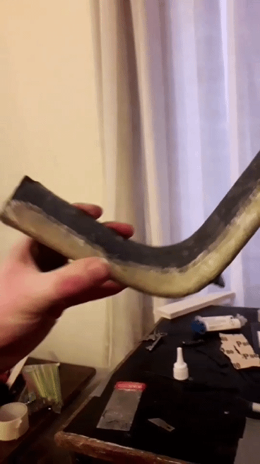

    I'm also curious as to what profile I'm using. The first foil I made was cut and sanded from a piece of thick pvc pipe which was then heated and bent into shape. I had no design parameters in mind from the get go and it was very much done by eye. The second foil is not much better as I simply used the first one as a mold for the carbon fiber. Below the radius of the foil, the root chord is 80mm , thickness 12 mm , position of max thickness is about 25 mm from leading edge and I'm unsure how much camber there is but not much. I'll see what kind of naca profile I get with these dimensions. Keep in mind the profile is far from uniform along the span.

    NACA 2315 or something thereabouts. I know it's far too thick as well. To my knowledge at this scale I should be thinking something along the lines of 6 to 8% thickness rather than 15% .

    Design for avoiding cavitation and the graphs from Tom Speer make sense when you have passed 30 knots. What you see in the graph that Revintage posted is that you have to make a traditional hydrofoil-section with sharp trailing edge unpractically thin to avoid cavitation when going faster than some 50 knots. If you can fly the foil deeper in the water, where the static pressure is higher, you can increase the cavitation-speed a little. The AC-75:s seem to have foils with sharp trailing edges and will probably cavitate if they go faster than their current top-speed, 53 knots.

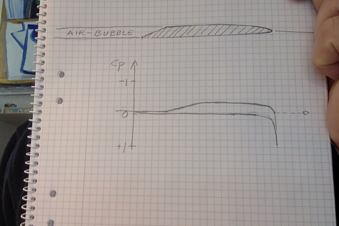

    One solution if you want to go substantially faster than 50 knots is a base-ventilated section. The idea is that you have attached flow on both sides and an air-bubble behind the thick trailing edge. Of course you get some pressure-drag, but at high speed and moderate submergence, the pressure-difference between the air-pressure in that ventilation-bubble and the free-stream pressure in the water at the foil's depth is very small compared to the dynamic pressure from the water. For the base-ventilated section I designed for the Paravane Speed-sailer I estimated the pressure-drag coefficient to some .001, i.e. below 1 % of cl at 60 knots.
    In my attached sketch is a sketch of a base-ventilated section for cl around 0.2. The graph below the section is the pressure-coefficient distribution for such a section at such cl. I have the coordinates for my base-ventilated sections somewhere in my old computer, I can look for them when you are ready to build a 50 knot+ foil.
    What you win with such a base-ventilated section is that you can get a surface-loading near 1 bar for speed around 60 knots for some 10% thickness instead of the very thin section that is required if you have a thin trailing edge.
    I am quite sure that also the succesful Sailrocket 2 used a base-ventilated section during the 65 knot run.

    We are talking 27 knots here, so anything better than 4412 will probably do. If going for four digit NACAs I would go for 2412. It´s max speed before cavitation is a just under 35knots with CL2=0.3, with a 1% thick trailing edge a few knots lower. So there is an ample reserve. Did a very simple static Cpcrit calculation of NACA2315 with 1% thick trailing edge and CL2=0.3, giving cavitation at just below 30knots. As I understand it the rear foil is surface piercing, so it will not run very deep, ventilation might be the bigger problem?
    Glueandcoffe, an OVER-simplified way of calculating CL3 is CL3=0.9*CL2*(AR/(AR+2)), where AR=span^2/projected area. Note this is very coarse, but it will anyway give you an idea of what to expect. About homemade sections, I have designed a suboptimal one around building material I had in my stash and am now making surface piercing V-foils(12% at 27%, 2.2 camber at 50%) with, for building reasons, a NACA0012 nose for the first 27%, followed by a completely flat bottom. XFoil simulations shows cavitation numbers of just under 40 knots with CL2=0.18 and 35kn with CL2=0.35. My goal is to sail +30knots with them. Definitely not as advanced as your Sailrocket design, though.

    By "cl" I mean the lift per unit area divided by the free-stream dynamic pressure at one section somewhere along the foil's span. By "CL" with capital letters I mean the total hydrodynamic lift of the foil divided by the foil's projected under-water area and free-stream dynamic pressure. I think those definitions are quite common. For my high-speed applications I designed the paravane just for having the best lift/drag at some 60 knots and avoiding cavitation. The configuration, with a stabilizer controlling the angle of attack, ensured that CL was always near that design-point. I recall CL used to be in the 0.14 range, with a local cl a little higher below the fence and much lower above the fence.

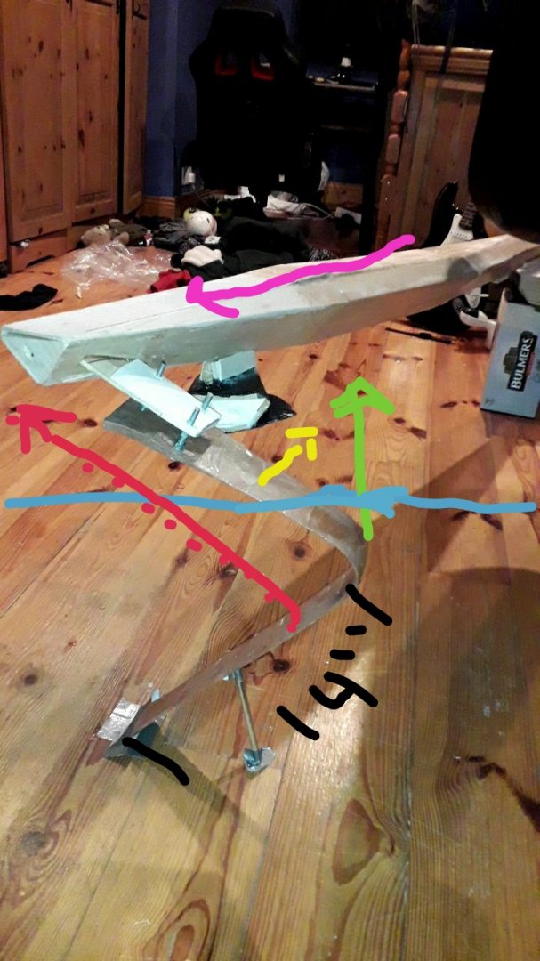

    How does CL differ from Cl2 or CL3. Is there a CL1 or CL4. Imagine you're explaining to someone who googled what a coefficient lift was 5 or 6 weeks ago. I heard about CL2 and CL3 last night and still don't know what it refers to or how its defined. Is it dimensionless, does it have units , vector, scalar, speed ,pressure, force, area ,direction, characteristic. I don't know.

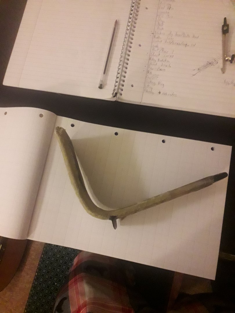

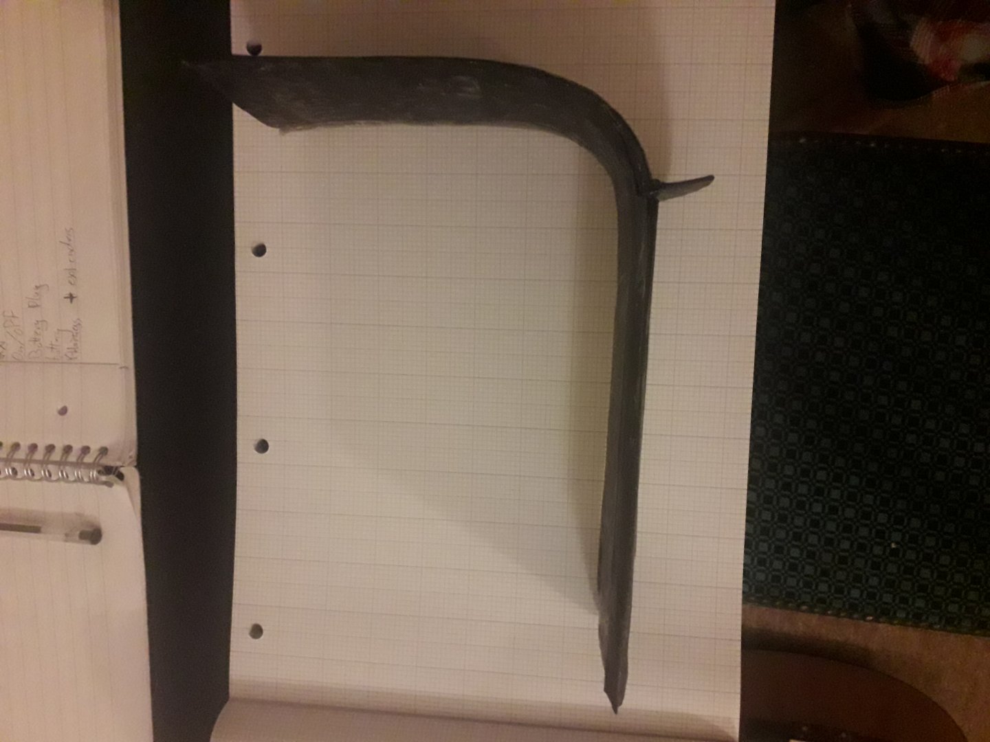

    But anyway I have 2 foils made. The pvc one and the carbon one. I'm not talking the surface piercing portion of the foils with these dimensions I'm about to give. Just the lower portion opposing the sail force.
    The pvc one is 355mm radius to tip. Radius chord 75mm. Tip chord 50mm. Max thickness approx 8mm. No ventilation fence.
    The carbon fiber one is 180mm radius to tip. Radius chord 80mm. Tip chord 65mm. Estimated profile naca2315. Has ventilation fence.
    The lower portion of the foil stays fully submerged at all speeds so its force balances sail force. The upper portion of the foil pierces the surface so speed , boat weight and sea state balances forces to effect ride height of the rear float.
    Treat the upper portion as a separate entity to the lower portion. Their forces act at right angles to one another. Like a planes rudder and elevator.
    This is for pvc foil.
    Red line is sail force
    Pick line is apparent wind
    Green line is true direction
    Blue line is water level
    Yellow is upper foil force.
    Black is 14 inches

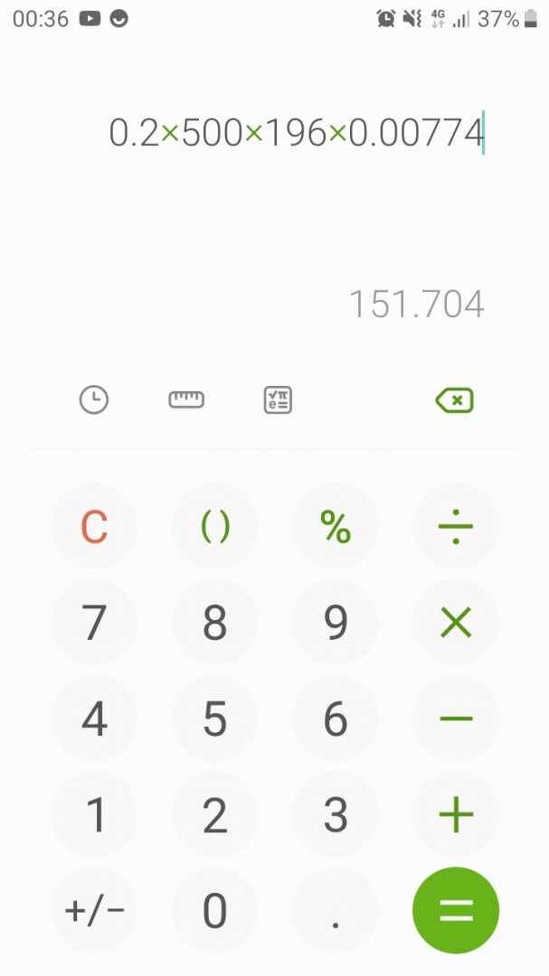

    Calculation done below is for carbon foil. 150 odd newtons seems ballpark compaired with the sail.
