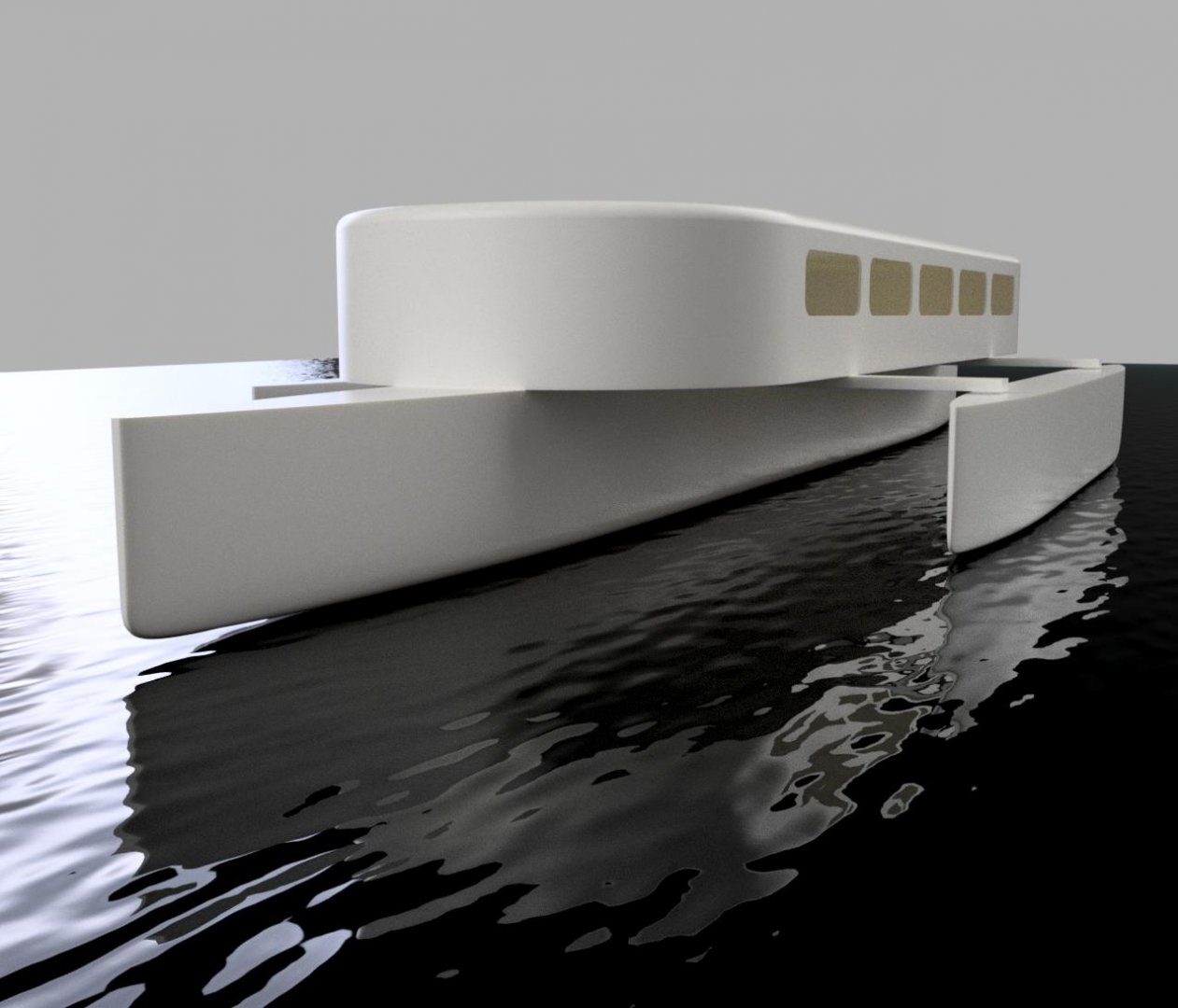

    Just wanted to share an alternative concept I played around with a while back:
    A power trimiaran with folding amas could work as minimalist boat that can move only using solar panels. Square U shaped hulls and a T shaped profile wouldn't be much harder to build than a box.
    The interior would be a long corridor with lots of desk or kitchen counter space that you could separate into gallery, seating area or bunks. Upside is you never have to stoop to access anything haha. Although you could have storage and the battery below the floor.
    This sketch is 15m long boat with a 3m wide cabin so I can fit 3 rows of standard solar panels. But it could also be designed with 10m length and 2m wide cabin which would still be trailerable and work as a tiny house. Maybe a weird tiny house, but it could be quite cosy.
    For narrowboat canals you could fold the amas in below the cabin. Not sure if that would still give enough stability. With expanded amas I believe this could be designed to be offshore capable.
    Inspired by the harry proa you could have a tender that becomes part of the deck between the hull and the amas. This is only a rough sketch, the front could be prettier and more aerodynamic:

    I absolutely love the look of that, especially the ability to bring in the sides so the it could use canals
