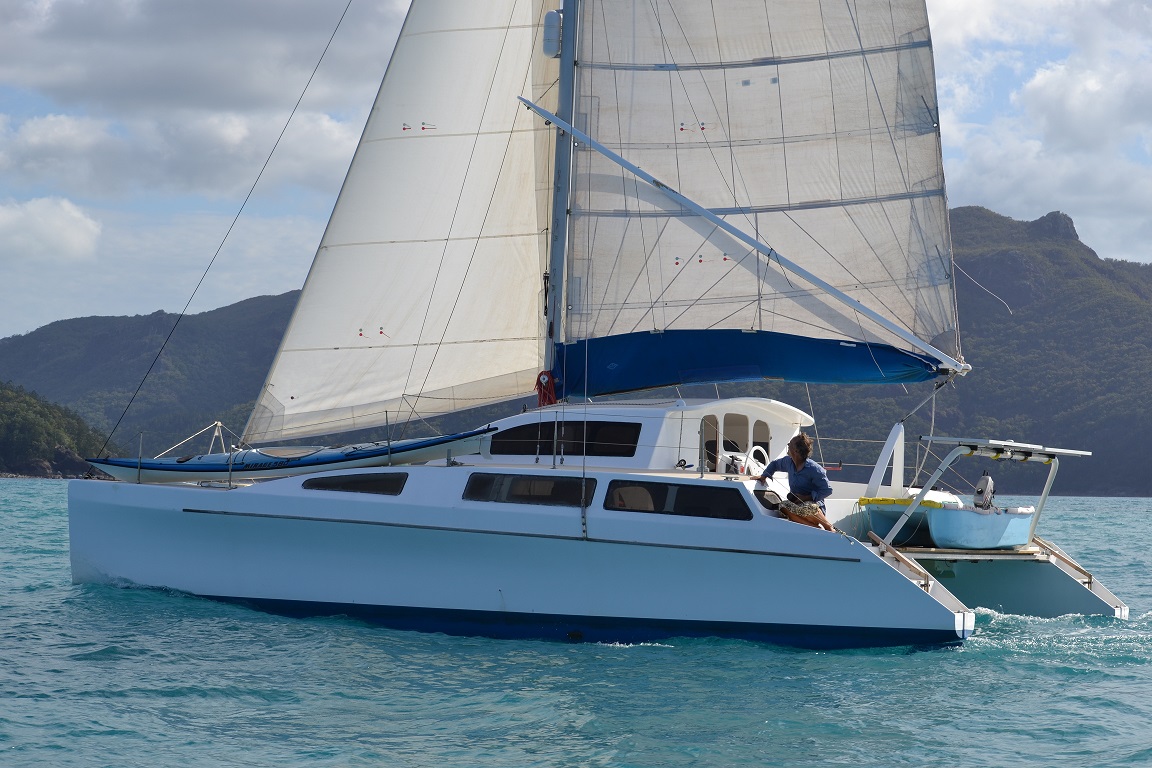

    I love my wishbone. It has been one of the few things I haven't mucked around with in years years of owning and sailing my 38ft Chamberlin.

    4:1 mainsheet only, no winches, preventers or barber hauls. Same mainsheet and blocks for 17 years. About to replace. Hardly any chafe. Main in great condition for age as the wishbone keeps it pulled nicely and evenly all of the time and protects it from the rigging wires. Sometimes thought about selling my boat but then thought, how could I ever find another one as easy, fast and fun to sail?

    Oh no! She has had a heap of work done since then and looks much more loved. I should do a new one but it does show me pumping the main. Notice how the wishbone protects the main against the shrouds.

    Having sailed her a fair bit I can say that she tacks very nicely, and the wishbone really does make the mainsheet extraordinarily easy to handle. The rather spartan bridgedeck is great for those of us who spend lots of our cruising time being active; you can leap out of the water, drop your snorkelling gear, and slide into the bridgedeck without dripping salt over velour and teak.
