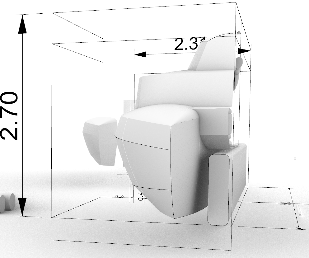

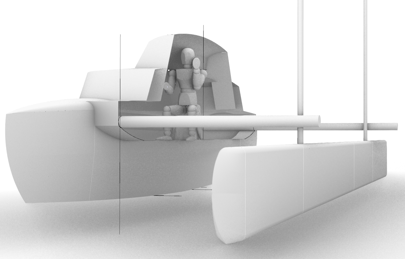

    Here's some pics of how the whole thing will go together.
    The beams are maybe looking a bit under done?

    Put a cap piece of timber on top, taper down to almost nothing at the end, maximum moment is going to be at the lashing at hull. And run some unidirectional glass continuously along the bottom. If it's going to break my money is on the front beam where the mast compression falls. Impossible to tell likelihood of such at the moment, would need the total displacement of ama and some details of sail (area & shape) and dimensions. Practically I think you'll be fine; as has been said the weakest link is the bolt and pin arrangement at the hinge. Finish it, sail it and let us know how it goes.

    I'm thinking if the hinge bolts are torqued down to a reasonable figure with quality bolts and structural washers, this should mitigate some of the issues?
    2000kg clamping force is easily attainable on a 12mm bolt with a 30mm diam distance piece. Up until the (clamped) friction of the plates is overcome the pin holes should see no load.
    It does mean every hinge mating face will have to be clean and the bolts torqued properly on every assembly, which is a PITA and a sure example of poor engineering. I think I'll run with it though.
