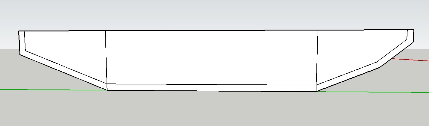

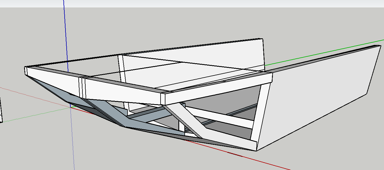

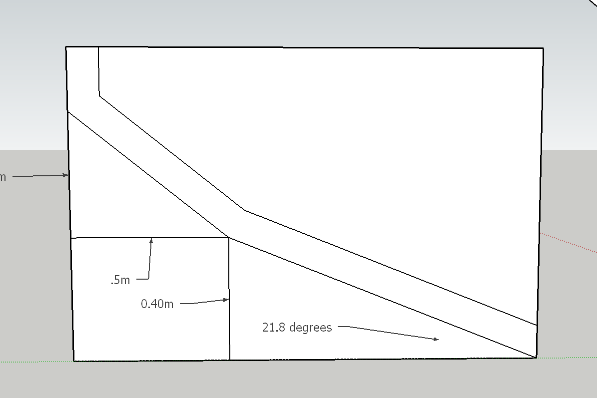

    I've been busy at thought and after all the consideration the work I have already done will have to go else where in the boat...

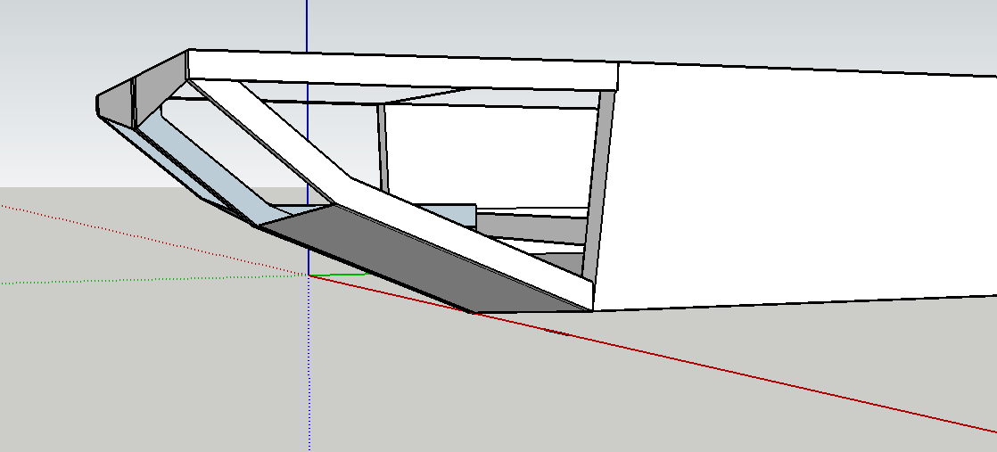

    So based on the recommendation of solid frame with marine ply, here is what I've come up with, it's based around 2 by 4's with the keel being 4 by 4 (was just out of handy measurements not really definitive)
    After all deliberation the main focus of the boat is to provide a home for living along the canal's for some time.
    I've a lot of photo's here now but the dimensions I can elaborate on after if that's best?

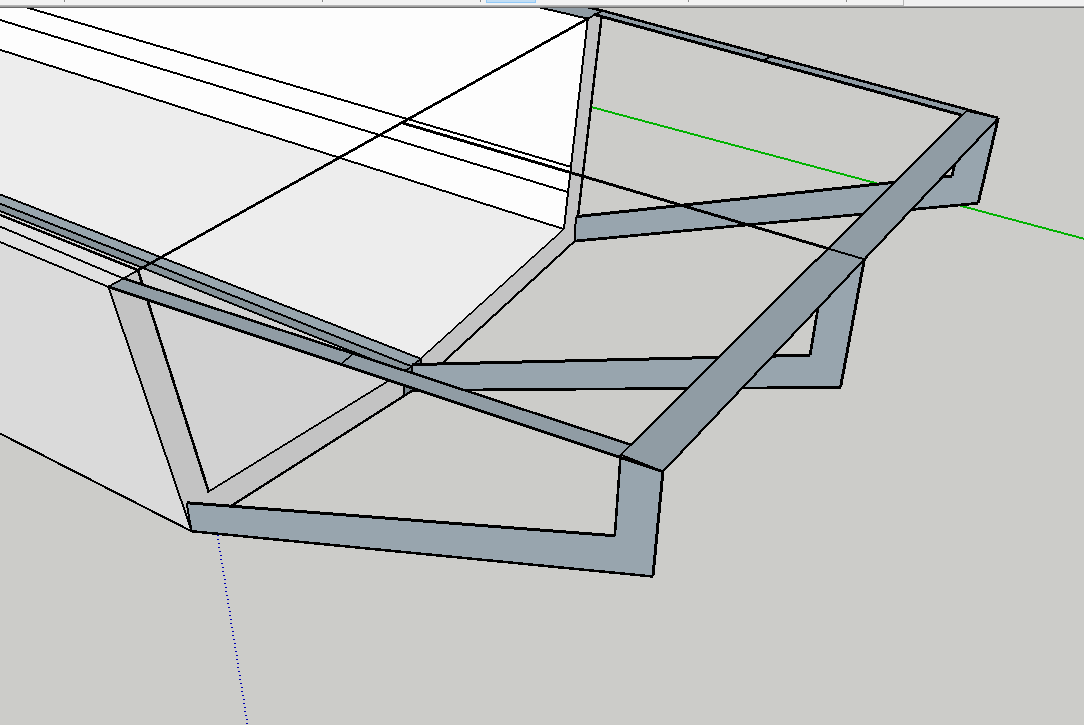

    Stern is just the first line of the bottom right continued on until it hits the outer part of the rectangle.

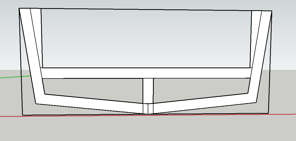

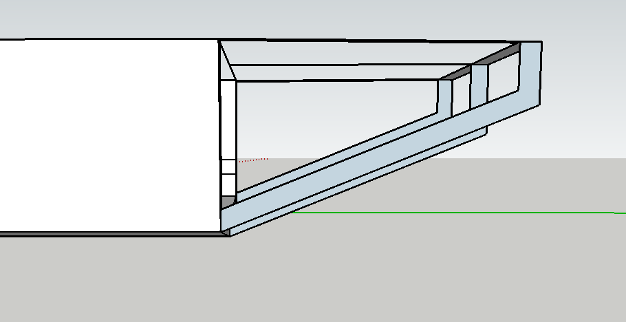

    Framing horizontal view. Horizontal of hull.PNG the plan is to have the chime logs be part of this farming structure.
    Hull Length-ways full view. Stern to the left Bow to the right :) Hull Horizontal..PNG
    I don't plan on re-inventing the wheel, I was wondering if there is any boat building books you could recommend as a nice way influence to the project and bring me more up to speed?
    May be steel for a future project unfortunately, might look into some classes on welding near by they run them in the evenings :)

    How much headroom in the cabin is desired?
    What is the clearance from water surface to the lowest overhead obstacle (bridge, etc) you will want to go under?
    What is the maximum draft which will go where you want to go?
    What is the widest feasible beam?
