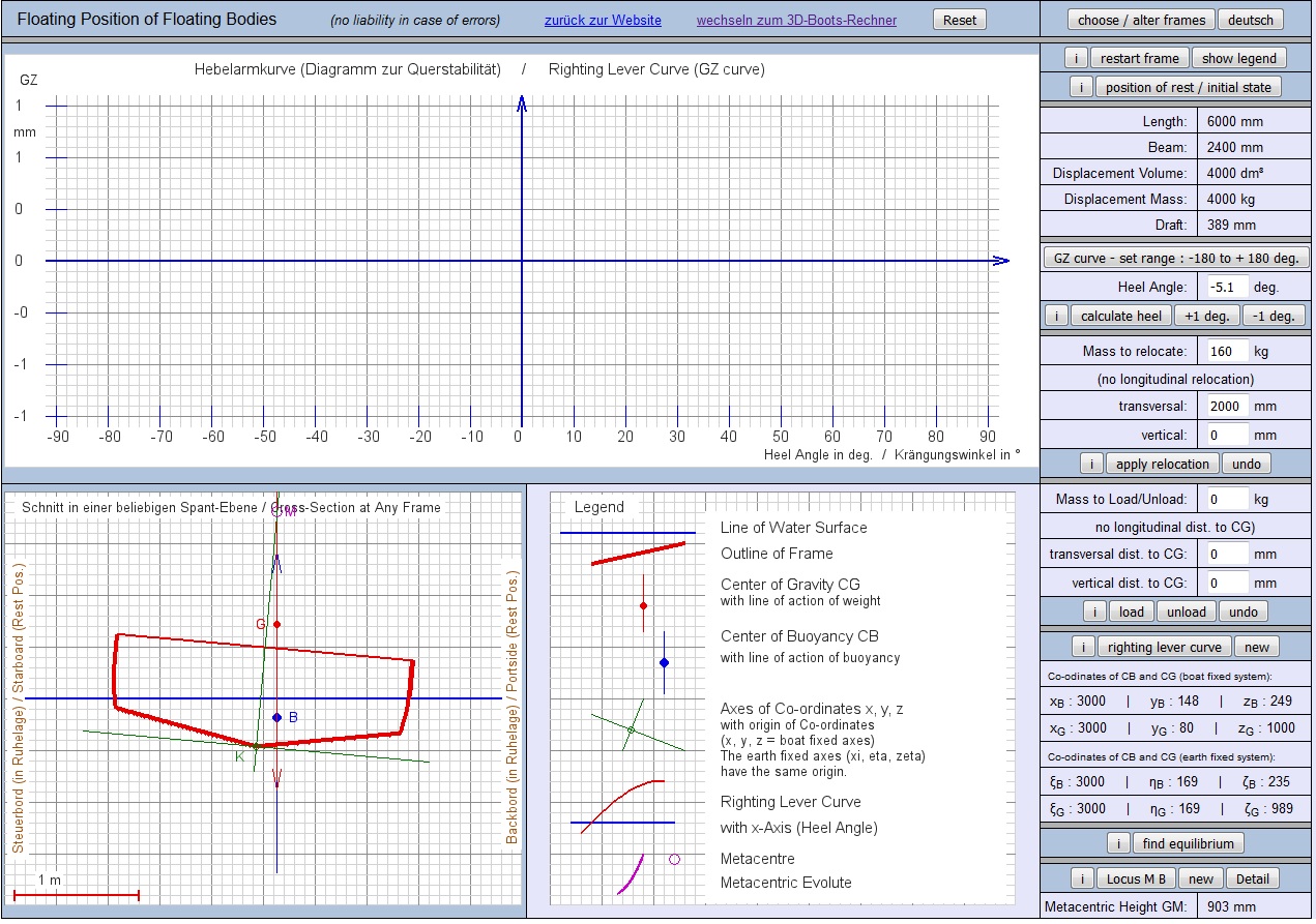

    If you click top left pic on page "choose / alter frames" you will get the frame, Tansl suggeted. But be careful with the results because it depends very much on VCB. You should try to calculate weight and VCB it first, which is not difficult, but very labourious.
    Hints to play with the choosen frame: input only in the right column (use "i" buttons for information)
    e. g.: input box "mass to load / unload" input 310, then button "load" : displacement and draft increase a bit (4310 kg disp, were causing 500 mm draft on your first frame).
    input box "mass to relocate" input 160, input box "transversal" input 2000, then button "apply relocation" : shift of the CoG (marked "G"); then button "find equilibrium" : computer heels the boat to achieve equilibrium.

    Thanks again Hiem although I admit I am lost with that site, I clicked all the information button's placed in rough value's or estimations and I've no idea what im looking at with the results from it..... I'm sure there is crucial information there that would be invaluable but im not sure how to interpret it.
    So far it seem's I've two options to go with before continuing any construction, the original design and the more flat bottomed or shallow V from sam's and tansl's suggestions. Is there a way to find the advantages or disadvantages of each?
