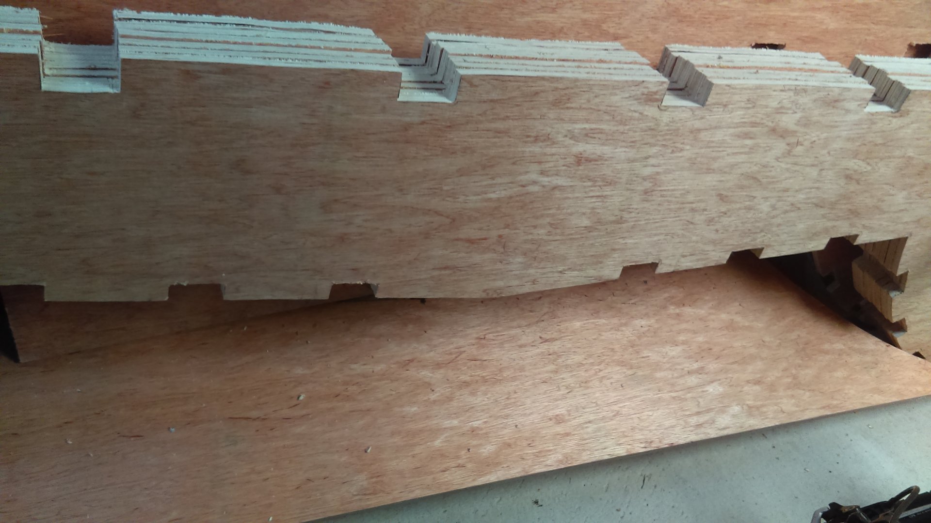

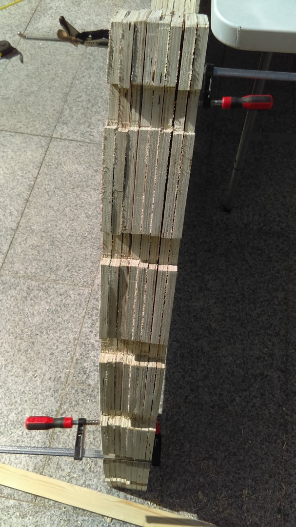

    It seems I missed the last few comments on page 2 of the thread, as such here is the answers to those comments.
    The project is currently at this point (pictures below) and yes I looked at similar canal boats and am aware that my design is different than most standard canal designs although those boats are also a different construction method and completely different sizes to what I'm trying to achieve. Mainly steel hull and far longer than I would require. This combined led me to the design that I have shown.
    Yes it is no where near what canal boats in the area are like but none of those are wood and fibre construction either. the fact is I'd rather not build with steel (Lack of tools for such a construction) and really wouldn't need the 40 ft length most canal boats in the area have. I could have went with the flat bottom design or U and probably would have better displacement which Tansl had hinted at originally asking would I consider a mono hull.
    My original question was in regards to displacement and bow shape, construction had started because I was happy with the design for the main hull, my concern was I was not sure if it would be sufficient displacement.
    I still have everything that came off the ply wood and could join back the ends (although it would not be as strong anymore) making it a flat bottom but then i'd come to the issue of designing a swim at the stern for the new bottom.
    I understand that a lot of what I have found has proven to be wrong, and I will keep your concerns in mind, SamSam if you have suggestions to improve the current state of my construction I'll definitely give it a think over any suggestions are welcome, as you said generally with cloth it's 50/50 so I'll take that as what I need in weight ratio for the cloth, do you have any estimation for how much epoxy would be need for a single coat of epoxy without cloth?
    I've added some more photo's below, the cuttoffs are under the main cut piece's at the moment.
    Maybe I am a little insane for starting construction, although as I have said already that I am happy with the design, is it optimal? Probably not

    A flat bottomed scow hull seems to be the most practical shape for a displacement canal boat. Easy to build, it gives the most volume with a lower center of gravity. It gives the most static stability. I bet it would only have half the draft of what you are doing. As far as dynamic stability I can't see where much is needed in a canal. You could haul it around on any flatbed trailer as opposed to a custom built one suitable for only one purpose. You probably won't be able to get very much usable space in those v shaped pontoon sections.
    About the op, the bow needs work. It's too blunt and I've no idea how you would bring it all together with the deeper catamarans and raised v hull between them, and waves will pound against it I imagine.

    Thanks for the input Sam :) yes tansl answered about the displacement initially and then Heimfield elaborated on it, I believe I could flatten the bottom although then I may have to bring the floor level of the home further into the extended hull, I am wondering if it is really worth the work involved I understand the transport may be beneficial as well although my uncle is a boating enthusiast and has several size's of boat trailers for transport. He had originally suggested that we look for a boat that was second had with two keels to deal with the chop on the Shannon.
    My main worry is that changing the hull shape at this stage may end up with a sub par structure in terms of strength since the pieces cut will have to be added on to meaning not solid pieces.
    I am quite inexperienced with boat's but I know timber well enough and right now the pieces cut are solid and all in line (only a slight variation where the jigsaw went awry )
