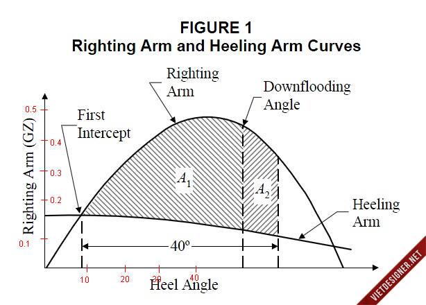

    I've calculated heeling arm curves for the open and closed version with and without a floating bag.
    I've uploaded the heeling lever curves for both hull versions, each with and without additional buoyancy on top. Shown are heeling levers [m] over heeling angle [-180 to +180 degrees].
    It can be seen that the closed boat (bottom graph) has a better stability but is still not self-righting (blue curve).
    What I'm not sure with: At 180deg the heeling lever obviously is 0 since the boat is symmetric. However, to my understanding this should be a unstable position and it should start righting itself back up. Am I misreading the graph in any way?

    Trixini:
    At 180 degree heel, the blue curve ship is in a metastable position. https://en.wikipedia.org/wiki/Metastability It is stuck in a small potential energy well. You have a small symmetric energy hump on either side of the 180 degree heel point due to the GZ crossing the zero value. You will have to supply energy to the ship to get over the hump and then righting can occur back to the more stable upright position.

    Each point GZ = 0 in a righting lever curve is stable (or metastable) if in a small interval around this point the GZ changes from negative values into positive ones (read in the direction of growing heel angles).

    The resulting heeling levers look like this:
    So the boat is obviously far from self-righting.
    Before calculating the required bag-size I would like to confirm the stability curve. What I'm not understanding: somewhere around 45 degrees heel, the inner part of the boat gets flooded since the side of the deck is underwater. To my understanding, this should result in a visible bump/change in the heeling levers curve? I'm not sure if this is an error in my stability software or if I am thinking wrong.

    Trixini:
    You didn't indicate what software you are using but if you are using Orca within Rhino, or many other programs, the lack of a hump indicates that the software is flooding that internal cockpit before it reaches the flooding angle. The cockpit forms an internal well and the software will fill it up to the waterline at any heel angle. This should be in your software manual. The walls you used to create the cockpit have surface normals pointing outward and to your software, it probably thinks it needs to be wet. Just remove the cockpit, and any other internal walls, and get a curve up to the flooding angle. Beyond the flooding angle use the curve with the cockpit.

    I don't know the abilities of your software. May be it is unable to deal with downflooding, may be you missed to set a special adjustment for this case.
    When the heel angle grows, at the downflooding angle the water will start to flow in the cockpit and that means a loss of buoyancy as you said. The draft increases and the rate of downflooding increases. This should be visible at the graph.
