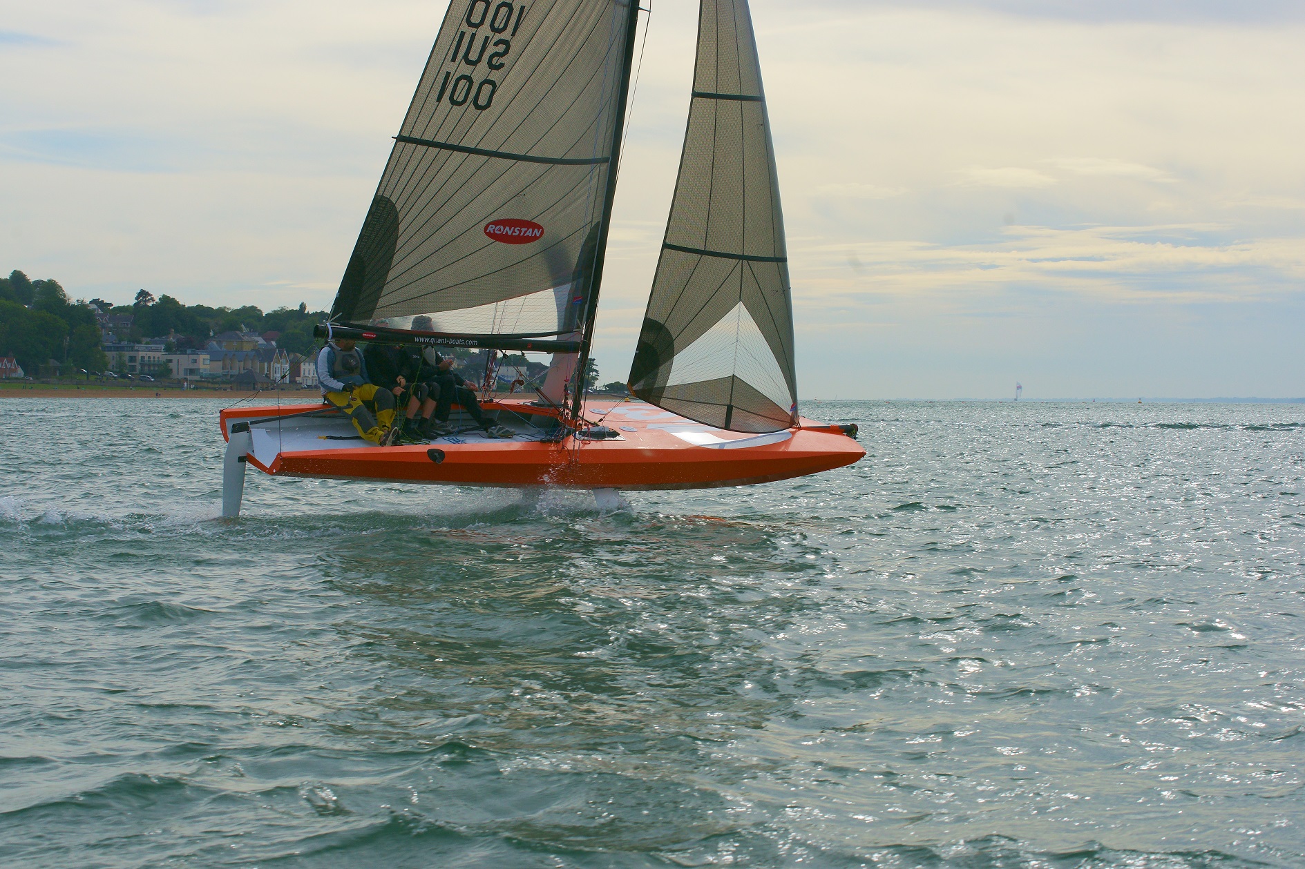

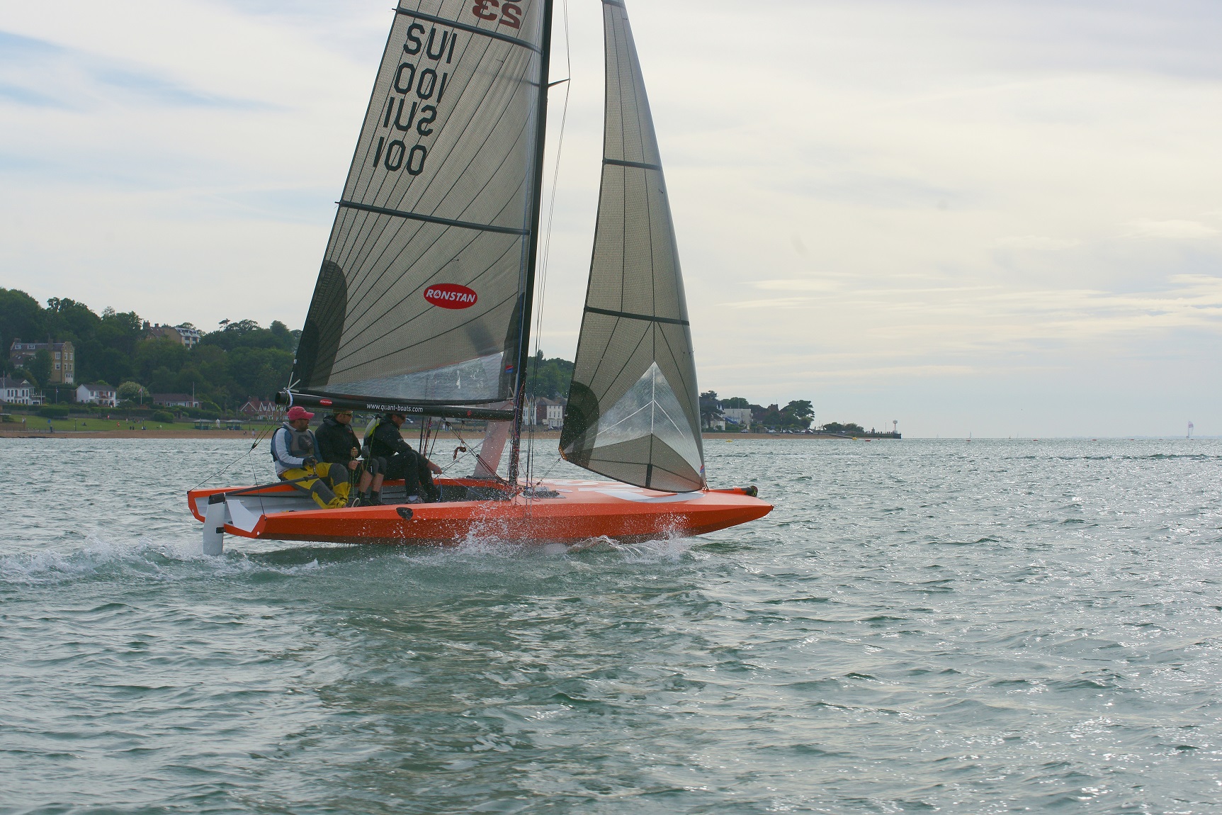

    Quant 23
    This boat is also the very first fully foiling keelboat!

    From Scuttlebutt last night:
    Designer Hugh Welbourn has spent more than 10 years developing the patented Dynamic Stability System (DSS), which comprises a retractable hydrofoil that is deployed to leeward on a yacht.
    The foil provides vertical lift to leeward, improving the yacht’s righting moment, an effect similar to having extra crew on the weather rail or a bigger keel bulb, and in turn dramatically increases performance.
    DSS foils feature on a wide range of racing yachts such as multiple Rolex Sydney Hobart winner, Wild Oats XI, to the high performance Infiniti range of racers and cruiser races to sportsboats, Minis plus all manner of craft between.
    However the very latest DSS foils not only provide righting moment, but extra vertical lift beneath the boat too.
    In its first preliminary sea trials in Cowes last week, the Quant23 has proved itself to be one of its first – if not THE first – fully foiling keel boat. The DSS foils, in combination with a T-foil rudder, has enabled the Quant23 to sail fully airborne.
    - See the rest of the article at: http://www.sailingscuttlebutt.com/2...ne Its A Flying Keelboat#sthash.8jXYNuOu.dpuf

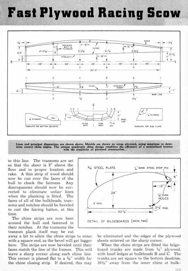

    Quant23 and Hammell's Zipper
    A bit striking to me anyway - how the hullform is so reminiscent of the scow I've been using as a prototype for my own 18' scow.
    The "Zipper" scow was developed by Dave Hammel (MIT) and Sam Rabl
    See attached

    Very interesting,Tom-thanks!
