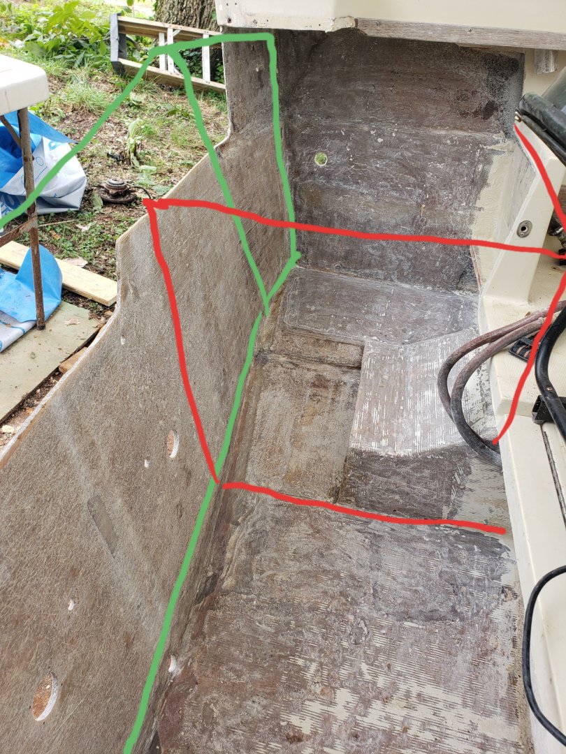

    I am hoping someone can give me some insight on the correct order to layup the fiberglass on my transom. I was okay with patching in the large cut out, but during the demo process I found another horizontal crack (low left by the bunk) and a small vertical crack caused by me being overly aggressive tearing out the rotten plywood & glass. Should repair the lower horizontal crack & vertical crack before patching in the large cutout? If I do it that way, I'm going to grind most of the glass on the vertical crack away to get the 12:1 taper needed for the cutout. Thanks for any insight you can give me!

    More experienced builders will be able to give you specific advice, but from the photo, I foresee a complete removal of most of the plywood with a router and replacement with a complete sheet of plywood epoxied into the whole transom, then heavy glass Epoxied over that.
    Just patching ragged and odd-shaped wooden sections is going to risk future integrity in my mind.

    Grind away.
    Grind that area first, you’ll be glassing over all of it anyhow, so add a little extra in the cracks first to level the surface, then glass over all of it.

    Clean up the wood, till you are at solid ground. Grind away the cracks as suggested. You will be grinding away most part anyhow, around the wood. Then glue in new wood, and glass over the whole lot, including the cracks. No need to do it in 2 steps, first the small cracks then the large part.
    Make sure every hole drilled into your new transom is properly sealed, preferably by overdrilling, filling with epoxy, then drilling the right diameter hole. This will protect the wood from water ingress. (this is what killed this transom very probably)

    Difficult to tell from the photo, but I’d be real suspicious of the plywood beyond the cutout area you show. Myself, I’d be tempted to cut it all out and start fresh.

    Is there a good reason to keep the little bit of wood that is left ? It seems that would virtually guarantee a weak core on both sides near the join to the sides of the hull. I would get that all out and have no joins in that area at all.

    Pretty much what everyone else has said. I would probably remove all the plywood but would replace it with coosa or similar rather than more plywood.

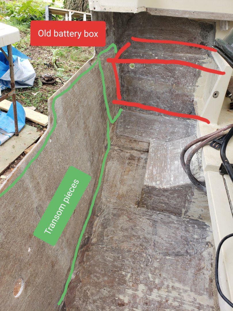

    I'm not planning to keep any of the wood. This was an "in-process" picture not the finished product. I am going to grind it down to fresh glass. The knees are in good shape & no signs of rot, so that is some good news. I was contemplating a Seacast pourable replacement, but now I am thinking Coosa might be a better alternative. I will have to cut the remaining top cap off to get it in though. My thinking is 2 thicknesses of 3/4" Coosa with layers of 1708 & poly or vinyl-ester resin between to get the total thickness of about 1 5/8". The original tansom has some type of structural foam to fill between the skin & 1 1/2" this plywood.
