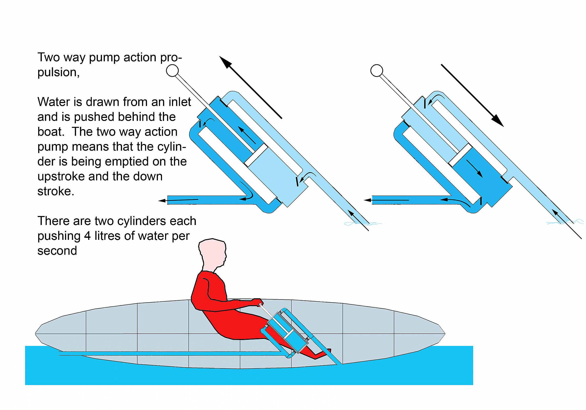

    The boat which folds in two for transporting is in itself fairly unusual and we just wanted to have an unusual propulsion system.With this in mind I remembered that I was once stranded without a paddle in a small working boat, there was some 32mm diameter pipe in the boat and I used it to blow myself to the side by immersing the tube in the water at the back of the boat and just blowing. I was surprised how quickly the momentum built up. Having said all it looks like we would be better pumping water.

    I think the put put also sucks in water as some steam condenses, and then jets the water back out as some steam expands. Fun little toy. Light weight. Not efficient.

    As for the piston air pump, just imagine yourself pumping on a foot pump or hand pump, even a bigger one for higher flow rate and lower pressure, and think about how effective it would be. Most of the energy would be dissipated as sound and heat in all directions. There is reason why flatulent swimmers don't win gold medals.

    Back in the day these bellows were used to power organs. this must have been for a very large one...
    Maybe it could be converted for pumping water

    Thanks for all your help and advice. I agree that it is better to pump water rather than air. I have attcched a sketch showing a two way cylinder pump. All advice very welcome and appreciated
    Liam
