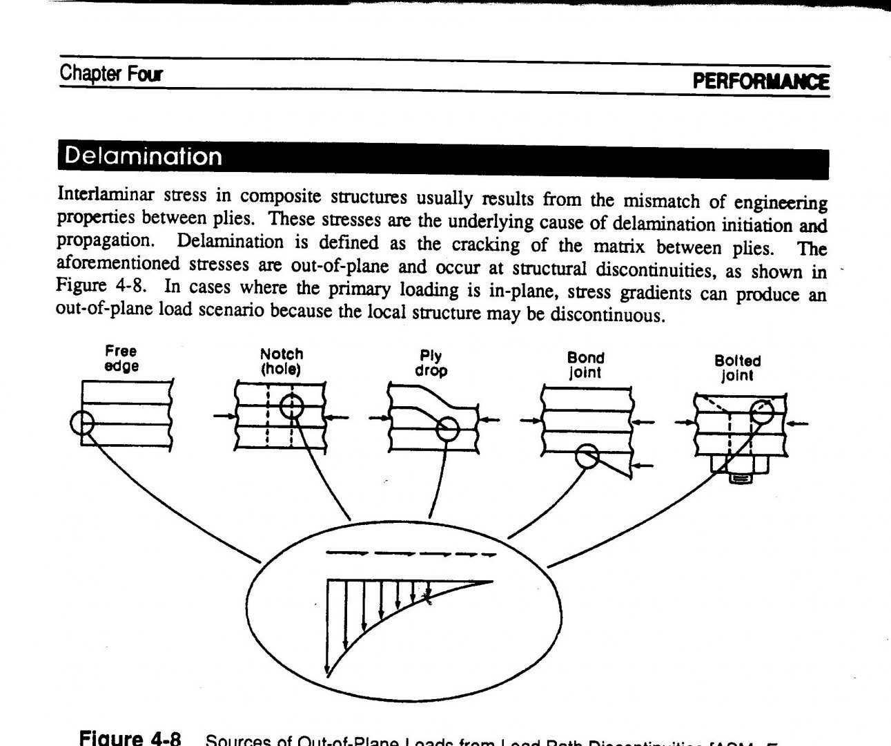

    Nowhere did the data sheet tells you that. It says high vacuum at about 50% of worktime and low vacuum if you want to start earlier. Worktime means the resin has not gelled and still workable. When it has gelled or has started to gel (pot life), then it is no longer workable. Ampreg datasheet makes sense.
    And yes, Ondarvr is correct. The numbers will be meaningless to you. Coupon testing is testing to destruction. It tells you at what point it started to yield (or crack or delaminated). The numbers only tell you if you have failed or exceeded the design criteria and the mode of failure is noted. To put it simply, the laminate has been made to perform as intended/exceeded expectations/or failed miserably.

    Delamination is at ultimate strength not yield.

    No that's incorrect.
    Delamination is just a separation or loss of a bond between layers. It typically occurs at around 10-30% of UTS...more and more delamination occurs at around 30-70% of the UTS with increasing laod.
    After which you generally get to resin cracking.

    You are mixing up terms gonzo. Those are different failure criterias and delam starts first before ultimate failure.

    Are you referring to the onset of delamination or complete
    That is for laminations with fasteners

    I consider a foam core laminate as brittle. Are you considering it as a ductile failure?
