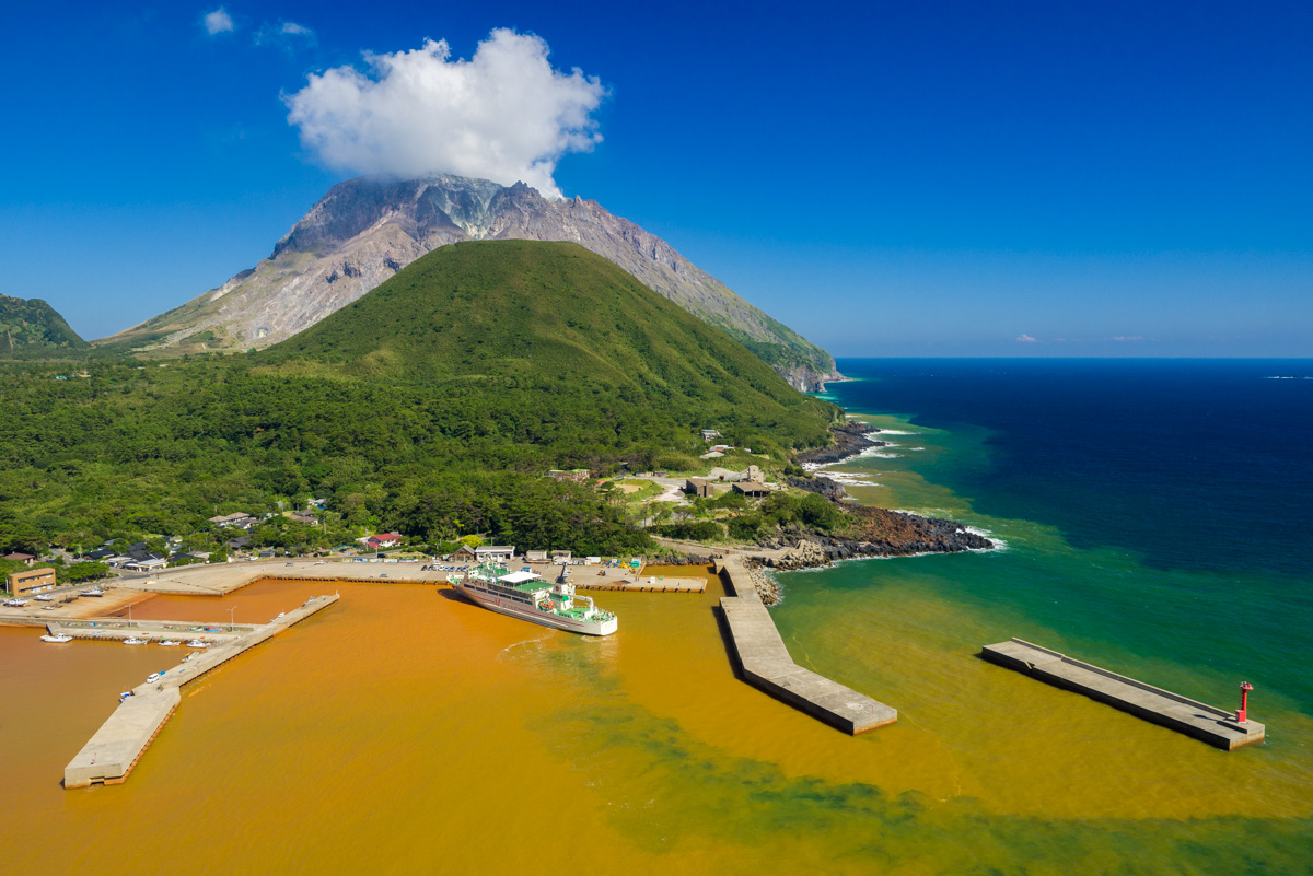

Motors are in hulls, basic straight shaft setup. All monos here are straight shaft and well over 30 years in water, i'm using one myself. Hauling out for anodes not that big of a deal in return transom is clean. Marine growth is not an issue here. I'm not sure what exactly is leaking from volcano into port, but upper layer is orange most of the time and keeps barnacles away rather well. Oxidized iron probably. This is how it looks from above. There are also no owners of outboards around here that i could talk with or even mechanics that i could get advice. So i'm still torn between two choices.
Metals in the water I'd say.
