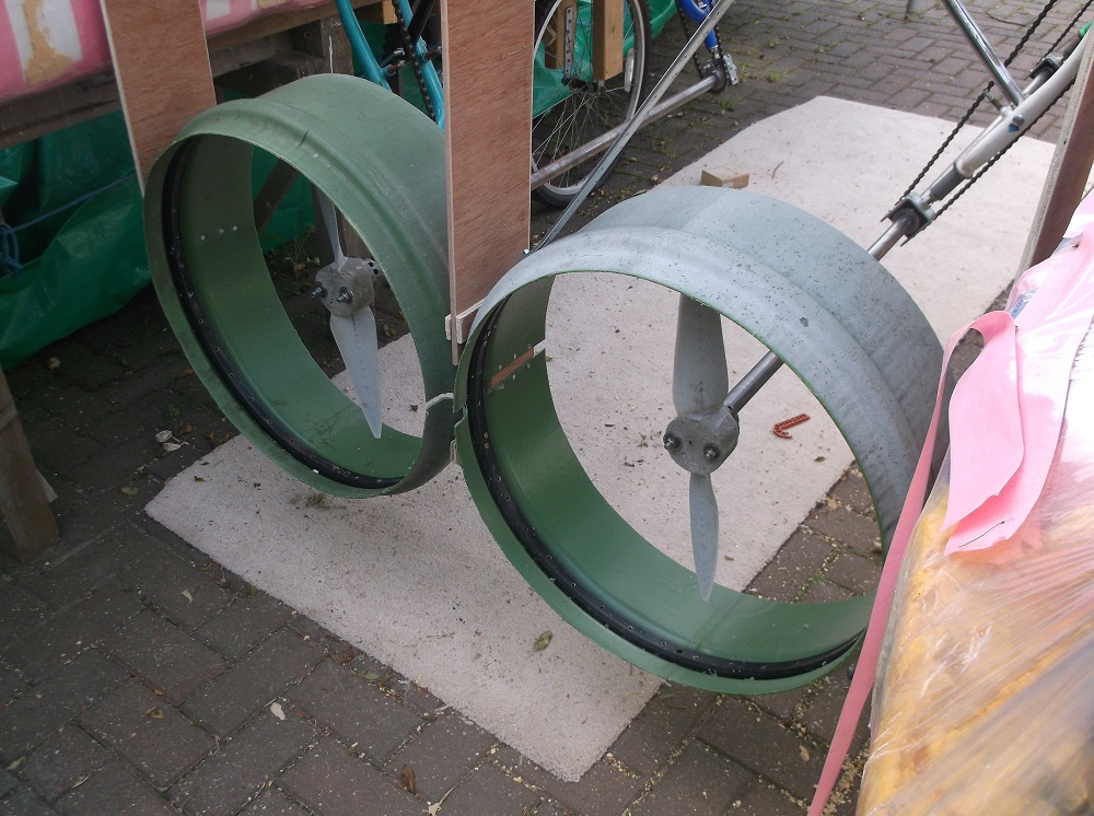

    I have almost finished a six man, pedal powered raft for for a local event in July. Unfortunately the Committee would like me to put a guard around the two propellers for safety reasons. A lot of work has gone into the propellers and I am concerned that I will lose a lot of hard won thrust. If I just surround the props in a mesh cage as the committee suggests
    Am I right, if so has anyone an alternative proposal, bearing in mind I have to keep in “Rafty” and do it on the cheap. One idea is a big cage, away from the fast flow. another Idea is to cut up short lengths of pipe and stack them honeycombe style fore and aft. I include a picture of: The Raft, The suggested cage, The two Props we will be using.
    Any thoughts on this would be greatly appreciated!

    Hi All, thanks for your ideas. I think the Kurtz nozzles would be acceptable, with a backup plan. I have restrung a badminton racket in the past, so with a ring of holes at the front and back of the nozzle I could string a coarse mesh front and back on the day if the nozzle was jugged insufficient. It will be big, the Props are 500 mm tip to tip but I have a lot of bike wheels left over and I might be able to do something with the rims.
    Q. How much does the raft weigh? A. 650kg all up. 4 Pedalling, 1 Paddling / steering, 1 repelling borders.
    Q. What Speed? A. Its theoretical but between 3 and 4 mph (1.5 m/s). I will post actual after event in July.
    Q. RPM? A. 600 rpm with a cadence of 70. Hoping to get 300 Watts into each prop.
    A Tapered Kurtz nozzles was mentioned. Getting techy now, but is it important that it is tapered and if so which way?

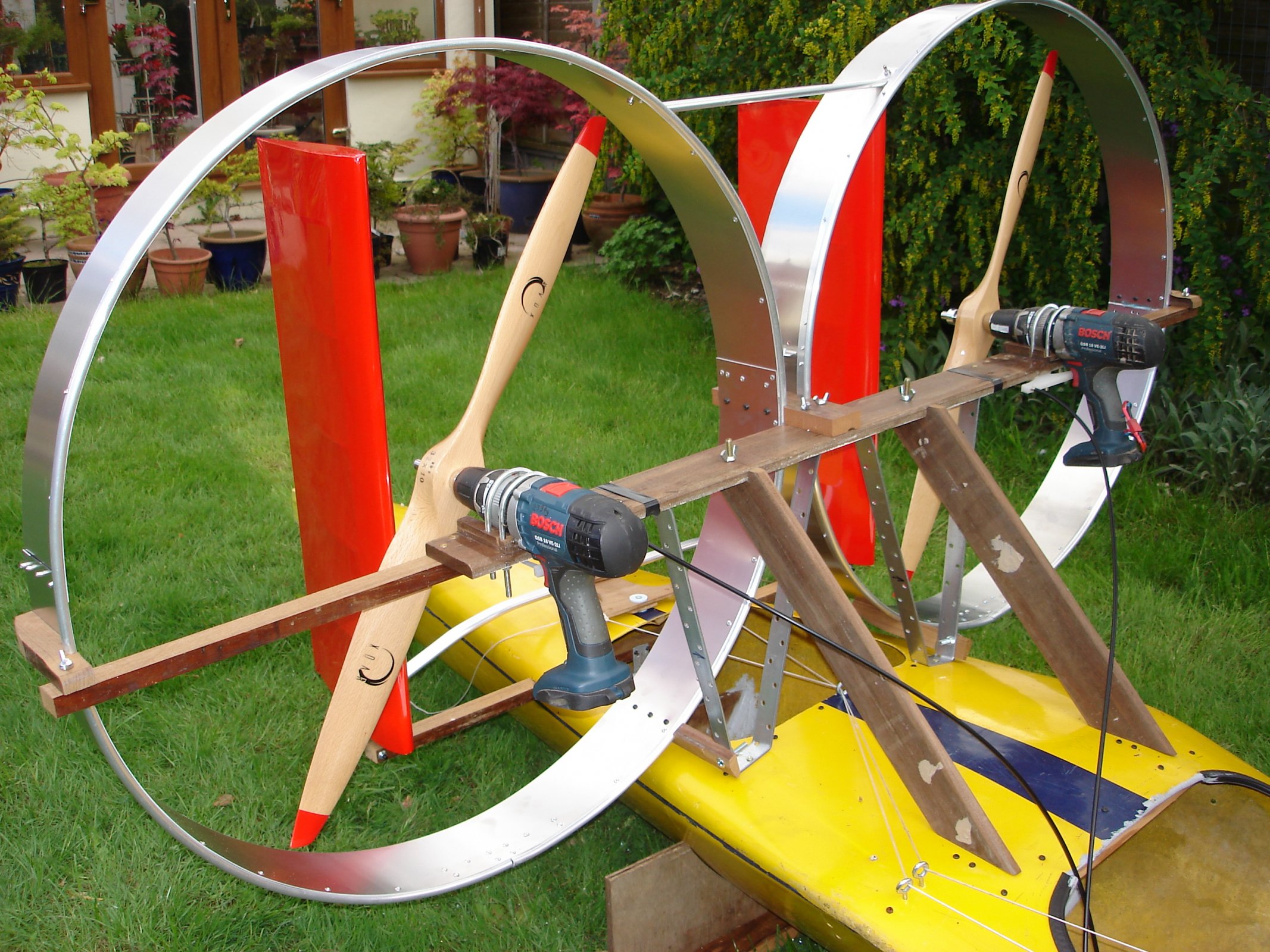

    I made these shrouds for 32" props (in air not water) for the same reason: safety of others. They are not really ducts, they do not influence the flow much, just a physical barrier. I used a ali. extrusion riveted to the leading edge of parallel shroud. At the size you want you could leave off the leading edge extrusion for hopefully less drag. The mounting hardware could be strips of the same ali. sheet.
    Are the organisers going to require the rowers to guard their oars??

    Thanks again all for your comments, I am working on the shrouds using two bike wheel rims per shroud and I will post the result in time. It will be difficult to get a decent profile, but I have some ideas. Mounting them is a problem and Alan Craig's solution looks well worth copying, inverted of course.

    My team and I completed the race two days ago. We came third in our heat, we were the fasted by far but not in a straight line, we strayed into weed and had to finish the second half dragging weed chocked props using the backup paddles. The good news is the prop guards offered negligible resistance. We found that out a month ago when we did some tests in a weed free lake. That was at a speed of 3.1 mph. They are made of bike wheel rims and a leaking water but.
    The props by the way are designed using JavaProp and constructed from layers of paper soaked in epoxy resin. I have written a JavaScript that takes the output from JavaProp and prints out templates for the blade layers and a former to build the layers up on. If anyone wants a copy I can forward it on.
