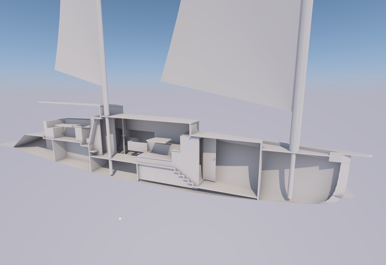

    Hi
    Just wanted to share some of my thoughts about "the perfect" liveabroad sailboat. I've been toying with the idea of building one some day. As an arhitect, it also interests me to go a little deeper in to design solutions of boats.
    I´ll attach a few preliminary images of the design. Don't judge them immediately, they're quite square for now just to keep the editing more simple. I must admit: it's not easy to get into measurements in the boatworld! They're so different from buildings...
    I'm definetly not boat engineer so I will eventually need help with all the technical aspects; hull shape, keel, ballast, rigging, weight distribution etc. I suppose there could be a change to make this design as Creative Commons-thing? My goal is to design this to be built as easy as possible and make as many things as possible with CNC router. Material would be cold molded wood epoxy. So if there are others interested of this kind of thing, we definetly should co-operate!
    But here is some of the principles and thoughts about it. Take a look and consider commenting! Influences are mainly from: Moody 54DS, Garcia Exploration, Amel.
    Hull:
    • 45 to 50 feet. (LWL) big enough to liveabroad in comfort but handleable single handed.
    • Modernish but more comfort than performance shape
    • Beam ~4 to 4,5 meters
    • Semi-long keel, maybe bilge keels to allow shallow water sailing (Scandinavian archipelago is challenge…)
    • Single rudder with strong skeg
    • Modern - even ultra modern look all around detailing.
    Deck:
    • Deck saloon: 360 view from inside if possible
    • Large, nice living area with great views
    • Only couple of steps from cockpit to saloon
    • Single, well sheltered steering wheel (Amel-like)
    • shelteder cockpit with full standing height.
    • Fixed bimini structure (Moody DS-like)
    • Clean, clutter-free look.
    • High footrail and fixed RST-rails
    • Dighy-garage behind
    • Large flat areas for installing solar panels
Rig:
    • Kat Ketch rigging
    • Two rotating free standing wingmasts
    • Roller booms
    • Full battened sails
    • Light wind gennaker or maybe additional staysail (or little overrgged for decent performance in light winds)
    Interior:
    • Large deck saloon with galley and living/working area.
    • Single composting toilet, separate spacious shower
    • 2 to 3 small cabins, working/music space at bow.
    • 5-6 berths + saloon
    • Alot of storage
    • Engine and other ”dirty” things fully separate from interior to keep smells and heat away. (Amel-like engine compartment under the cockpit)
    • Well insulated from cold and condensation in Nordic environment (as well as heat in tropics)
Techical principles:
    • Easy to maintenance; simple solutions, easy access to everything.
    • Solar collector for hot water (if needed…)
    • Solar panels for electric
    • 360° Electric saildrive propulsion and alot of batteries
    • Diesel Generator for charging and motorsailing if neccessary
    • Bow thruster
    • Fixed, clutter-free windvane installation
    EDIT:
    See images attached

    That is quite a list of stuff. Enough stuff that I am confident that that boat has never been designed, let alone built. Enough that it is questionable whether it will fit and work as intended in the boat described. Enough that is would almost certainly be cheaper building a bigger boat than doing the custom work to fit it so tight.
    Inevitably this thread will degrade into naysayers questioning how serious you are about any of these features, and how likely you are to put any of the resources it would take. As described, it would almost certainly cost seven figures for the custom design and build, and sell used for low six figures after sailing a few years. Drop a few of the more unusual features and you could buy a fine used cruiser for the cold waters -sail half a decade, sell, and buy a great tropical cruiser -all for half the price of the design and build you describe above.
    Just for starters
    -cat ketches are fairly rare -fewer to none with raised saloons. They bring high cost starting with the design, and big difficulty accommodating the bulkhead structure to a design that already doesn't fit. The ketch rig also casts shadows all over the deck so there is no good place for solar panels -destroying your cost/usable watt hr. Making them wing masts is fairly pointless because of the low performance of the sail plan, to say nothing of the huge displacement you are describing. A conventional rig would easily fit under 64ft bridges, offer better performance, and lop years and hundreds of thousands of dollars from the project.
    Solar and electric propulsion, are not a good match for arctic cruising. They would make far more sense on a cat in the tropics. Again, when you consider how much more boat you would need just to haul batteries around and tile with panels, it's like you are the service accessory on a boat built for the power system.
    There are more difficulties and conflicts but I would like to get your reaction to the two above and throw in one more kicker. If you are serious about these two features in particular and the big bucks it will take, you should be talking to top notch NAs now. The kind who's name will bring respect and resale value, because if you don't use top notch, every dollar of equipment you stuff in your oddity will SUBTRACT from it's value. Instead of being seen as a luxury car it will be seen as a pickup pulling out of a junkyard stacked high. This may seem harsh, but don't be surprised to find that all the good advice you will get here sounds negative. If you are serious, there are top notch NAs lurking and interested in a challenging commission.

    You found the essential point for even considering this kind of project:
    Cat Ketch combined to Deck Saloon is the key. There really is no such boat available. If I wanted conventional rig, there are options. "Traditional" go-under-the-deck-thing is out of the question. If you want to cruise oceans and visit places of extreme beauty why would you live in cave...?
    I'm really interested for the Cat Ketch rig because of the simplicity and ease - and also the lack of maintenance needed for keeping it going. (no stays and all those little thingies that keep them up.) I'm not sure what do you mean about the performance side. I have been taught that the performance of Cat Ketch is quite comparable or even better than conventional rig - especially downwind and especially with the ability to turn booms forward.
    But yes, those masts are no doubt the expensive part - maybe 20-30K€ each I've been told. Hull could be possible done with 30-40K€ I would imagine. And then all the other stuff. There is example in Finland of project that ~40ft boat is completed with 70K€ and 5 years of work.
    Another thing is that if this is going to be existent some day, it will be strictly DIY-project. If I could afford it to be made, the forum to ask something about it would be quite different... ;)
    Beyond that Cat Ketch-rig, I think there would be nothing "special" about this. Just a little rare combination of familiar things. And the technical side is thought to be as simple as possible. In ten years battery technology may be quite something else than today.
    But if someone professional wants to put their time in this kind of project, It would be my pleasure to co-operate as designer as boat design interests me greatly. This could be made even commercial project or as Creative Commons available for everyone to tweak with. (imagine you could download CNC-files for boat and just make the parts yourself...)

    The ketch rig just doesn't demonstrate value to me aerodynamically. The mizzen is too far back to have beneficial interaction with the main (like jibs do). Without rigging you need heavy bulkheads to carry forces to the hull, and a heavier hull to carry the torque to the keel. The Pilot house just makes the hull that much more difficult -> making a torque member from a half circle vs a full tube with limited windows breaking structure. Then there is the traveler, which will carry substantial force because you can't vang a roller boom and must be located at the end of the boom. One of the benefits of free standing rigs is the roach you can carry without stay interference. But that roach exerts strong leverage lifting the boom. I like roller booms but you need to be at the end of the boom and on the halyard -I suspect that is a problem that will force you out of the cockpit to precarious places in bad weather -twice. Ketch rigs were a big benefit to balance back in the days of full keels with a rudder hung from the end. With modern keel rudder setups there is no significant efficiency gain for that balance. Two smaller sails are no longer easier to handle than one -they are harder.
    My strong preference would be a cutter with a big masthead geny that I would pole out down wind cruising. Go to the bottom of the page on the link I sent. The last pic is a beautiful big pilothouse cruiser. Scale that down to fit what you want and spend 10% of the savings from eliminating the mizzen on top notch sail handling gear -> that is what I think you should do.

    I think we're not talking same kind of roller boom here. (Is furling boom the right term...?) I mean kind of boom with roller inside the boom with vang and everything. That's just because mast roller is not really option with free standing (and therefore bending) mast. Also you can have battens on sail with furling boom and have more sail area at top that way as you mentioned. One benefit for rotating mast is that the boom can be fixed at the mast so that the sail track is always on right position (which i've heard is one issue in using furling booms). Of course you have to adjust vang just right when rolling the sail in. But that's not crucial point right now... :)
    Considering traditional headsail, wouldn't that make the structure of the free standing mast to be alot harder when there comes huge forces from the headsail? With mainsail only forces are much lower at the mast end as it balances with the whole length of the mast. Or then you need those extra stays when using the headsail which makes the thing too complicated. If not, of course one mast only would be quite a lot less work...
    I'm not really sure if traditional marconi rig is more powerful if compared to cat ketch with proper design. If you think of sailing on big seas, you nearly always have reef on anyway. Benefits are obvious when sailing downwind with wing-wing-combination and mainsails pointed front; no fear of accidental jibe and self rightening if wave hits hard from back. And also less drag, more lift.
    Of course the hard part is to design the hull, keel and the sails in way that the combination is balanced and behaves well and safe. That's really the thing where I need the help if this is ever going to that point :)
    What I'm really not sure is how you should arrange the traveller for the both sails. If you think how far they will go at front, you have to have quite long main sheet rope available. By looking at images of Freedom-boats I think they don't have travelers at all. Maybe the solution could be two fixed points for main sheet with which you can adjust the boom.

    Agree about the ketch, but I have used unstayed schooner rigs and agree they do not work like a jib and main, but they do work well on all points of sail except twa ~150 when the foresail is blanketed. Any small difference upwind would be much more than offset by the ease of use of such a rig.
    Unstayed masts are not expensive compared to stayed ones. Nor are they heavier, once all the extra stuff a stayed rig requires is taken into account. They are easily built by the home builder or can be purchased. The gains come from not having to worry about, check and maintain your rig. Put your unstayed mast up and forget about it until it needs repainting or the bearings start to rattle. This and the safety gains more than make up for any cost difference.
    I disagree. The only extra bulkhead required in the drawings would be one at the foremast, which could be a ring frame. The hull will be lighter than a stayed rig as the stay and shroud loads are eliminated.
    It is not a difficult engineering job. Unidirectional reinforcing on the roof to spread the load would add virtually nothing to the all up weight.
    Agree about roller reefing and travellers. I would use a wishbone boom which is self vanging. Unstayed mast boats do not reef anywhere near as often as stayed rigs. Often it is sufficient simply to ease the sails until they are doing just the right amount of work and wait for the squall to pass. With no stays to stop the mainsail, this can be done on all points of sail. It also means passage times are higher as you can use the area required, rather than reef for the night, 'just in case'.
    Disagree. It is a little harder to hoist a fully battened main, but much easier to trim it and reduce it than it is a headsail.
    Disagree again. The joys of rolling the pole in while running downwind, getting back on course after an accidental gybe, taming a masthead genoa when the furler breaks, lowering it and hoisting a smaller headsail in a squall and just sheeting the monster in when the wind is up is not what easy cruising should be about.
