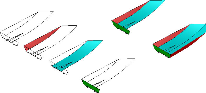

    I'd rather not make you do all that work ;). I'll work with freeship and see if I can learn it and then come back and get more info on how to use it for hydrostatics, etc. I think I found a decent tutorial online that will help me get the hard corners like in my drawing.
  10. TANSL
    Joined: Sep 2011
    Posts: 6,565
    Location: Spain
    TANSL Senior Member
    Hard corners are difficult to achieve with any modeling program. You can get them by accumulating many points and forcing the surface to adapt to them and, therefore, models produced are difficult to handle.
    Instead of looking for a single surface with those hard corners, it is preferable to construct various surfaces intersecting precisely in those corners. For example, you could use sheer and chine lines to define a surface that relies on them.

    You needed to have a transom to seal up the leak points below the waterline so that the hydrostatics could work.
    I added a transom and changed the draft in the project settings.
  15. TANSL
    Joined: Sep 2011
    Posts: 6,565
    Location: Spain
    TANSL Senior Member
    I hope this sequence of pictures to help you understand what I mean.
