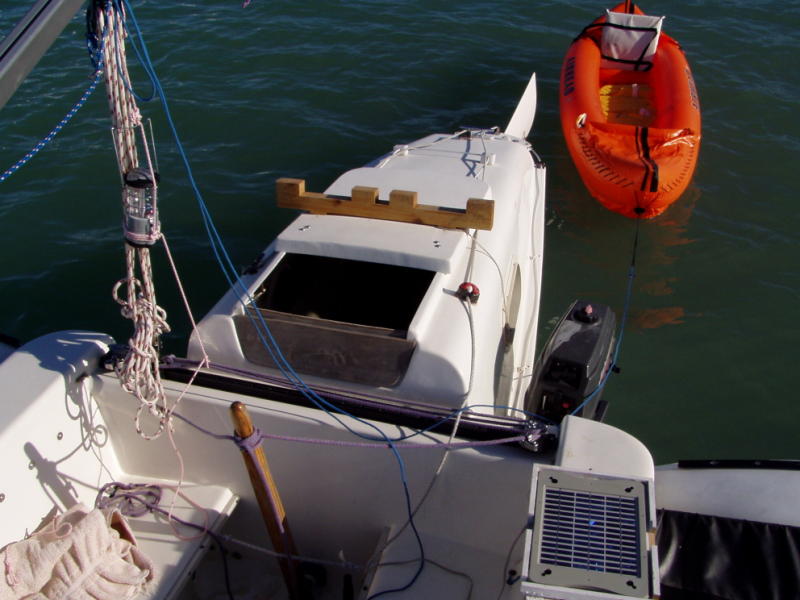

    Would a Crowther Buccaneer 24 be an option? Center hull easy to build.

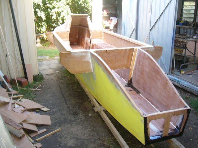

    Richard Woods are very easy to follow.

    Forgot to put a the word "plans" into the sentence

    Basil has stretched his boat. I posted this link elsewhere on this forum. A Strike 20 with Nacra 5.8 outriggers and Hobie 18 mast with running backstays, proven essential if you use a big genoa and/or screecher
    www.sailingcatamarans.com
