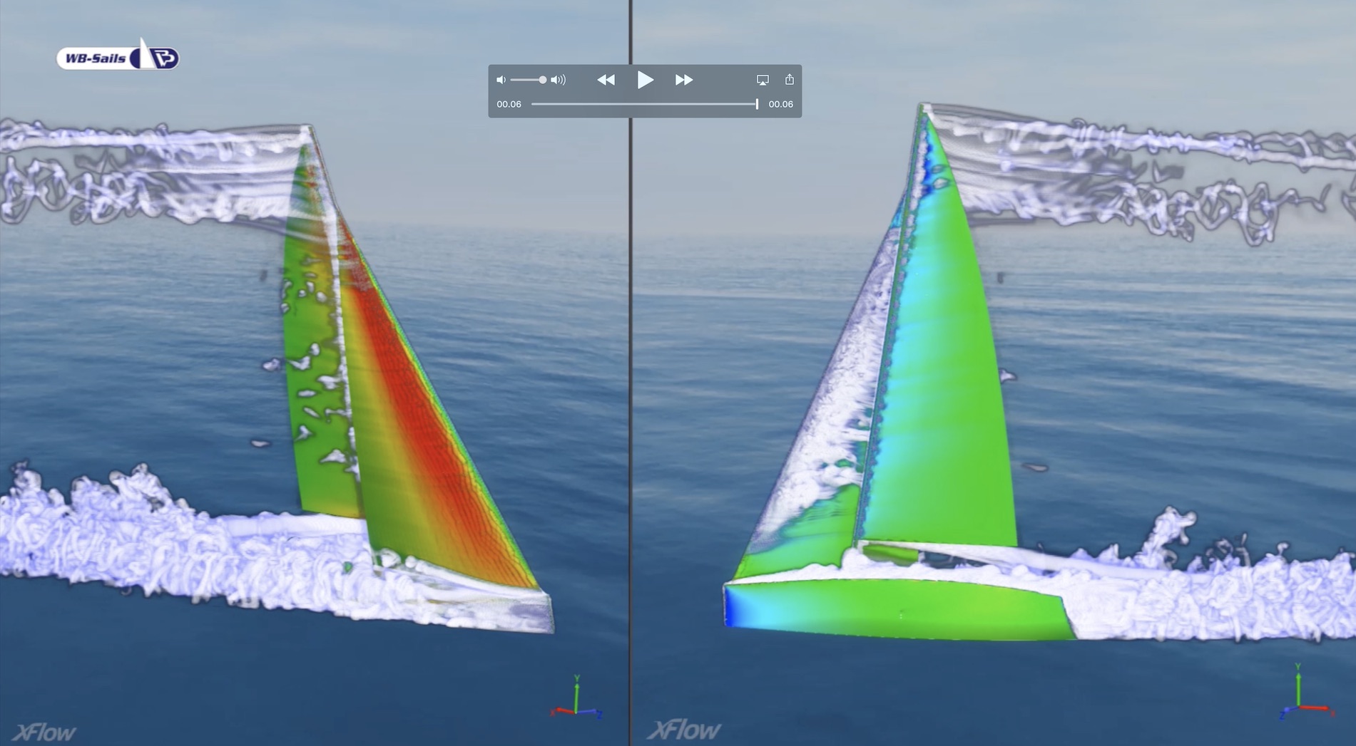

    Thank you Uli for posting Ulisail. I devised a simple template to easily visualise results. Mainsail values are in black, headsail in red.
    If I understand correctly, you use interacting lifting lines to solve effective angles of attack along the span, then insert empirical Cl values at different heights, and find the corresponding camber etc. values from that?
    You mention the edge vortices and the Lamar correction but it doesn't show at the foot of the mainsail circulation?
    I assume you are using a mirror model to allow for the effect of the hull & sea surface? At what height? In my MacSail VLM program I found the best correspondence to wind tunnel & CFD results when I set the mirror surface at about half the freeboard height of the boat. At sea surface, the lift values would be too low, and at deck level exaggerated.
    Thanks again and I will run comparisons with CFD when I find the time. Your Dehler 33, by the way, is 600 kg lighter than mine, and tippier too.

    Thank you so much Mikko for testing my program. I really appreciate that you took the time.
    This is exactly right for the mainsail. Depending on the effective angle of attack, I get the optimal camber (best lift to drag ratio) and CL from XFOIL. The optimal camber did not work for the headsail. The sheeting point on deck, the camber, and the sheeting angle depend on each other. Also, the optimal camber would result in a sail that can not be produced. Therefore, I prescribe the camber as one of the trim parameters. The sheeting angle follows from the camber, the second trim parameter is the twist. The CL-values are not at the best L/D-ratio, but the sail is more realistic. Currently, a weak point is the part of the jib, that is below the clew. The sail shape is not smooth. I am working on an improvement and will publish an update soon.
    You are too experienced to be fooled. You are absolutely right. Lamar calculates the vortex lift as a total force for the complete wing that is added to the "normal" lift force. I first tried to distribute this additional lift near the foot of the sail, but this significantly deteriorates the convergence. One could argue that the induced velocities by this vortex are already contained in the trailing vortices, and the additional lift is only produced by the shift of the vortex to the suction side of the sail. I decided to add the vortex lift as a lumped-value to the total lift force after convergence. Since the difference is only a few percent, the error might be small.
    I also made the same tests as you did. Unfortunately, I got contradicting results from wind tunnel tests and full size tests on the water. My code uses the deck level for closed hauled upwind sailing. For larger sheeting angles, I determine the amount of foot length of the sail that is beyond the foot rail. I then use this ratio to calculate an average distance from the distance to deck and water surface.
    You are right. On the sail plan from the yard it says 3.6 tons. The righting moment for 1 degr. is given with 69 kgm. The ORC-database has even 4055 kg. I will check.
    I am looking forward to your CFD-simulation!

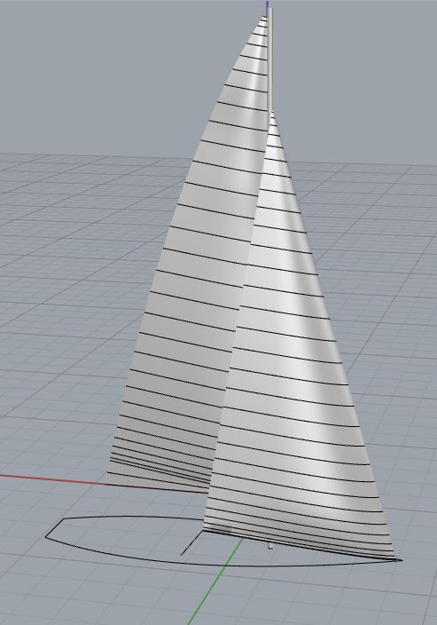

    Mikko, may be you can use the attached CAD-files. I exported the sail shapes as a point cloud and imported it into Rhino. It is the "light" Dehler 33 at TWA=40 deg. D33 TWA40.JPG

    OK, will do, I can use the IGS directly, I don't have Rhino. These are very flat.. they would not be realizable from sailcloth, due to the convex camber distribution of the mainsail - I could tell from the graphs that your model tends to produce this kind of shapes. This is a known problem for inverse design methods of sails - I recall someone (maybe Kerwin himself, or Milgram?) writing an inverse design VLM program sometimes in the 80'ies. It produced very flat sails, they even built a set for Stars but they were all too flat for real world sailing- the jib was some 6% in camber, as I recall. But it was all inviscid, your approach is on a more solid basis due to the empirical/XFoil data.
    I will still need the apparent wind speed & leeway, or true wind & boatspeed. You could perhaps add apparent wind speed into your out-file, for reference. You don't mention how your define the chord length distribution, for the headsail obviously more or less triangular, but for the mainsail?
    My standard hull model for the simulations, by the way, is your Ulilines Dehler 33, which I've then scaled to fit different boat sizes (and added a deck & coach roof) :). I have plenty of underwater with my D33 Dyna Ulilines, too, but that's another story.

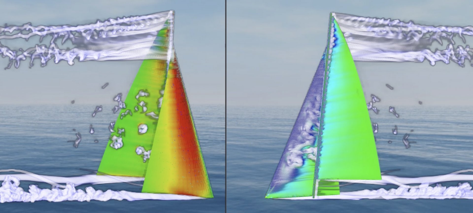

    OK, I will take a look at it. The genoa is actually OK, it was the mainsail with convex camber that would be difficult. You are right, it's the combination of camber & twist - twist is most of the time linear or very close to it, though full battens, mast bend & backwinding can make a difference.
    I did several runs already - the sails are beautiful, although at TWA 40 there would appear to be a separation vortex on the inside of the Genoa. First I ran without the hull, the added the hull, but there was little difference in the forces. I thought the sea surface at the tack of the Genoa would increase forces, but not remarkably - sails on the deck are sealed by the hull & there's a little more wind higher up.
    This is how I imagined your setup, correct? A leeway of 6, Heel 27, TWA 40 at a boatspeed 5,9 kn would give an AWA 25,4 deg in a horisontal plane at 10 m height? The wind gradient you specify appears to be very weak, normally we assume more. Which incidentally brings up that as I recall, a wind gradient/shear was a no-no in the (inviscid) lifting line theory, with the assumption of irrotational flow?

    OK. So do I in my VPP, but the general approach (like ORC) tends to be to define it relative to the direction of the motion, so they (ORC) think they can eliminate leeway from the equations that way. I can run again with your numbers, but not now, I'm in the French Alps for next week.
    Anyhow, even with my larger apparent wind angle, the genoa appears to be a bit round in the entry, with a significant separation vortex area behind the luff. The main would be perfectly at the "ideal" angle of attack. Shame you can't upload videos (?), but from the stills you can clearly distinguish foot & tip vortices. The colours are near surface velocity, the "smoke" is vorticity - legends are missing, sorry.
    Here Xflow gives without & with the hull respectively (Fz is your Fy), for AWA 25,4°
    Fx 700 N Fz 1820 N
    and with hull under the sails
    Fx 740 N Fz 1850 N
