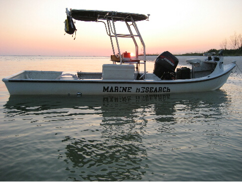

    I'm building a 30' pontoon boat for a 2000 mi. river trip. Classic design: aluminum gantry with 8' x 30' deck over four 14' long x 22" Diameter inflatable pontoons arranged in pairs. 40 HP outboard power. I'd like to place the outboard between the pontoons in the BOW of the boat for steering stability. Any info or opinions about bow drive workability?

    It should work fine as outboard power forward is common in specialty vessels like net boats. The pictures are of Florida "mullet skiffs"
    I question your motive as "steering stability" and there may very well be a noise / exhaust / vibration penalty for this installation but it should work. 99.9% of outboard powered boats are powered from the aft end and have no steering stability issues.

    If you are placing the motor in the bow for steering stability, (better tracking), it won't work. The only reason special purpose boats, like seiners, have it is to keep the propeller from snagging the nets.
