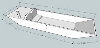

    For a first boat, simple, easy and worth building - how does this strike you ?
    Its not as big as you first wanted, but it may be so much better thought out, that it will do a lot more.
    If you needed it bigger, I bet the designer would do a scaled up version for you.
    http://www.duckworksbbs.com/plans/jim/harmonica/index.htm
    Harmonica
    Plans - $27.50
    Remember, every dollar you spend on calculations will save you 2 dollars on materials, and 2 hours on build time, and give you an extra 2 months of usability.
    or more bigger, the blue boat below
    Campjon
    Plans - $32.50
    http://www.duckworksbbs.com/plans/jim/campjon/index.htm
