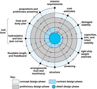

    the software used is the least relevant question.
    And as said solar+electric power+foils not going to make a feasible concept. You can create a boat that needs to stay on dock to charge for 3 weeks to drive it on foils for 20 minutes. Doesn't make sense. No I didn't do the math now but the outcome from real numbers will be miserable. This is the key compromise and dictates most other features.
    You cannot design hulls or foils in isolation of the boat as a whole thing.
    see below:
