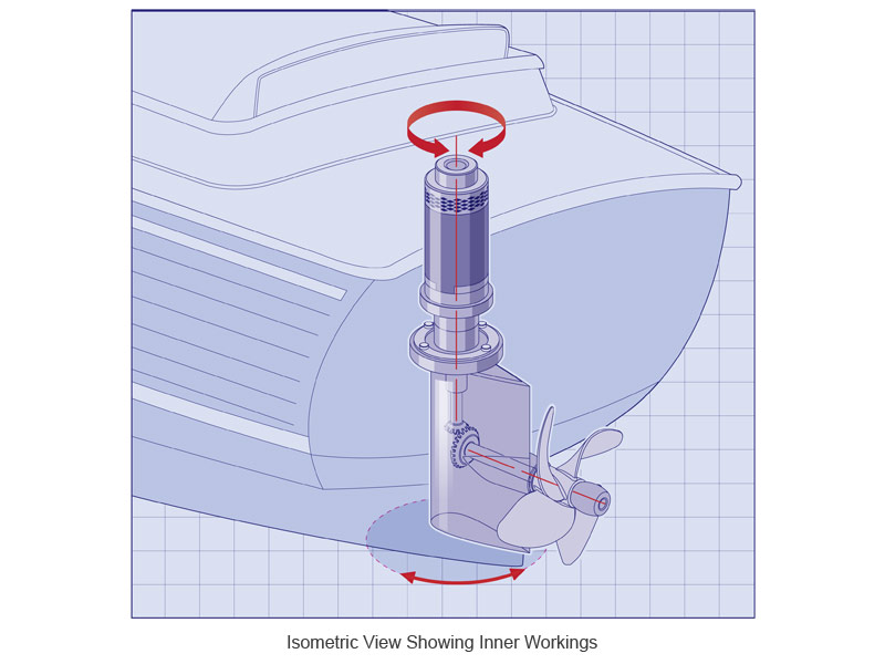

    Xellz I think first you need to decide how to mount the motors. You inboard options are shaft drive, saildrive and Z drive. Shaft and saildrive will need rudders, Z-drive not. Then you have the two outboard options, conventional and pod drive. Pod drive can be with or without rudders. Pod drive is what Bert explained, the motors are in the water. Self made is possible but complicated and limits you to long skinny motors. For all the rest any option is ok. The motors can be water- or aircooled, but they will need cooling. PM motors are lighter for the same power. Brushed or brushless, PM or conventional, is not important. What is important is that the motor has a continuous power rating in the desired range with the specified cooling. There are good ready made controllers for all motor options, that is not a problem.
