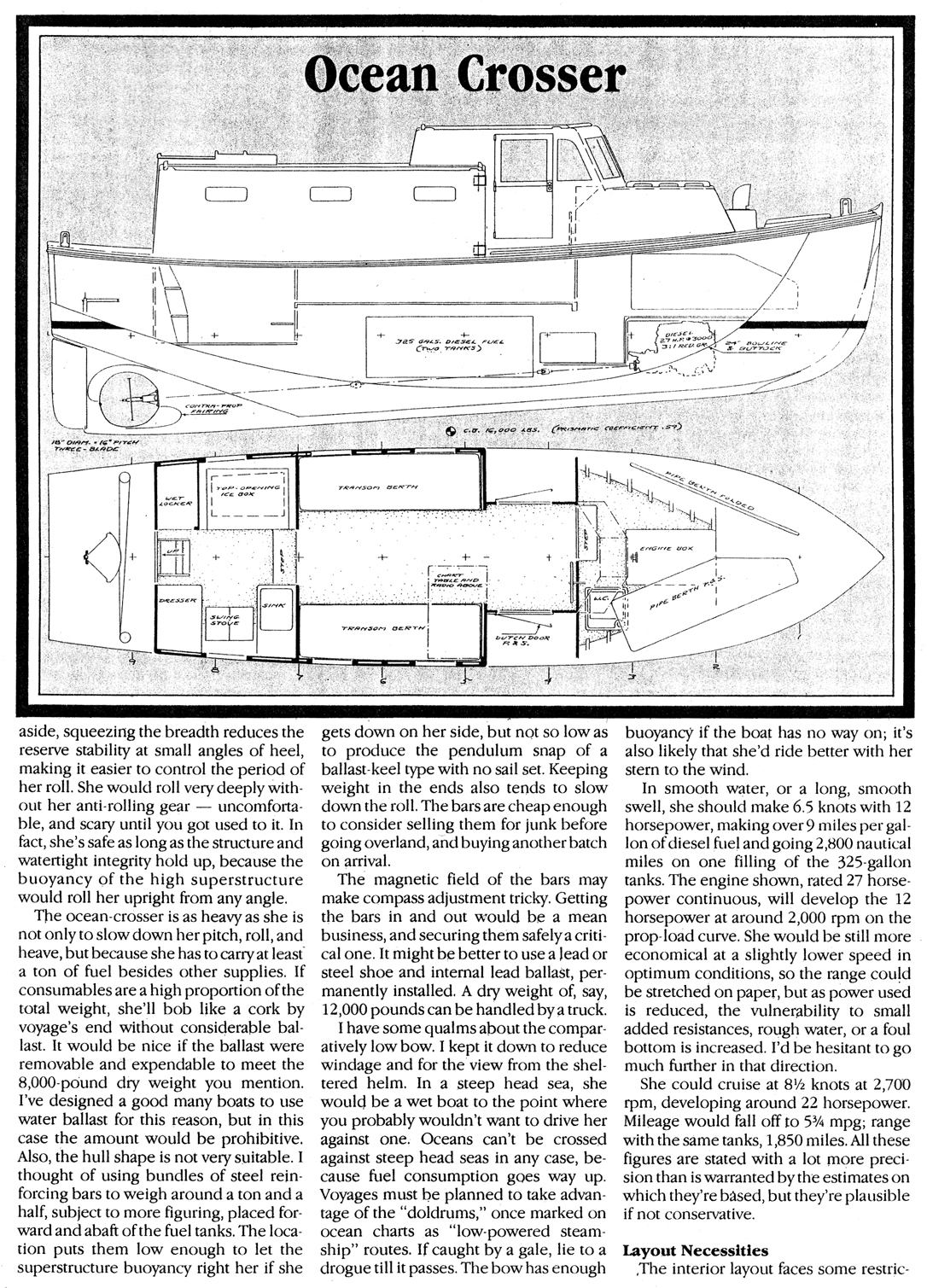

    It can be done....I have a 30' by 8' Ocean Crosser proposal from Phil Bolger. Essentially minimum accommodations wrapped around a 325 usg fuel tank with a 27HP Yanmar in the bow. Bolger states 6.5 knots at 12HP, over 9 miles per gallon or a range of about 2800 miles.
  5. u4ea32
    Joined: Nov 2005
    Posts: 416
    Likes: 14, Points: 0, Legacy Rep: 192
    Location: Los Angeles
    u4ea32 Senior Member
    The more I think about my experiences cruising (80K miles under sail, and another 80K miles under power), the more I am certain that the "Poor man’s passagemaker" is a common reality.
    Again, a visit to Panama or any other place where a lot of cruisers exposes the fact that
    1) There is no feasible minimum budget
    2) People spend what they have
    3) Simple and small is very, very much more popular that large and luxurious
    The recent crossing of the Atlantic by a 6.5m, 21 foot long single diesel powerboat proves its possible: http://www.mayrik.com/HomeEnglP214.htm
    So, again, one may insist fiercely that there is no such thing as inexpensive passagemaking, but trivially verifiable facts prove otherwise.
