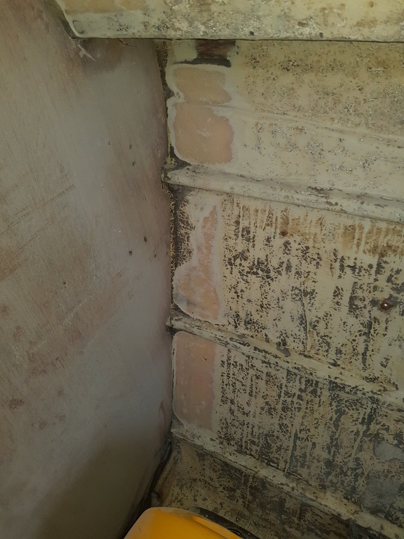

    Hi there
    I am currently looking to replace a couple of the bulkheads onboard a 31' motor cruiser. I started to sand down the inside of the hull in preparation for the tabbing, but realised instead of sanding what I thought was the flowcoat, it was actually pigmented resin, (I think) and now I have gone deeper than I probably should have. I'm just wanting some advice on the best way to repair this? I intended on using polyester for the tabs, however, could I repair this with poly? Any ideas how to best tackle the repair?

    Flowcoat is pigmented resin, with wax added. Are you saying you think the pigmented resin contained glass in it ? Unlikely, but not impossible.

    I think I’m looking at a chop finish, from the random patterns in the unsanded area.
    Can you see any fabric pattern in the deeper sanded areas?
    I can’t make any out in your photo, so maybe you haven’t sanded deep enough yet.
    Or there isn’t any fabric...

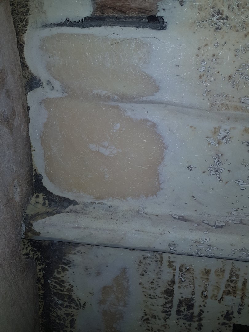

  10. Boatface

    I have checked the thickness from the surface of the 'white coating' to the amber below and it is upto 3 to 4mm in places. I can't see any roving, but I don't know if this would be obvious? The white surface certainly looks quite textured.

    One can see fibreglass mat there, is this a part of the boat that was not visible, hidden out of sight ?

    It was in a locker originally, so out of sight. However, the whole inside of the hull including the coach roof appears to have the same coating. It's very counterintuitive of me to go sanding more than a millimetre and upto 4...

    Do you have any idea how thick the hull is ?
    I seriously doubt you’re jeopardizing it’s integrity if you can’t even see the roving yet.
    It’s pretty obviously sprayed over with chop, which can easily be several mm thick.
    I’d keep grinding, maybe use a more aggressive disc?
    Is the new bulkhead intended to be structural?
    Is the hull flexing in that area?
    If not, I wouldn’t worry too much about it, a non-structural element doesn’t need to be totally married to the hull laminate, it’s just a matter of glueing it in place securely, so a clean, sound surface should suffice.

    Is it likely to be sprayed chop strand? The only reason I ask is that it was made in 1969. The underside seems to be around 8 to 10mm thick and the topsides look about 6.
    The bulkheads are roughly half way along its length and bolt to the coach roof forming the cockpit. I'm not sure if they are structural, but I intended to build back as though they are. Will polyester/vinylester adhere to this coating at all?

    Polyester is all you need for this project.
