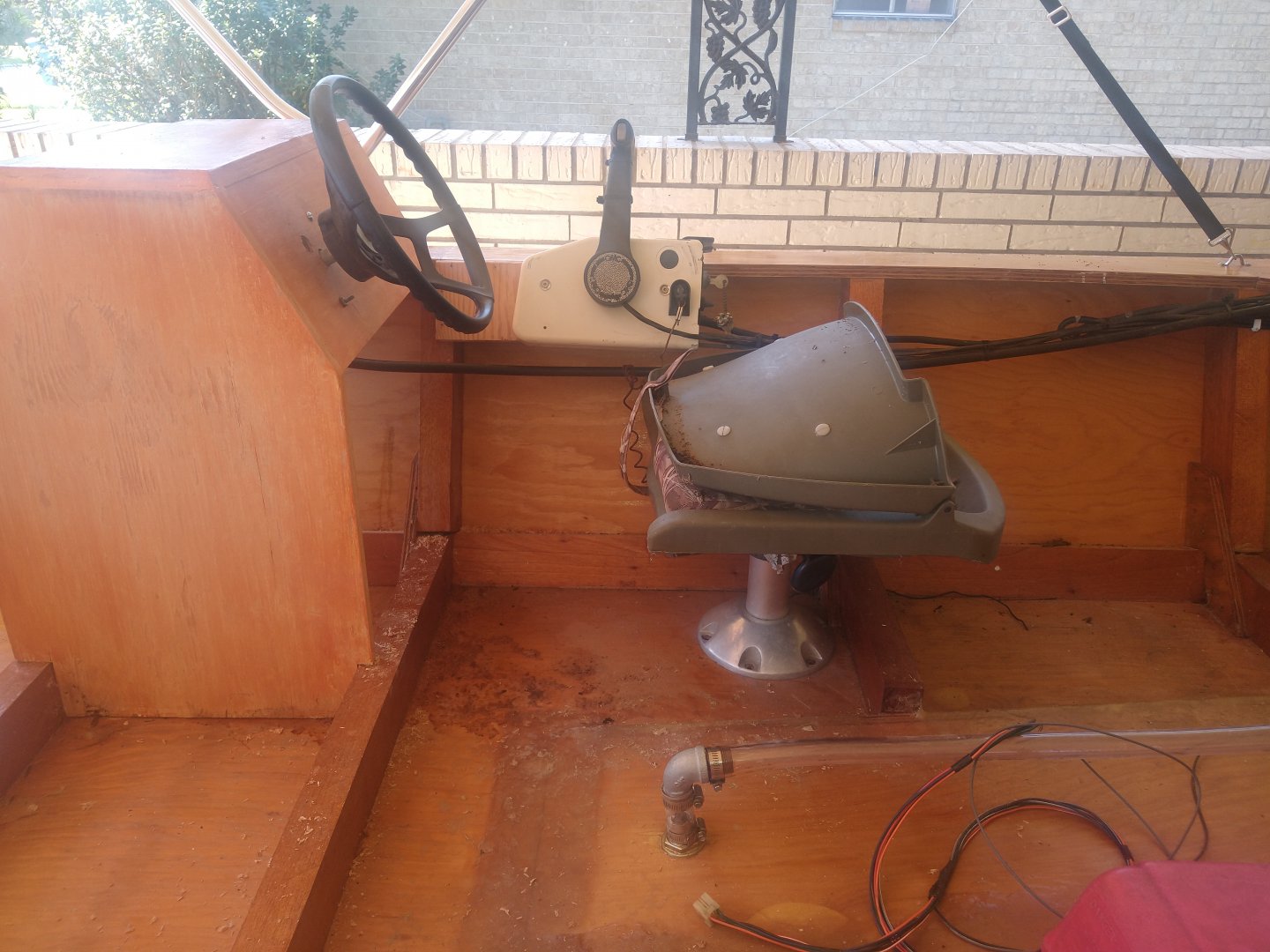

    The cheapest one I can find lol. Just kidding, I've already got the pedestal and seat. I'll take pictures tomorrow and post. The only seat that will be mounted for now is the driver's seat. I'm going to have my buddy move hisself around to find out where it runs best before the other is mounted

    Something like this hoytedow. This one isn't mounted. I will get to that point soon. I plan to mount it to a piece of 3/4" plywood that will just sit in between the ribs. That way I can move it to keep things dry. IMG_20201026_123915483.jpg IMG_20201026_123915483.jpg

    I have 2 like that. The older one cracked around the square base.
    I like the cushioned ones better but they cost a little more.

    I've enjoyed this thread. What's the purpose of the hose in the bottom of the hull?

    That is just to vent the tunnel. Tunnel hulls have a tendency to want to create a vacuum and suck the boat down. With it vented it lets the boat ride flat while still getting water to the lower unit.
