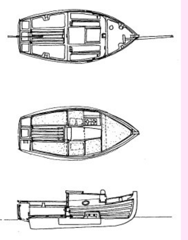

    TS-18- This is an 18 footer I designed. A friend and I built the tooling. She had room to comfortably sit up, a V berth forward and two quarter berths plus a super comfortable cockpit. 88 were produced by T-craft boats in 1975-76. She was also quite fast.....

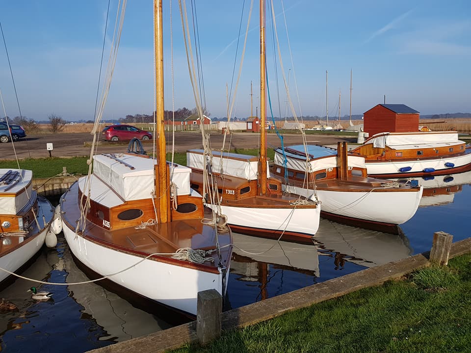

    I like these. I don't remember where I got the pic, Facebook, probably, so I can't credit it, alas. Love these little boats... This is somewhere in the UK I think.

    The little mini, whatevers may satisfy some of the requirements, but they sail like crap. It's a Dolly Parton bra thing, 5 pounds of boob in a 2 pound bra, so they never do really work well.
    As an example, the sailors directly above have a canvas poptop, which works, but makes the structure quite weak and with the top up, damn ugly IMO. The Micro 8 is about the ugliest thing I've ever seen, not to mention pretty convoluted.
    I have an 18' design that easily addresses all of your concerns, available with a choice of 4 different rigs. It has room for two full size adults in a berth below, a galley area aft of this and still has room in the cockpit, for two to lay out and get some sun. A dodger could be rigged for shade as could a boom tent, particularly on the ketch rig, where a tarp or canvas can span the two masts. It's very shoal, can take to a beach bolt upright and the centerboard is offset, so the cabin space isn't interrupted by its case. This said, This isn't the only design available for a short cruiser, there hundreds in this size range.
    Available as a ketch, sloop and as a gaffer.
