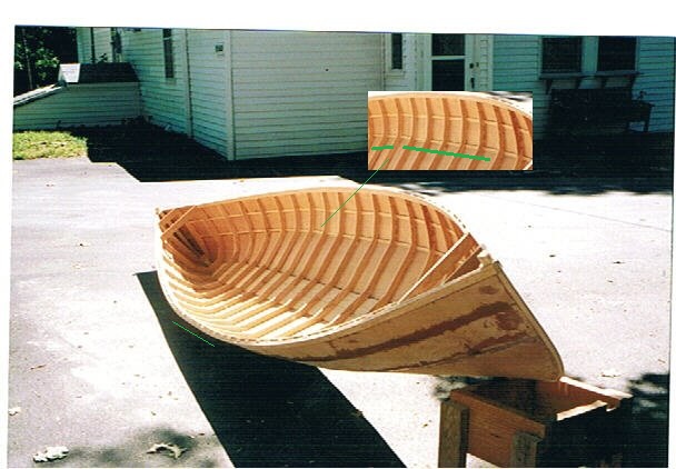

    I can assure you that any unfairness is due to the primitive building conditions and not the calculated dimensions. At that time, we were living in a farmhouse in northern NY. The length of the boat was dictated by the distance between the furnace and water heater in the basement. Hand tools only. Calculations are accurate to at least 1/32". Curves used were mathematically exact.

    With a plumb bow, it is easy to get close to a minimum radius situation in the forefoot, but a flared bow and cut-away forefoot allow plywood to be clamped into place with minimal tension. I am always looking for easy-to-build design features. A topsides transition from bow flare to stern tumblehome is low-stress with the curvature distributed along most of the hull length. I use a conic projection at the bow transitioning to a second conic projection amidships and then to a parallel projection at the stern.

    OK,. fair enough. Photos can be deceptive too. My eyes saw these things highlighted by the green lines.
