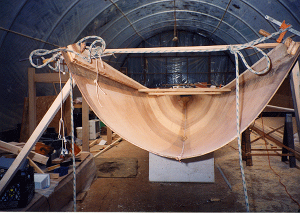

    Here is one for any of you builders who have worked with plywood construction. I am thinking of building a plywood hull and my thinking is that applying the plywood on a bias will enhance and ease its ability to be formed into a panel with some compound curve. I am talking about panels that will be roughly 4x7. Could I get some comments on this? Thanks. :)

    Building part of a Kurt Hughes a while back, I used 3 ply, 3mm plywood to make a developed surface / complex curve. It worked very well to get a catamaran hull curve.

    No, not so much.
    The ply layers are angled differently, so the grain alignments effect is almost totally negated.
    BUT - dont forget you can use a router or circular saw to cut grooves to encourage curves in a desired direction
    eg
    http://www.boatdesign.net/forums/bo...8-plywood-14-degreesees-3-12-pitch-53591.html
    These examples below are about the best you can do.

    Diagonal molding is fairly common and you can get much tight curves than shown above. I've done both power and sail with Ashcroft and double diagonal and the key is to figure out the tightest radius you'll need to bridge, then use the thickness necessary to make this radius. The width of these panels will change along the length of the hull, as the amount of curve changes. Also the angle you'll need to apply it will also change a bit too.
    I wouldn't use a 4 ply, as the veneer orientation would be odd to say the least. The only even veneer count stocks I've seen are low grade construction plywood, which generally isn't suitable for use in a hull.

    Par. How difficult is it to obtain and work with single veneers and do your own orientation, ala cold-molding? What sort of compound curves are possible?

    Veneers are easier to work with than plywood, but it's also more delicate work, especially the first layer. Curves can be much tighter, because the veneers are thin. I've found no design that couldn't be molded with veneers. As an example I did a 16' powerboat some years ago, with 1/10" veneers and the bilge turn at the transom was about a 3" radius.
    Veneers aren't hard to find, though you'll want to purchase un-backed, "live edged" fitches, for the best choices.
