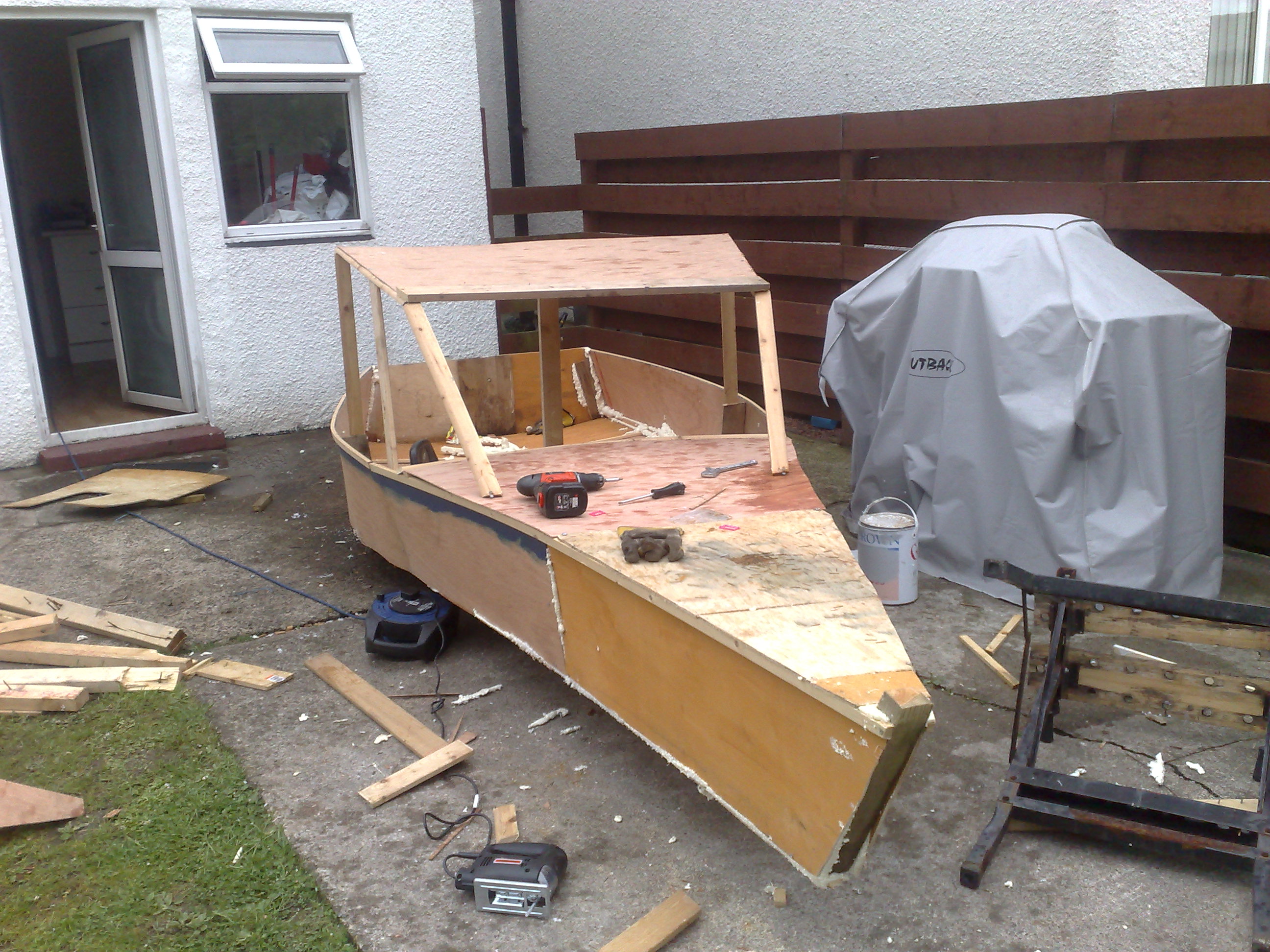

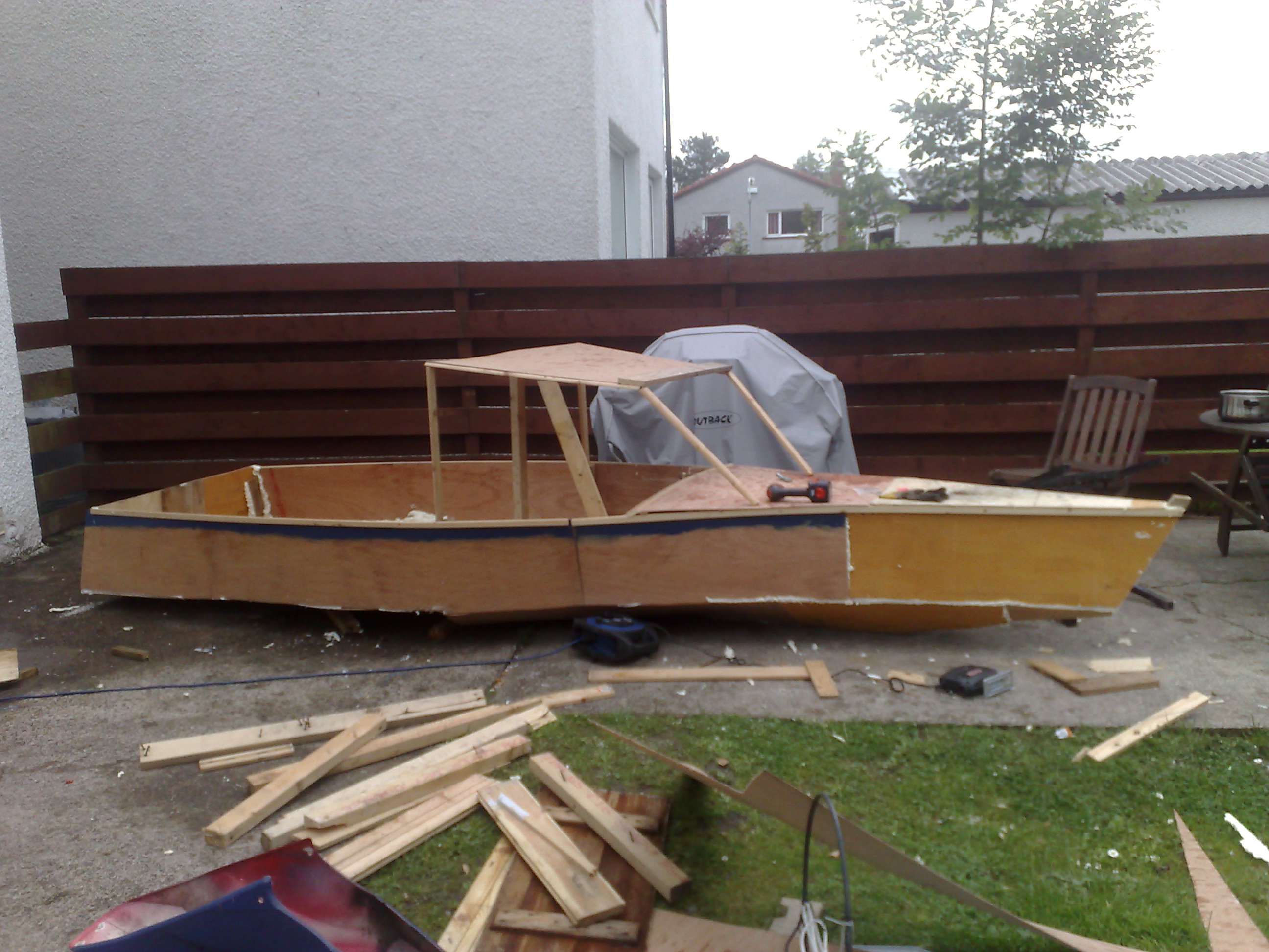

    hi, i just made a ply over glass hull,or glass over ply or whatever its called, i dont know much cos i'm only 15 but this is my 3rd boat made of ply but my first attemps at fiberglassing. iu got epoxy resin as advised by sum1 on here cos it is more flexible and doesnt crack so much, but i covered all the corners, chines and the keelson in fiberglass, everywhere where water could possibly get in is fiberglassed but ther is loads of tiny pinpoint holes. how do i get rid of them, cant afford another l;ayer of fibverglass and i dont have very much resin left., she floats but every hour or so i have to bail some water out.i was thinking of putting some sealant on the inside of the joints but i recon that would just cause water to get trapped between the fiberglass and the sealant and rot the ply. any help greatly appreciated :D

    Sounds like you might have a leak larger than a few pinholes. That's going to be tough to track down though. If you don't find the leaks and plug them the water getting into the ply will eventually rot it out.
    Have you painted the hull yet? Can you post a picture of the area you think is leaking. Coating or plugging from the inside won't help at all.
    If you have a way of thinning the epoxy and recoating the areas you think might be leaking that might help. I once read about a guy who had a similar problem. He was working on a small boat and flipped it upside down. Sealed the entire boat with plastic and used a shop vac to put a vacuum on the hull then recoated the outside with thinned epoxy. The vacuum pulled the epoxy into the pinholes and sealed them up. Sounds kinda tricky!!!

    Your problem is most likely too much dependance on epoxy coupled with too little epoxy to do the job. Now, how to fix the pinholes?
    I see no alternative besides sanding the taped seams and adding another layer of light tape. I realize this means expense, but if the boat is small, just a quart should do.
    I don't know how the chines are constructed but I'm guessing with chine logs rather than fillets over stitch and glue.
    When you're short on cash, chine logs WELL FITTED AND BEDDED with polysulfide or some good below-the-waterline sealant will keep the sea out for years. It makes no sense to depend on the sealing forgiveness of epoxy if you can't afford enough epoxy to make it work.

    If the boat is not designed to handle the stresses its joints are experiencing, it will take a lot of 'fixing' to eliminate these stresses before any pinhole filling will work reliably. I would like to get to the source of the problem, and this probably means posting pictures of your hull and describing how you constructed the joints ...
    When most people use epoxy and glass on joints they do not do it simply to waterproof the joints. The reason for using epoxy and glass on plywood joints is primarily for structural strength. -- waterproofing is a secondary effect -- and joints never leak when the plywood panels have been welded together properly with epoxy and fiberglass. This assumes the design is well engineered to avoid stresses or distribute them rather than concentrate them in the first place of course.
    Please describe the specific way you created your plywood joints, and post pictures of your boat so we can see what we're dealing with here ...

    Ooooohhhhh - now i remember!!!!! Floydrob has already posted a picture of his boat previously - just did a search.
    I am not surprised the joints leak Floyd - they are amongst the roughest joints I have seen, and unless you used several layers of cloth very well saturated with epoxy, then the fact that you dont sink is a credit to you.
    I am interested in the 'foam' you used to 'glue' the edges together. Is it what the call Balcotan of somthing like that?
    Ken gromes interest in the flxing joints might be well justified too.
    Have you applied paint yet? It will be easier to fix if not. lets know what stage you are up to.

    I just did a search and found these pictures:
    http://www.boatdesign.net/forums/attachment.php?attachmentid=23001
    http://www.boatdesign.net/forums/attachment.php?attachmentid=23002
    floydrob, if this is your boat I applaud your effort as an inexperienced teenager, but as much as I hate to hurt your feelings I'm going to tell you the truth because I think you should hear it from someone:
    You did a whole lot of things really badly on this boat, starting with the design itself and progressing to the use of inappropriate materials and really bad construction techniques. I'm not saying this to discourage you, but I think you should stick to building boats designed by professionals -- or at least experienced amateurs -- because this one is a real mess.
    Why don't you get some plans for a small and simple boat, and then build it properly -- by following the designer's plans very carefully. You have enough materials already if you take this one apart and clean up the pieces. Why not use them to build a proven design?
