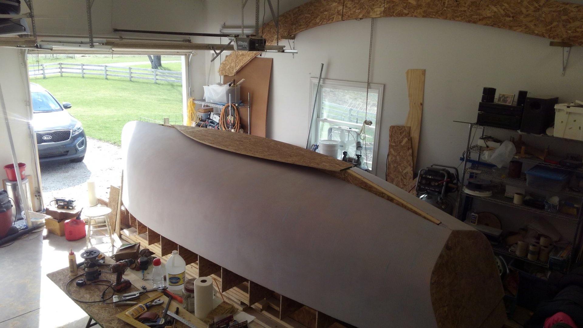

    Trying to post some pics.

    Looks like a neat project! I'm not sure if you're still having pin-hole issues, but I have found spraying (or rolling I guess) the first shot of Duratec and then sqeegeeing it over the surface will press it into the pinholes and displace the air. Just spraying will not fill all the pinholes. You've got to be quick or do it in zones because Duratec will gel in 15-20 minutes. You can go on spraying a few more rounds to build some thickness - there will be some ridges here and there from the squeegee but they will sand off quickly with 80-120 grit and then you won't be chasing them forever. Pinholes, fairness and smoothness are three different sets of challenges!
    Once you're in Duratec all your fills will be polyester putty so things will go fast. I find it takes a minimum of three spray sessions followed by finer and finder sanding to get to a polish-able surface. It's frustrating but I haven't found any shortcuts yet - let me know if you do!

    Thanks for your input Chris, the sqeegee method sounds like it will work... I will try that. Was there any particular product that seemed to work well to do the Sqeegeeing? Also, The mold is now going to have three parts, Port, starboard and transom. I think I have a fair grasp of what's necessary for the mold itself but have LOTS of questions about how to go about constructing A good cradle that splits in half on unmolding, can be easily moved and possible be rotated to facilitate ease of lay up..... And remember this IS a garage project and my budget is very limited. If anyone has such a cradle I would love to see some detailed pictures of it as I can't seem to find any. Thanks.

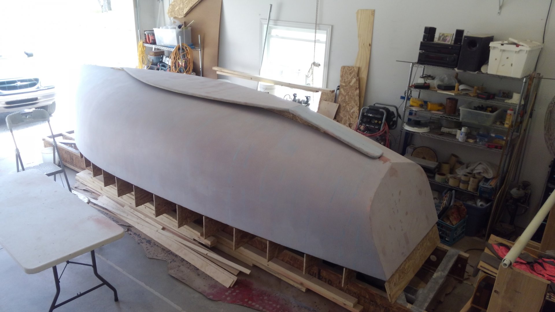

    Just a quick update. Applying the Duratec with a brush and am able to fill all the little pinholes by dragging the brush over the same spot several times. Sands to a really nice finish. Once the "pinhole coat" is sanded I will spray the next coat. Looks like I may be able to start the mold itself before the weather cools off too much to work in the garage. Thanx to all for the help and advice.

    Use a plastic squeegee (bondo spreader) to fill the pin holes, and there's no need to sand after this step, go straight to spraying.
